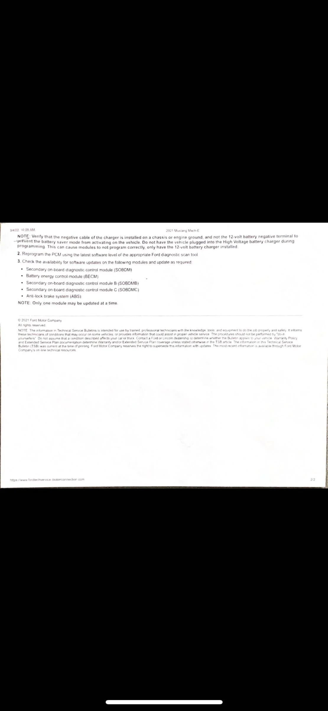

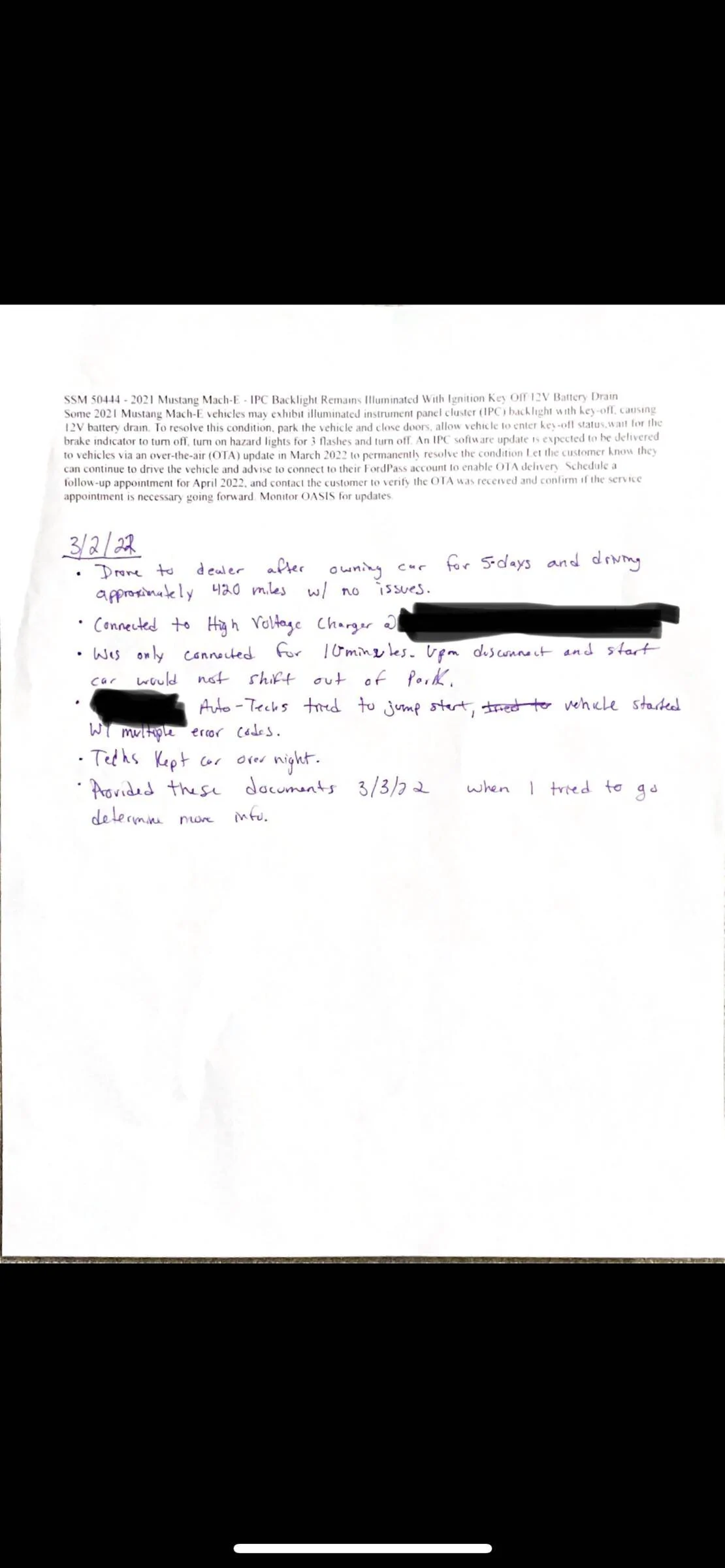

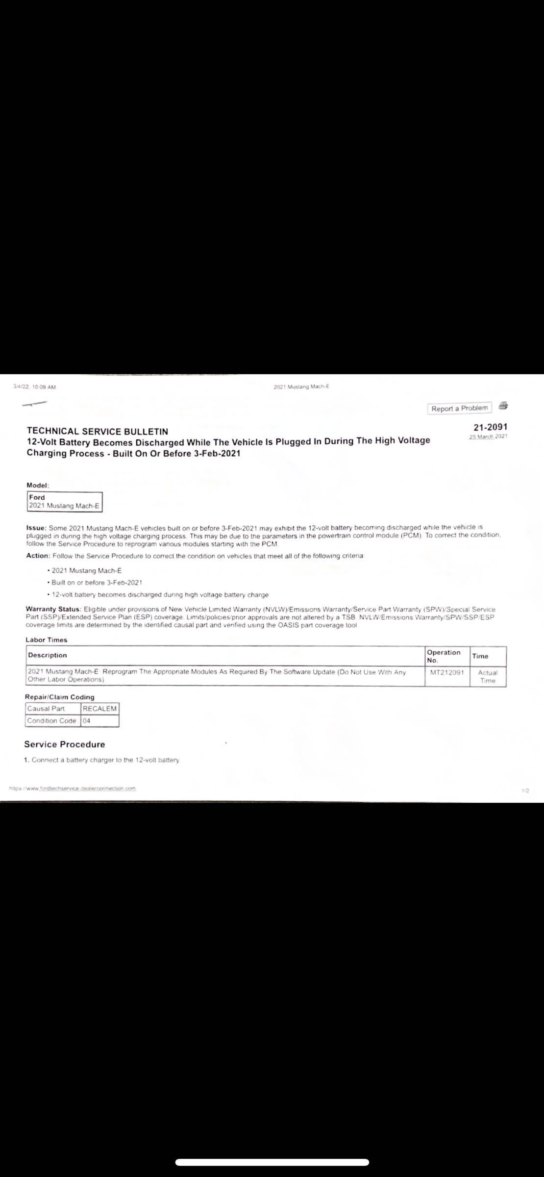

Here is what the dealer suggested to me to do if this happens again:
Ford Mustang Mach-E The beginning....I'm concerned. What to Do Next
PS They did not succeed with jumping the battery. I actually instructed them to disconnect and reconnect the battery. Only then did the car go into gear, but it still had error codes that needed to be addressed there solution was to update the module. essentially there was a software glitch that made the powertrain module discharge the high voltage battery when plugged into a high voltage charger. The update supposedly fixed the issue. Here is the additional documentation I left with:
Ford Mustang Mach-E The beginning....I'm concerned. 12vDischarge(a)
Ford Mustang Mach-E The beginning....I'm concerned. 12vDischarge(b)
"Smart Cars" just need a software update, ha! I am a bit upset that this appears to be listed as a recall, yet the FordPass app indicates no issues for me, and also does not mention this service record?
Well, no, my HVJB and BECM were toast and needed to be replaced. This wasn't a software or IPC issue. I never had the IPC not turning off issue.
