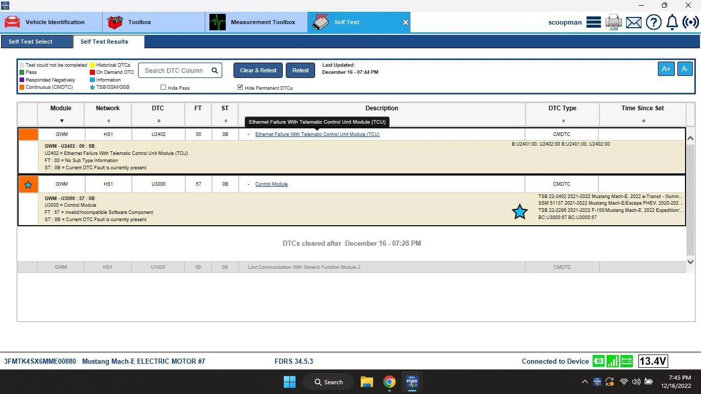

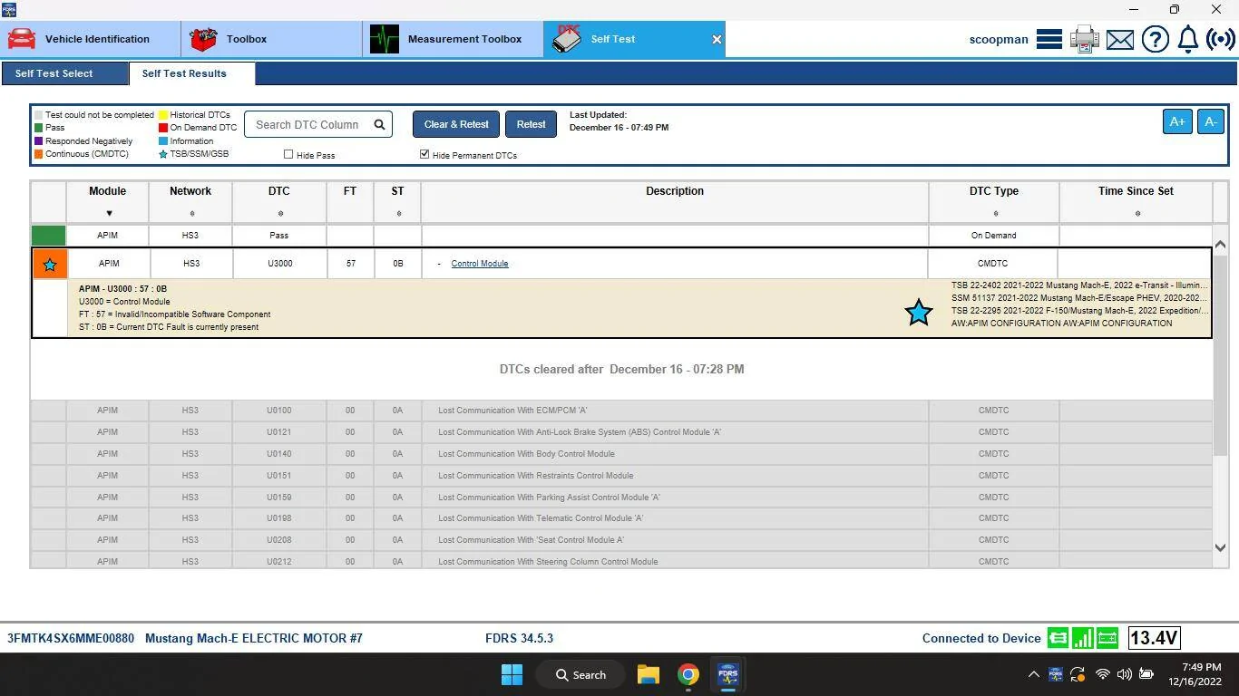

I have a problem. GWM showed available, then disappeared.
FDRS showed I had 3 updates: PCM, SOBDMC, and GWM. I selected the first one, PCM, which also downloaded the SOBDMC. These installed without any problem and FDRS said successful.
However, after that GWM update disappeared.
It now appears that GWM and APIM is showing incompatible software, and I can't figure out how to get GWM to re-download or get back into a state where it will flash the right software version.
I'm suspecting that the GWM update is a dependency but Ford didn't mark it properly.
Anyhow, anyone have ideas on how to fix whatever went wrong here? My VIN is 3FMTK4SX6MME00880 if anyone wants to look me up there and help figure this out. THANKS
Ford Mustang Mach-E The Complete DIY Guide to Updating Your Mach-E with FDRS Screenshot (57)
Ford Mustang Mach-E The Complete DIY Guide to Updating Your Mach-E with FDRS Screenshot (58)
Actually I just did some searching and it appears the PMI procedure might do what I need here. Crossing fingers and trying this on the GWM
