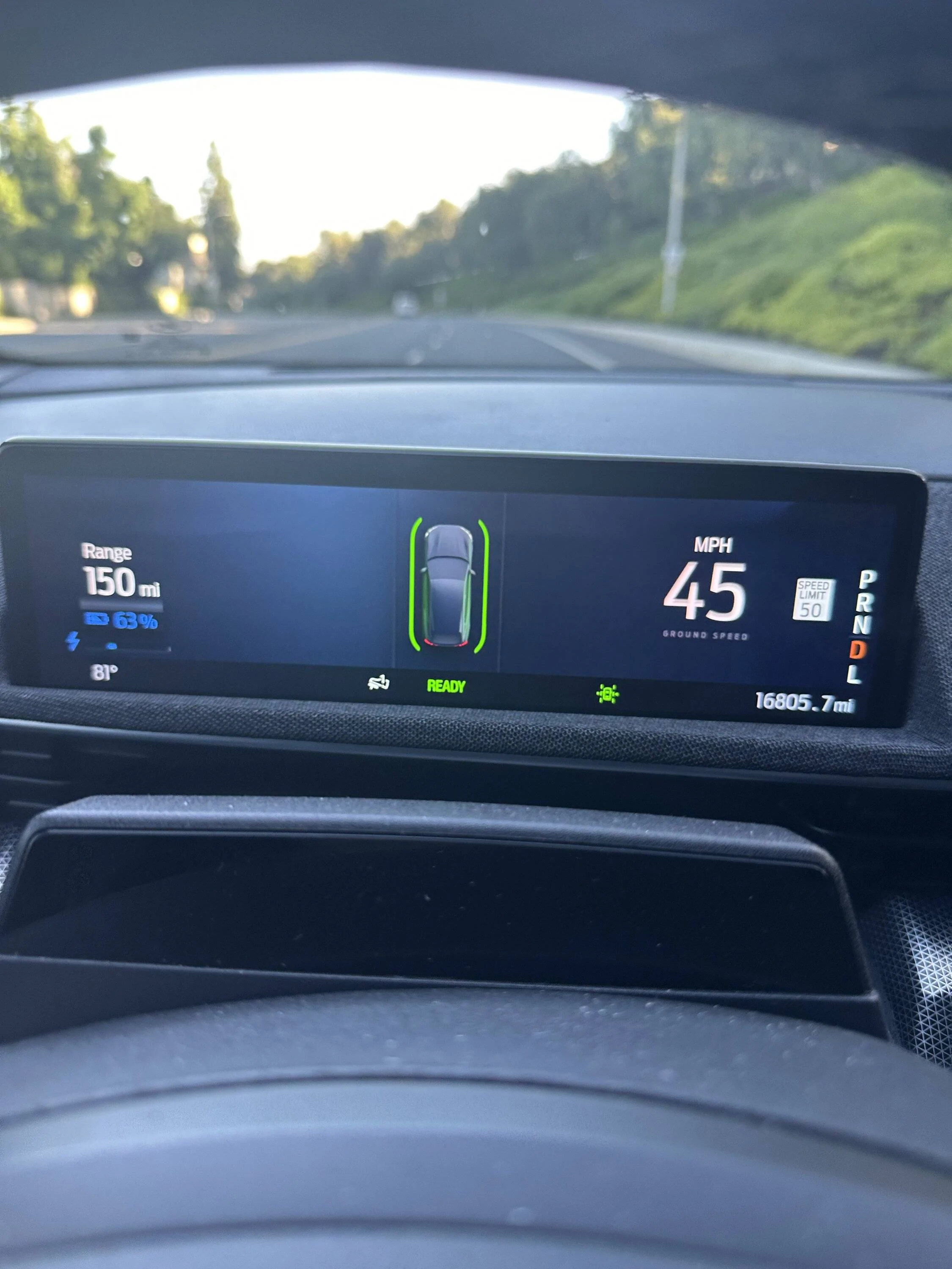

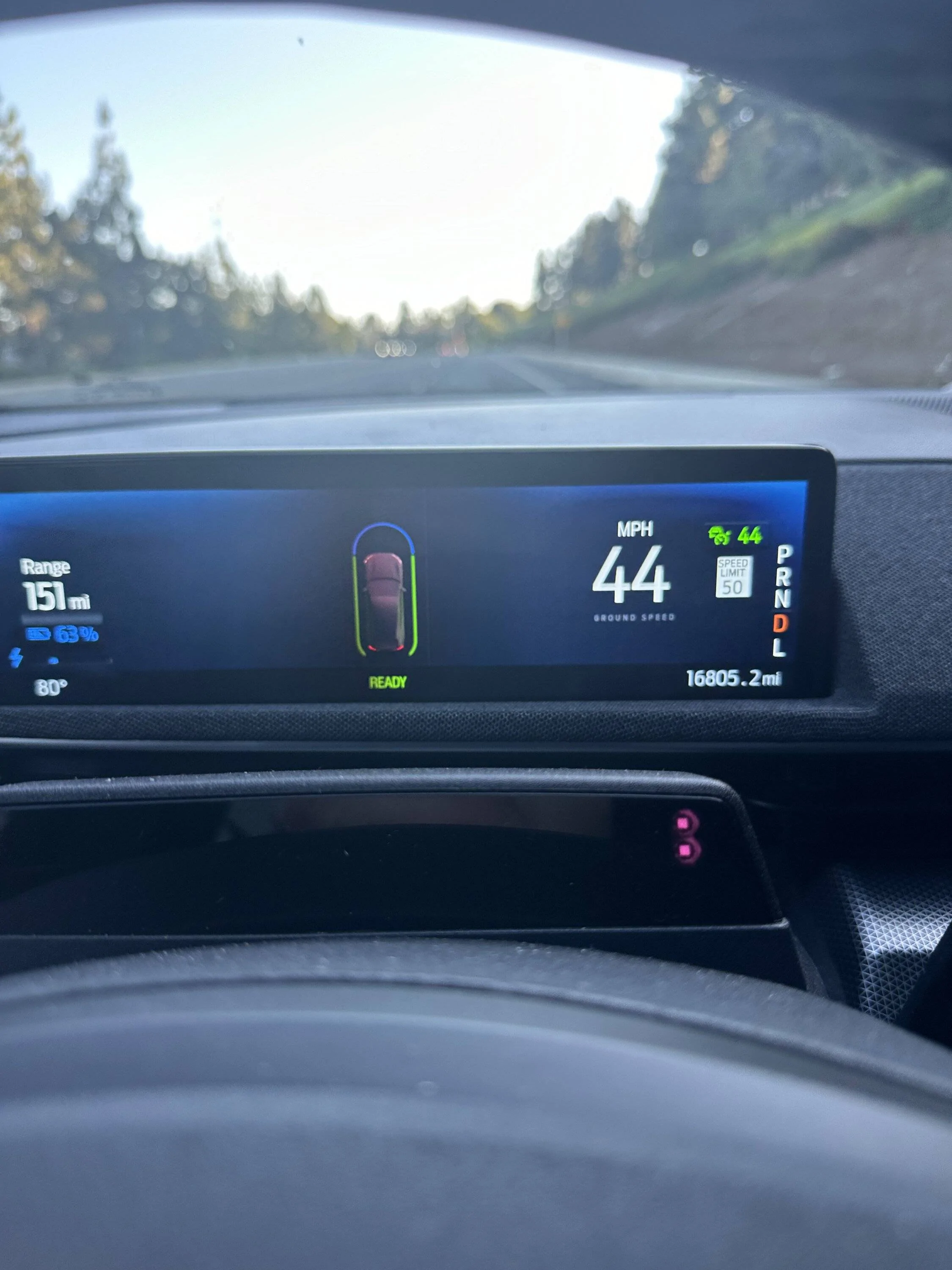

Well the IPC update has quite a few changes, definitely 1.3 prep.
The next turn indicator now only appears on the IPC when you’re 0.3 miles from the next action.
The hands free Bluecruise graphic is different and has a different animation when it activates.
BC hands free no longer deactivates when you use the turn signal, both full and short activations. If you turn the wheel while the turn signal is active, then it’ll deactivate. This is clearly for 1.3 lane change assist and seems like it’ll be great as you won’t have to fight the car if you just decide you’ll do the lane change yourself.
The hands on BC, though not really seeming like it’s BC anymore, is a totally different graphic than before. It’s now just the solid green lines you get when you're driving showing that the lines are recognized. I hate this change. There is now no difference when just driving and having hands on BC activated other than the cruise control speed on the screen.
They didn’t update the “cancelled” graphic when BC hands on stops due to not seeing lines or something and it still shows the normal blue bubble around the car like it used to and “cancelled” on top of it.
