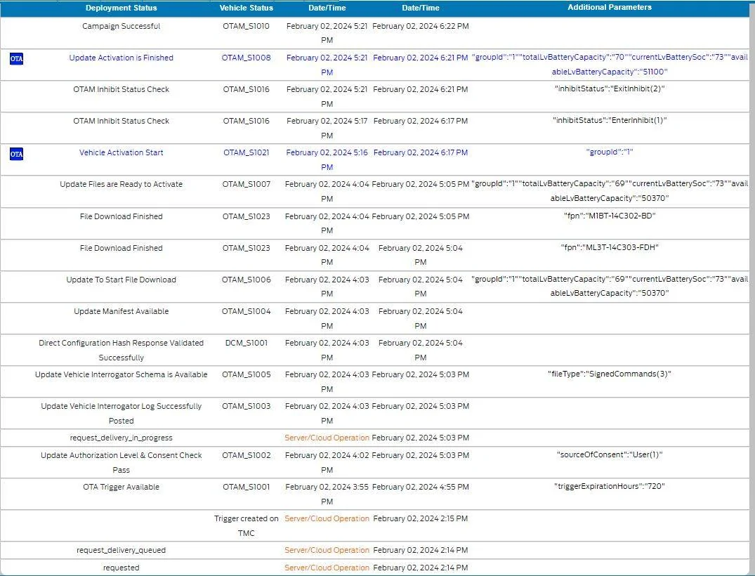

@Robob Correct. I have seen vehicle go months before they sync up with the server. When an OTA trigger is sent to a vehicle and it activates, the interrogator will sync the vehicle with the server and provide an updated manifest at that time. At that point, the vehicle verifies the files that the mothership wants to send before they are downloaded. If the files don't match, the OTA trigger will failed with a "manifest mismatch" or "software mismatch" error that can be seen in PTS.
What I am not sure of, is if the interrogator polls all the modules at that time, or only the module(s) associated with the OTA.
