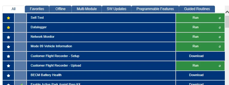

I finally got around to getting an FDRS license to install updates. The dealer installed the majority of the updates a few weeks ago, so I figured there might just be some smaller updates that I could cut my teeth on. When I go into FDRS, this is what I see. Does this mean I don't have anything to update?
Ford Mustang Mach-E The Complete DIY Guide to Updating Your Mach-E with FDRS 1716662944047-w8
Ford Mustang Mach-E The Complete DIY Guide to Updating Your Mach-E with FDRS 1716662926931-l
Click on the SW Updates tab. If there are updates they will all show in there.

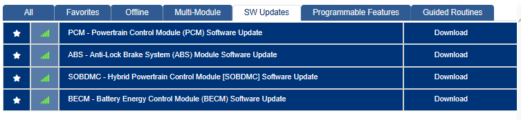

Out of curiosity, I have these updates showing. Any idea of how long these might take? I think I may be unexpectedly time-limited today.
Ford Mustang Mach-E The Complete DIY Guide to Updating Your Mach-E with FDRS 1716666015246-lv

About 25 minutes.
Thanks much. That gave me confidence to do these updates, and it completed in about 15 minutes from pushing Run.
It did take me much longer to get setup, and I think I need to get some longer alligator clips for the power supply (I'm using the Pyramid PSV500 that I saw recommended elsewhere).
And I spent more time trying to re-find the link to clear the DTCs than I spent waiting for the programming to finish.
