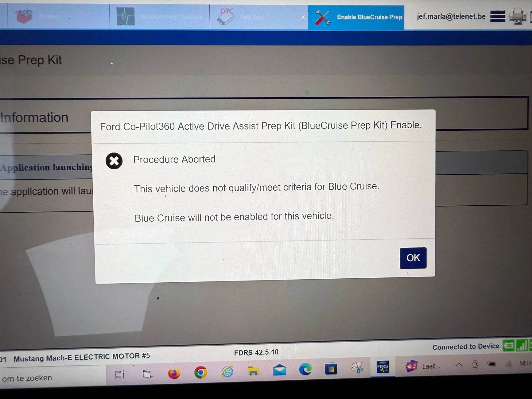

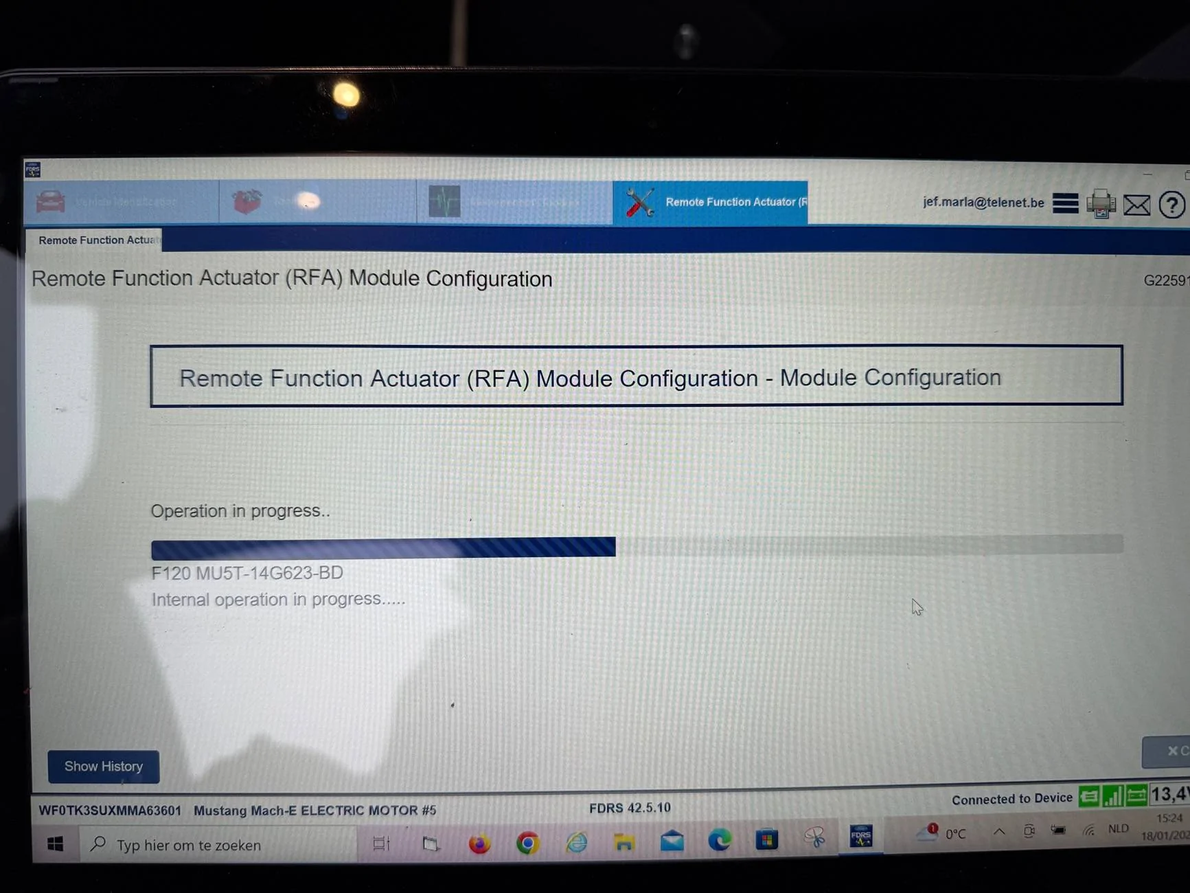

I’m not up to date. RFA always is saying unsuccessful.

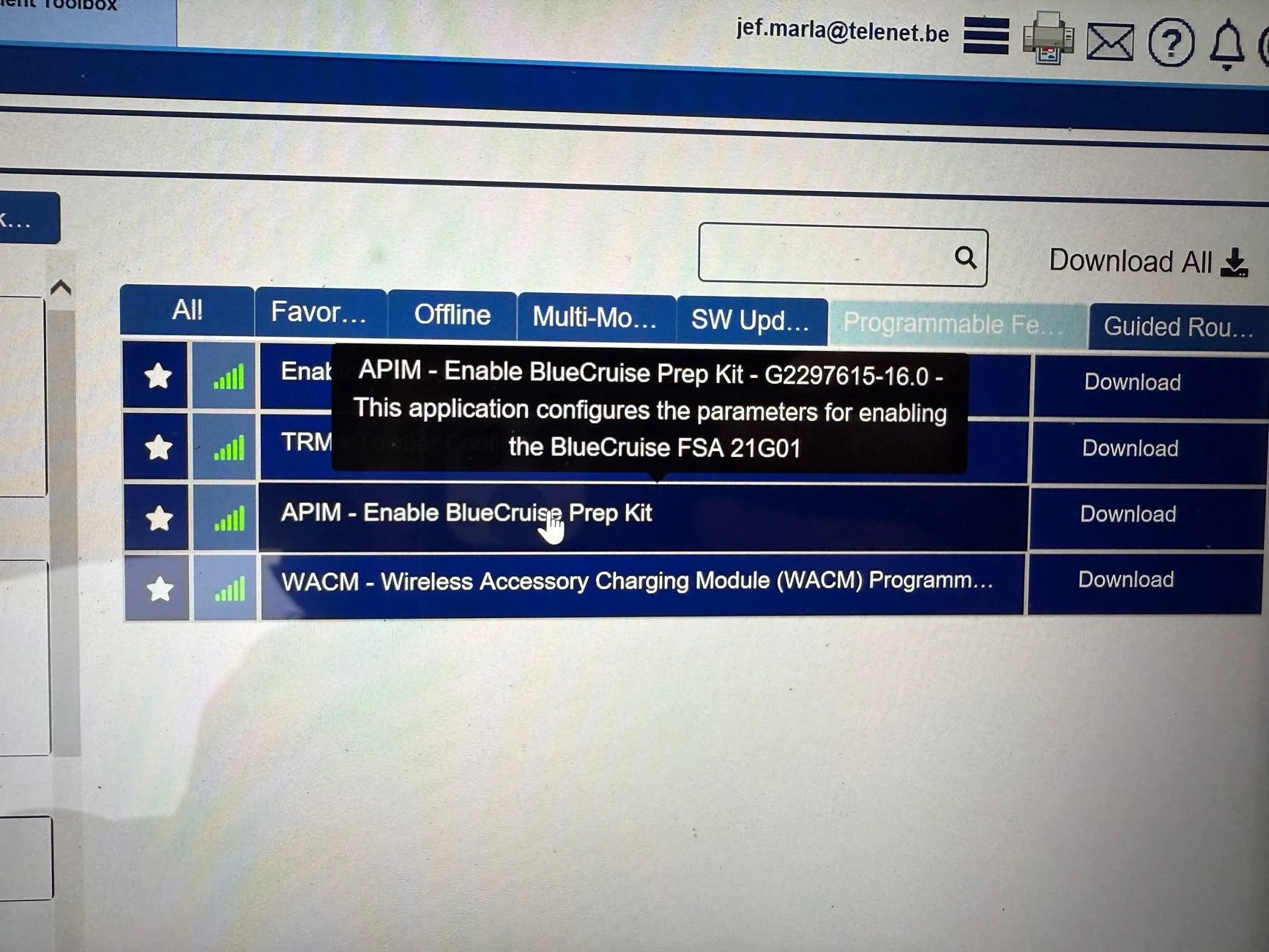

but I think I also need to de the bluecruise prep kit. Never had bluecruise on this car.
Btw. Running step 1 that I suggested.

The purpose from my update is to get Bluecruise alive on this car.
but dealing with some errors on the RFA.
if have read somewhere that you need to run the bluecruise prep kit on the 2021’s
But wanted to be sure.

What I would try next is running the RFA Configuration tool. (1)
If that doesn't work, then run the PMI on the RFA (2) and say "No" if you're asked if the original module is still installed.
solution 1 unsuccessful. ?
Is it a risk to try the second solution you suggested?
No risk, it re-downloads the software and asbuilt configuration as if it was a new module.

It’s running now.

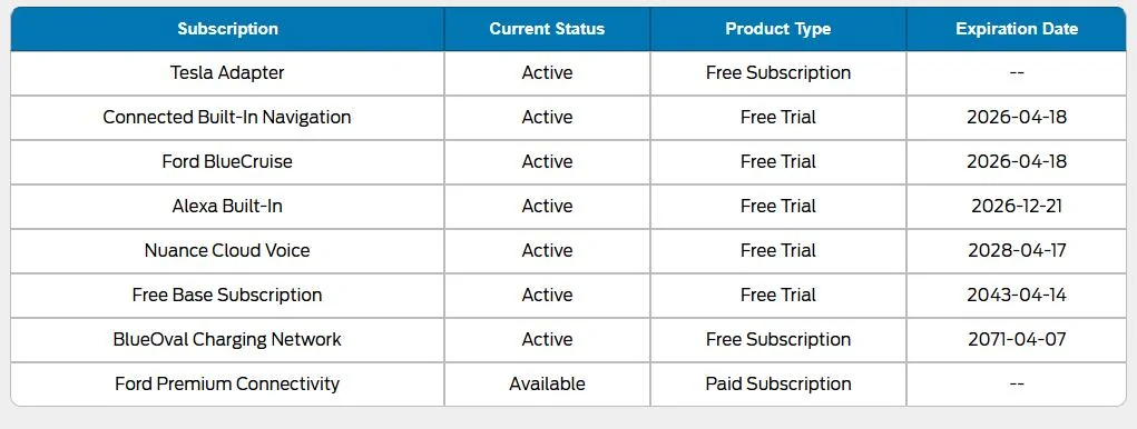

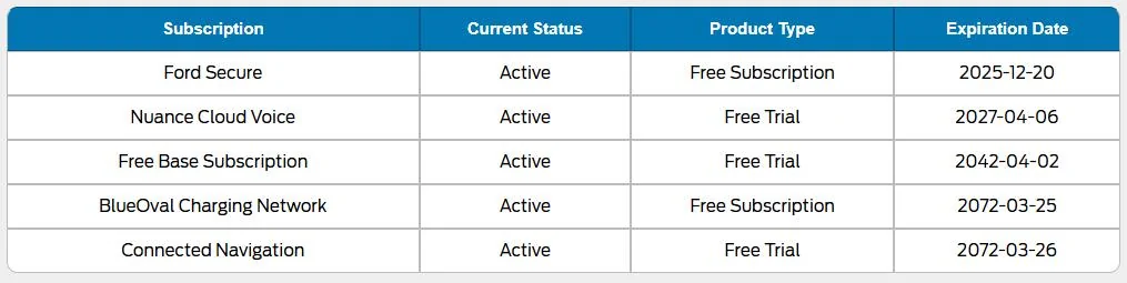

When I first enabled BlueCruise on my '21 model in Feb of '22 we didn't have this tool. It just automatically got enabled once all the files were updated. After the updates I got a notification by email and in FordPass that BlueCruise trial was now enabled for a year.
In your case, I have already checked the vehicle subscriptions and there is no BlueCruise subscription listed as available for your VIN. You have some listed subscriptions that you don't have enabled, but BlueCruise isn't one of them.
Example, no BC subscription listed:
Ford Mustang Mach-E The Complete DIY Guide to Updating Your Mach-E with FDRS Subscriptions_No_BC
And a car with BlueCruise:
Ford Mustang Mach-E The Complete DIY Guide to Updating Your Mach-E with FDRS Subscriptions_With_BC

You can certainly try running the APIM-Enable BlueCruise Prep Kit to see what happens.
solution 2 also procedure unsuccessful.

What actually the RFA module does?
only Paak?
PAAK and everything Bluetooth related.
My Lightning has a RFA update still in the list because it won't clear. It's possible that the RFA update for your car is a defective update.
If your Bluetooth is working and PAAK is working well, then I'd leave it alone.
