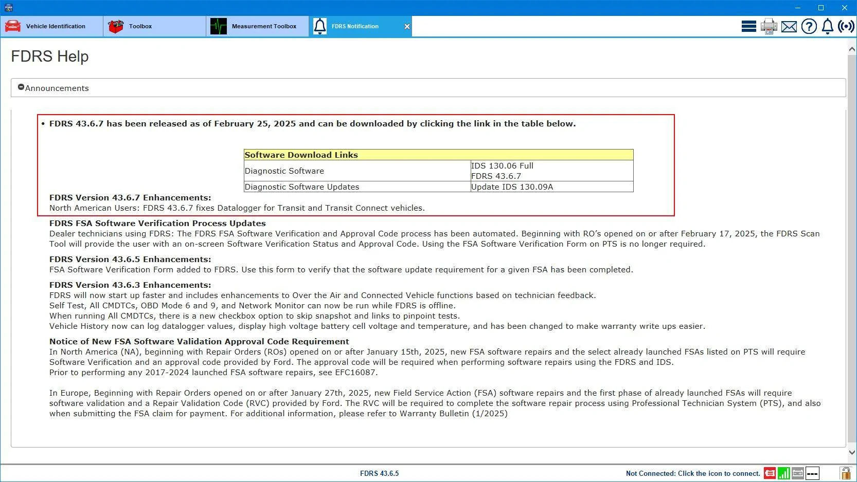

FDRS 43.6.7 is now available to download.
Ford Mustang Mach-E The Complete DIY Guide to Updating Your Mach-E with FDRS FDRS_43-6-7_Not

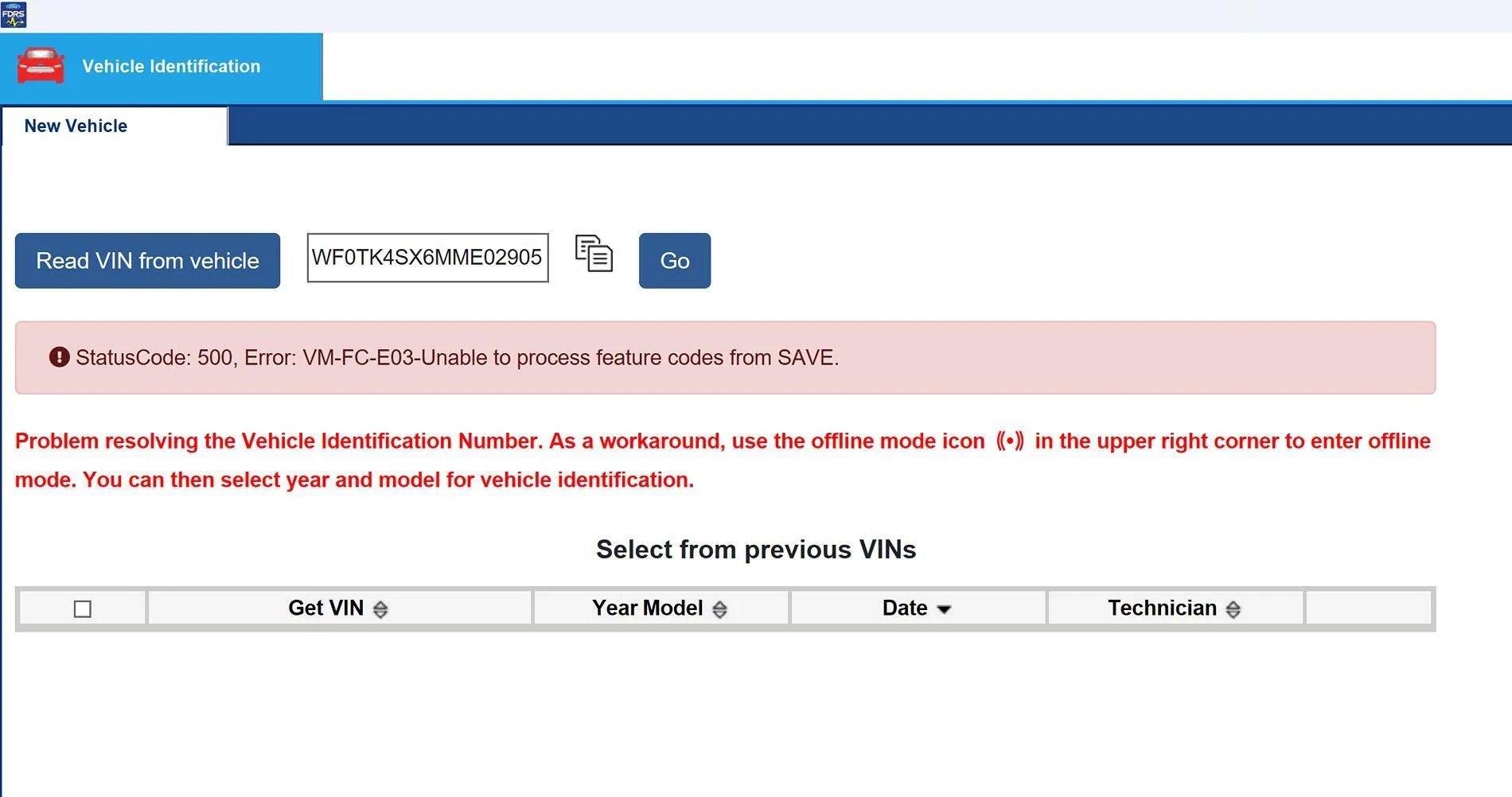

Hi,
Just bought a one day licence but I've got the following issue :
Ford Mustang Mach-E The Complete DIY Guide to Updating Your Mach-E with FDRS 1740679286591-8u
FDRS 43.6.7
try to uninstall and reinstall, reboot etc.
Do you know why I'm doing wrong ?
Same user than where I've bought my licence

Hi,
FDRS 43.6.7
Does your user name/password work to log in to the Motorcraft website?
Mike G
Mar 27, 2022
6,449
5,289
N. AL, USA
Hi,
FDRS 43.6.7
The login help says if you can't log in to FDRS, first try to login to the https://www.motorcraftservice.com site.

Yes, it works on www.motorcraftservice.com, it is where I've just bought the licence.
do you think I can create another account to test ?
The license key must be same of employee mail. In motorcraft account you can assign more employees. You can create a new email in motorcraft as employee and link with the main account (It works for me in Spain)
