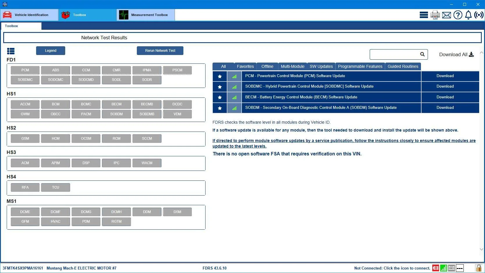

Just wrapped up a short session with FDRS that was mostly uneventful. The only thing that gave me some worry was the ACM.
FDRS indicated that programming the ACM failed, and I tried it twice. Canceling the update after the 2nd failure and clearing DTCS seemed to indicate all was fine. Radio still works, and the updated disappeared from my list so I guess it updated successfully? Perhaps some issue with the update routine since all modules are showing green in the network test?

If your AM radio works then you should be good.
Lightnings have had an ACM that won't update for about 6 months now. And many also have an RFA that refuses to update or drop off the list. ?‍♂

On that, a friend of mine did the FDRS update on my car yesterday. I sat in driver’s seat and pushed start button on/off, opened/closed door and rear deck on one update, and switched off the auto shut down under vehicle settings, all on command while my friend did the brain work on the computer. All 10 updates that Mike G had noted were successfully updated with nothing new showing as of this morning. “We”, really my friend as I was more or less taking up space, also got Beosonic enabled and it actually works. Only open issues are two error codes, one for CMR, other for IPMA. They are related to the known Blue Cruise issue plaguing some cars that Ford is suppose to be pushing a software fix out for by end of Q1 2025. Doesn’t seem likely that’s happening. Otherwise life is good!
