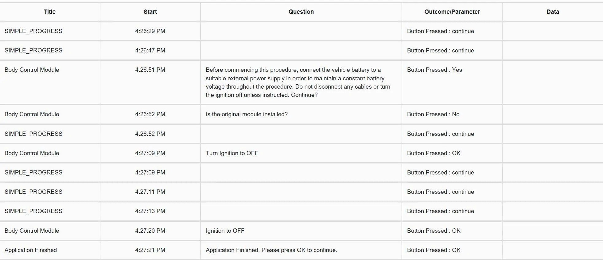

I just looked at the F-150 thread. FYI, I ran a few PMI routines in May while trying to clear some repeating DTC's. I ran the BCM PMI; it ran fine and did not require any post install configuration. I will say that it was the only time I ran a PMI and was actually worried about bricking a module but it was fine.

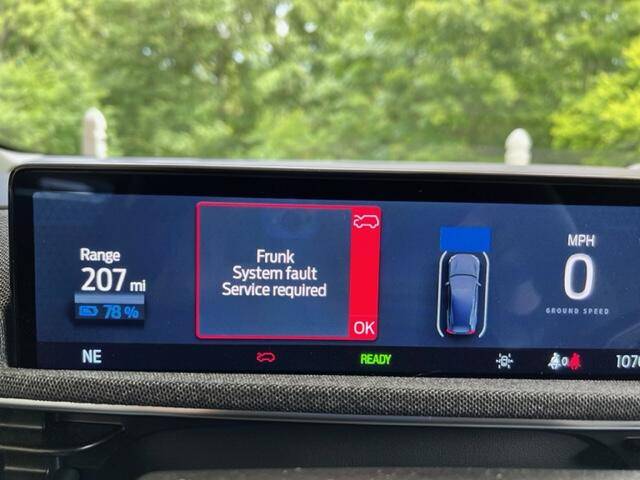

On the BCM update from this morning. There is still no frunk button for those who are wondering but there is a "Service Frunk" message that pops up on startup now and has to be acknowledged. I have a Job 1 with just a manual frunk opening lever so not sure what needs servicing unless its something to do with the latch. The frunk opens and closes and latches normally as it did before the BCM update. And there are no DTCs at all. So. A bit of a mystery. The version it updates to for my '21 Job 1 is MU5T-14C184-ACR.
I've done a BCM config already (2x) and a LIN procedure as well with no changes.
Oh, and I don't use or have PAAK enabled.
I assume you're still getting this Frunk fault at every startup? I was going to run the OBCC and BCM updates today, but maybe I'll hold off.
Yes on the Frunk system fault message. I was told engineering is investigating.

My car is in for a HVBJB replacement and they happened to update the BCM fully... Now getting the Frunk, System Fault error.

I suppose this was expected considering the issue on Job 1's
Yeah, not a surprise. It's kinda funny that they forgot to tell the BCM to ignore the fact that Job 1 cars don't have a functional frunk button.
