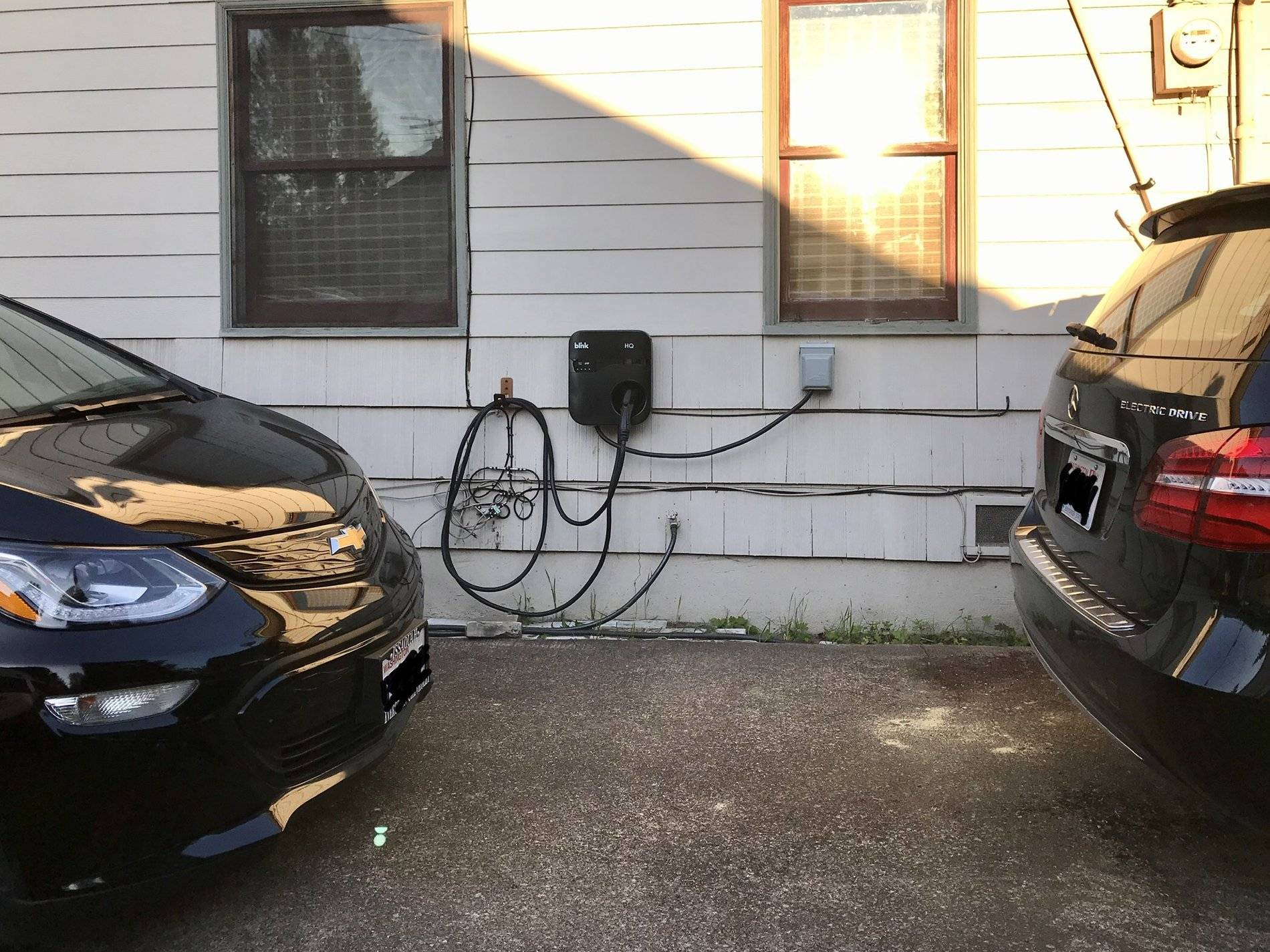

What ever you decide, think about the future. I placed mine so I can charge from both parking spots.

Now I have to figure out charging for a third EV.

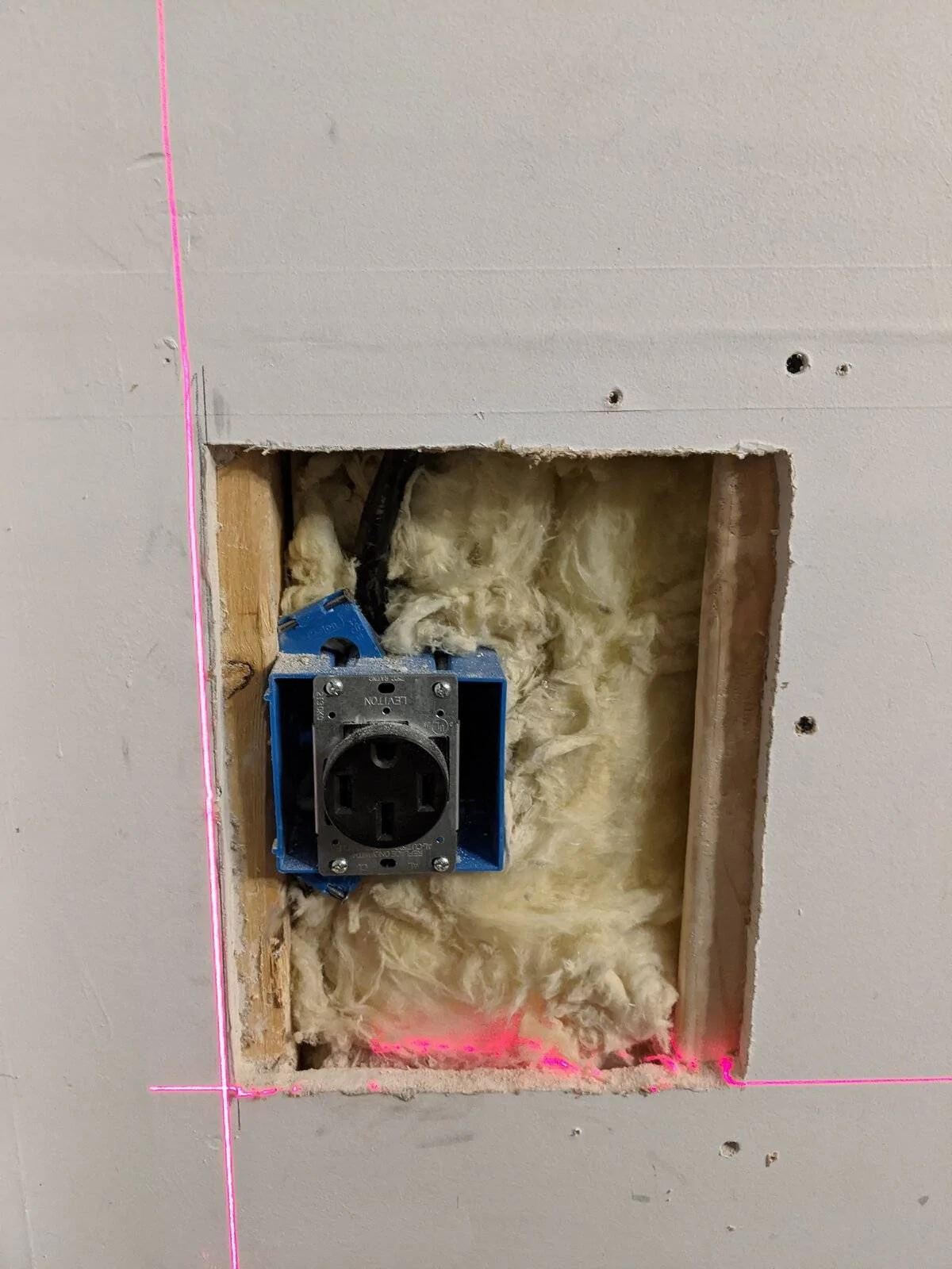

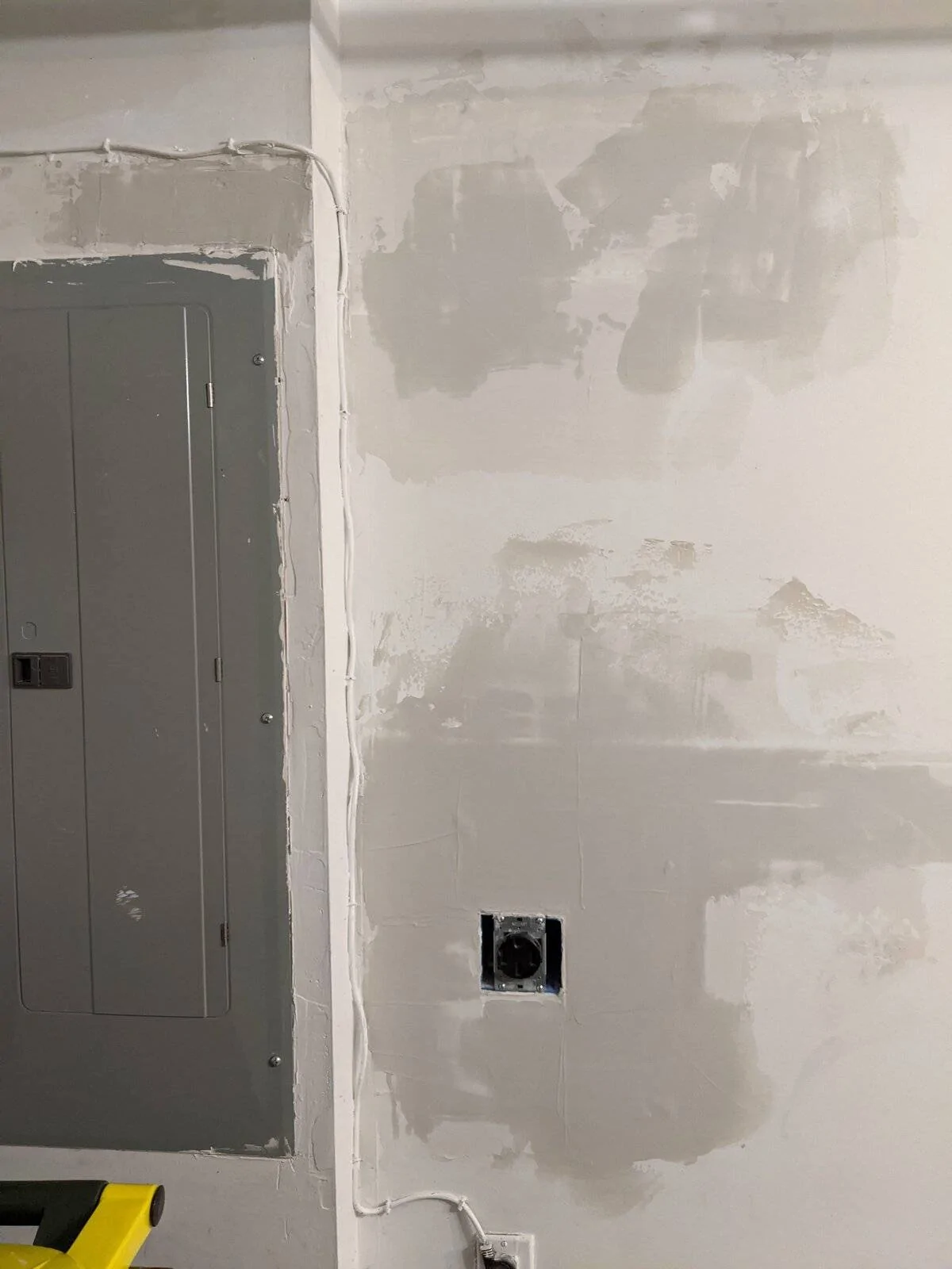

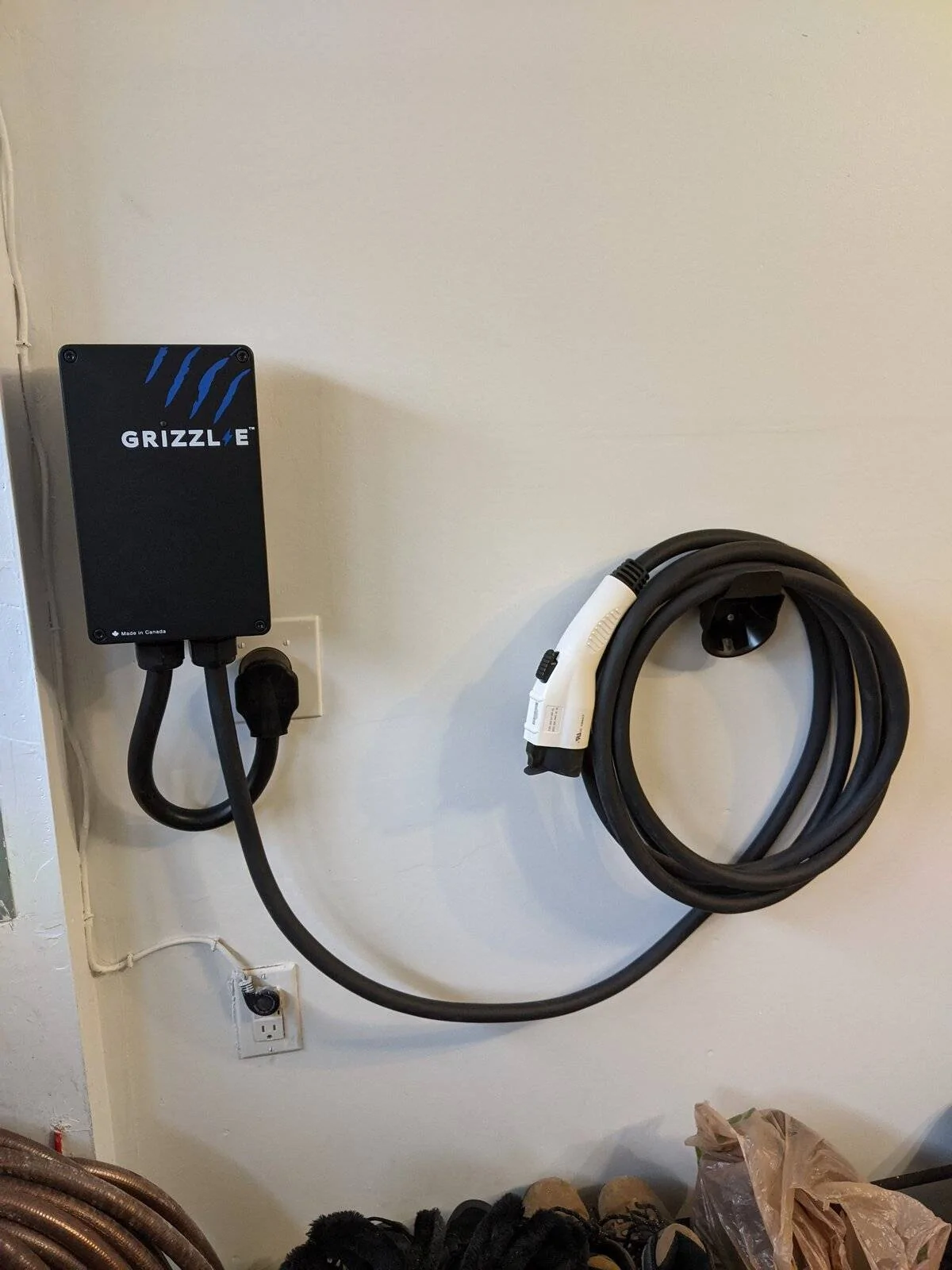

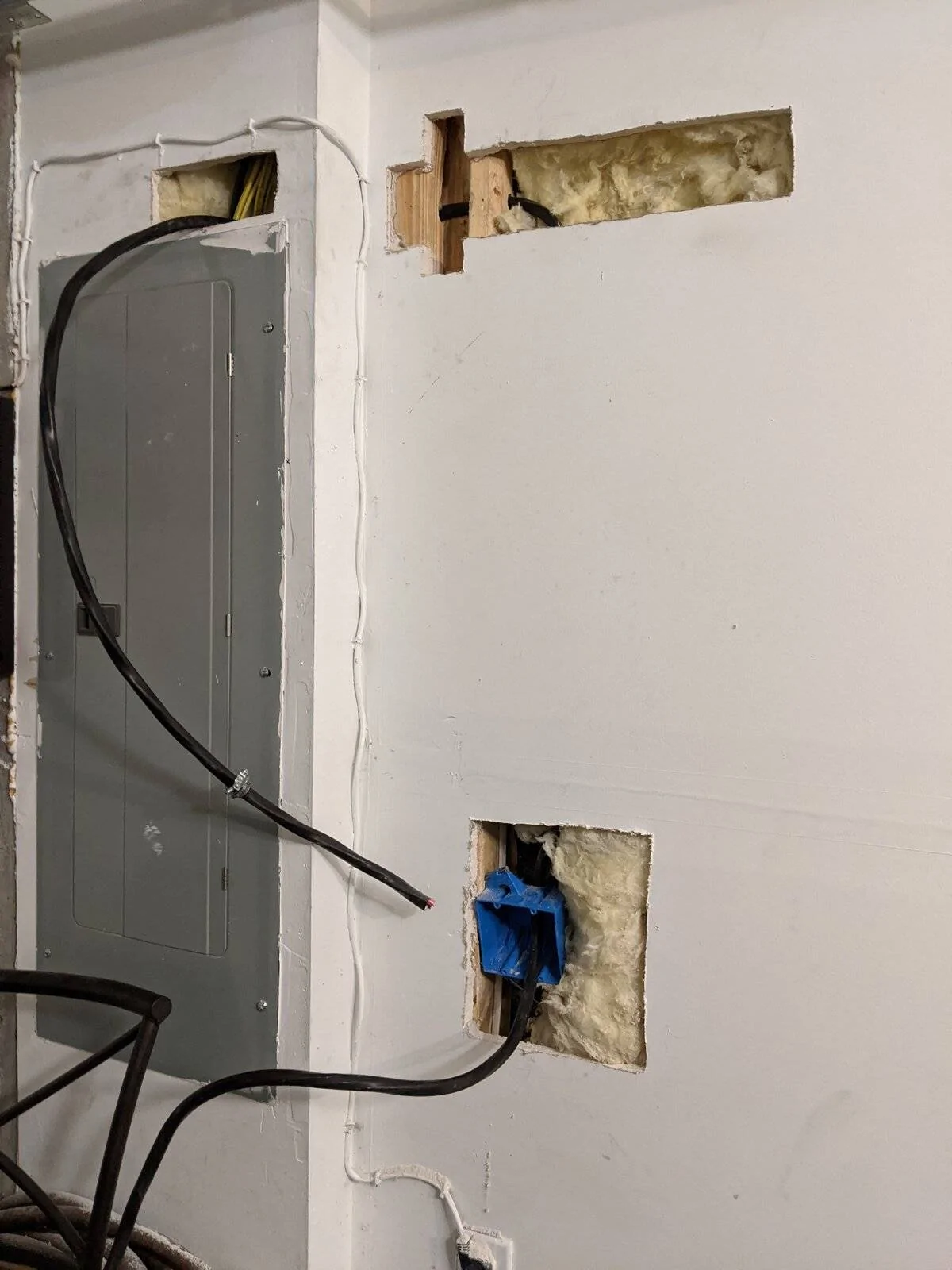

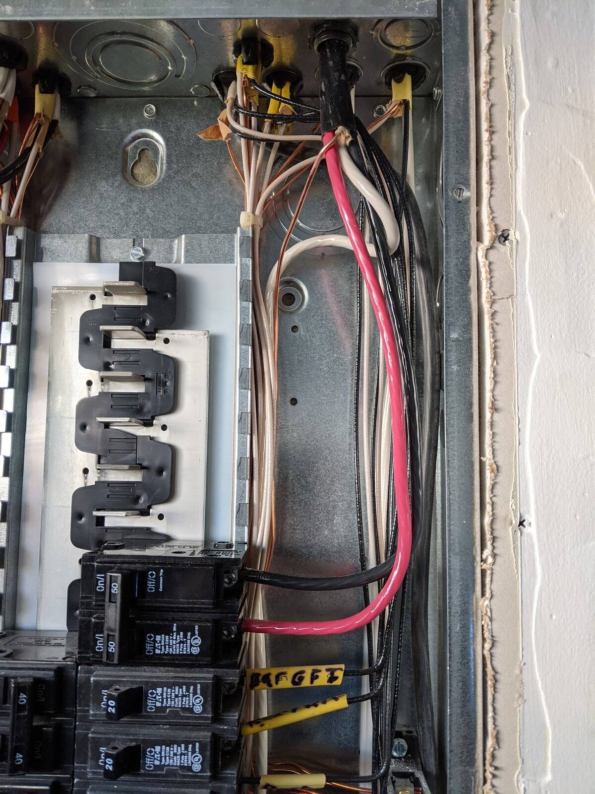

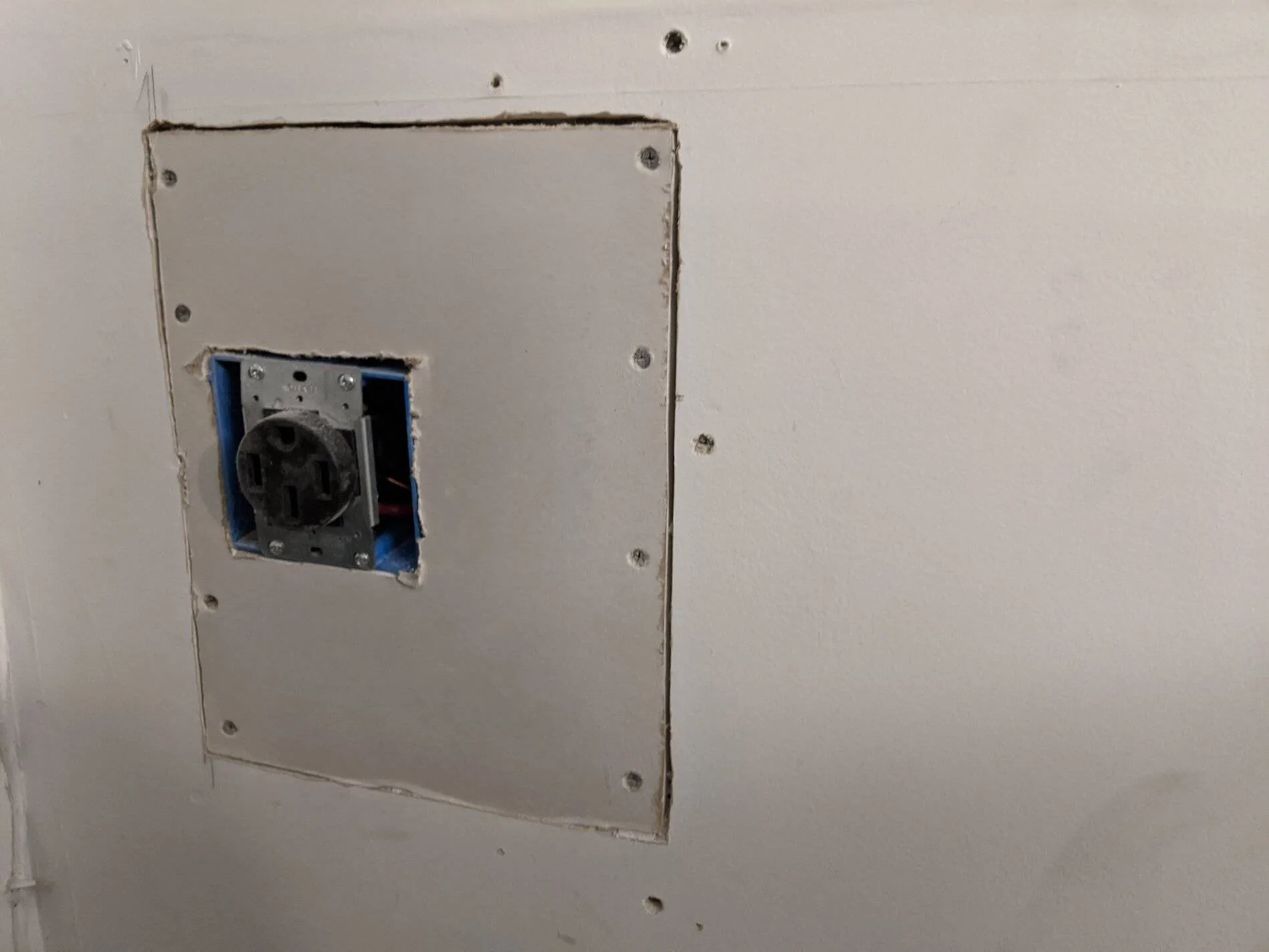

I completed a 240-V 50-amp circuit install in my garage for the Grizzl-e charger, with the goal being to take advantage of the EVSE 30% off credit before the end of the year.
As of others have mentioned, the 6/3 copper romex is a pain to work with. Requires a lot of muscling around.
My particular setup was lucky, since the garage was right next to the panel for me. Total length needed was around 10 feet.
Other than drilling sideways through a stud, it wasn't too difficult, since my run was short, and I had space and capacity in my panel. It was a good learning experience. Here are some pics:

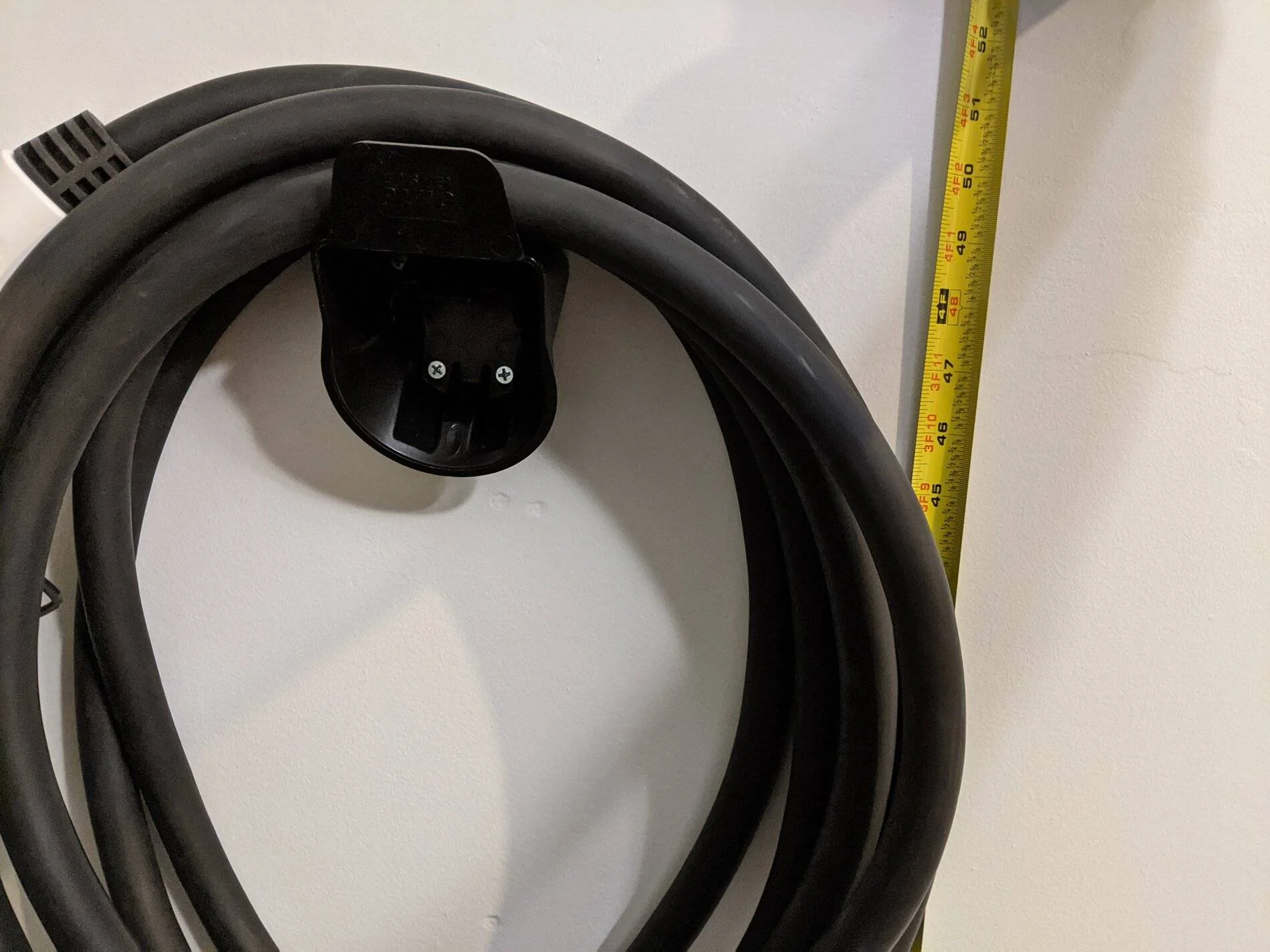

Nice work! The only thing I'd say is you might want to check your local code on how high the charge cord has to be hung. It might be the angle of the picture, but it looks like it might be too low. I know this doesn't sound like a big deal, but if you ever have a fire the insurance investigator really wants to find a code violation so that he can justify denying coverage.
Thanks!
That's a good point -- I didn't consider the height of the charging cable.
I took a tape measure to it just now. Looks like it's about 4 feet off of the floor (at least the hanger is), though I don't know what the code is for this in Pennsylvania. ?
That's probably good, for some reason it looked lower to me in your picture. It's a good thing to check, because it is part of the code how high the hook is.
It's a bad picture angle, sorry :)
I'll admit - I did just sort of eyeball it and pick the height randomly. Came out at about 4 ft. For future reference, this is good to know... It's also easy to move this "EZEV Plug" hanger that came with the Grizzl-e. Just four screws.

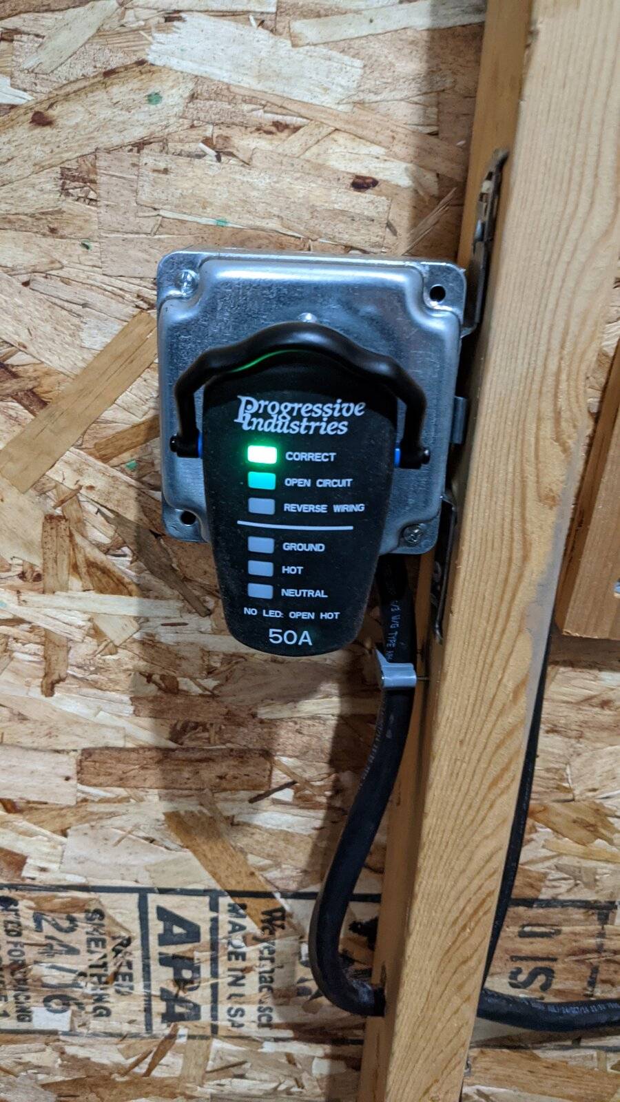

Not sure if anyone else uses one of these, but seems like a nice idea for that extra peace of mind to check the circuit.
