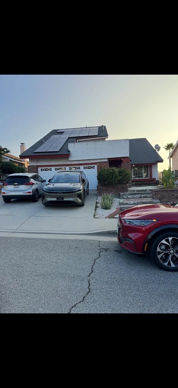

We are 100%. EV. 2017 Bolt with 297k miles, 2021 Mach E with 180k miles and 2026 Lucid Gravity. As for repairs, Bolt had the inverter replaced for $3400 at 240k miles. Both Bolt and Mach E had the steering tie rod and shock replace recently. Lots of tires and cabin air filter of course.
As for L2 charging, we have the Enphase dual chargers. We lived in Los Angeles area so cold weather is not an issue.
Before the Lucid, if we want to go long distance out of town, we will rent a car for the weekend. No stress about charging. Now the the Lucid, that is fairly stress free.
Ford Mustang Mach-E Thinking about going 100% EV - quick question IMG_8358
