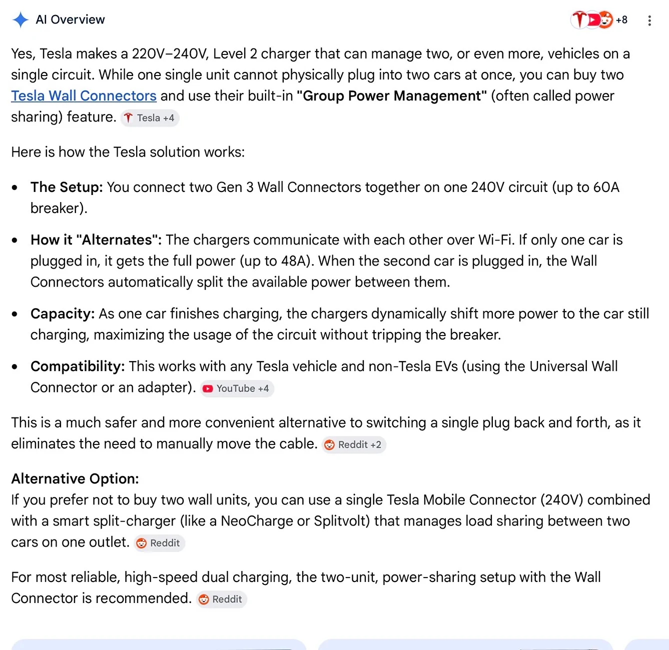

This is what the couple that bought both my used Mach E‘s bought from Tesla. Has used it for over a year now and said totally works as advertised.
This is an awesome setup; however, it is missing some information. Not all jurisdictions allow the setup as described without additional equipment, so I encourage folks to verify their local rules first and get a cost for setting it up before jumping in.
Here in my jurisdiction, the EVSE must be the only appliance on the circuit. To set up two EVSEs for load sharing, you need a sub-panel with a full capacity circuit downstream for each EVSE, and a separate certified EV Energy Management System (EVEMS) to monitor the branch circuit feeding the sub-panel. Only then can you use the Tesla load-sharing functions. Two separate EVSEs cannot share the same circuit, relying solely on Tesla, ChargePoint or Wallbox WiFi-enabled load sharing. The EVEMS, of course, adds more complexity and cost to the installation.
AI is wrong, per usual.
You are not supposed to wire two on the same circuit with a single breaker. They both can be on the same branch circuit from the main panel, but each wall connector needs its own separate breaker so you would need a subpanel.

Ah didn’t realize the Universal Wall Connector has different internals. I’m only familiar with the Gen 3 version with a Tesla connector only, which did not support this type of install.
Still the AI is wrong because it says you can do it with gen 3 wall connector.
AI is crap.
