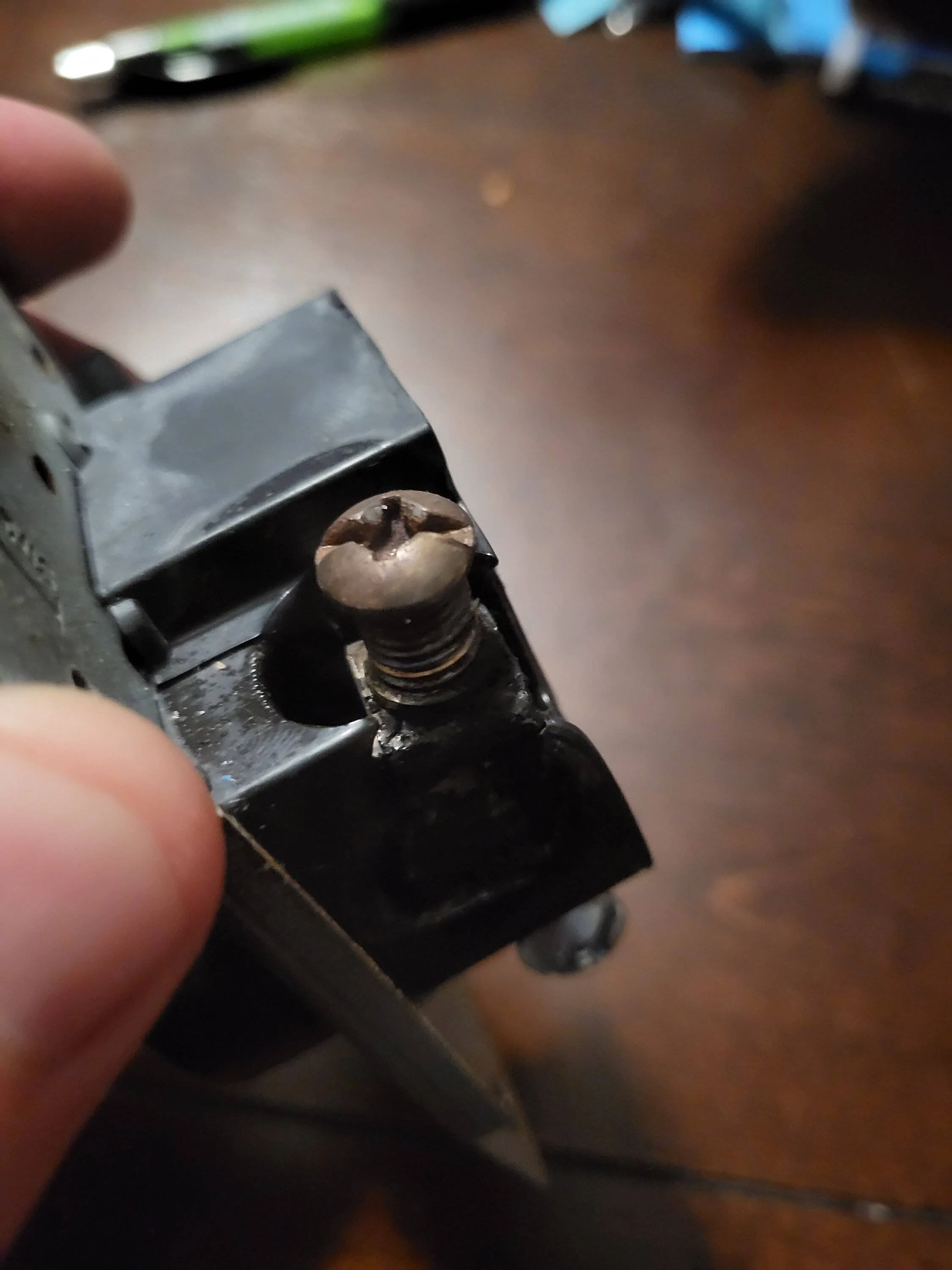

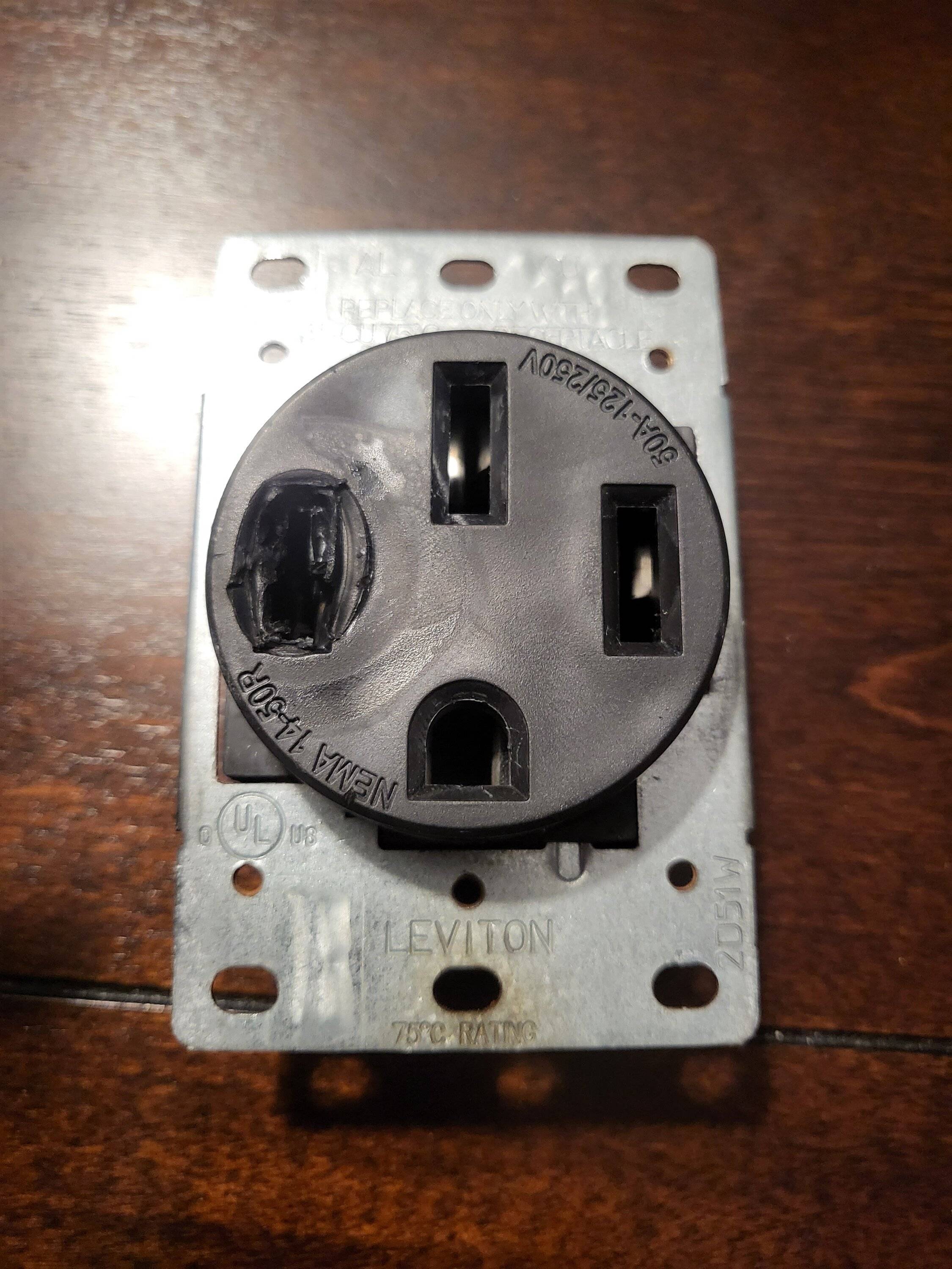

Whatever you decide to do, if you have a new circuit run make sure that an industrial grade outlet is used. Do not let an electrician (or DIY) install a $15 outlet from Home Depot.
I even read a post about this, decided the $15 version was fine anyway, and of course it melted.
