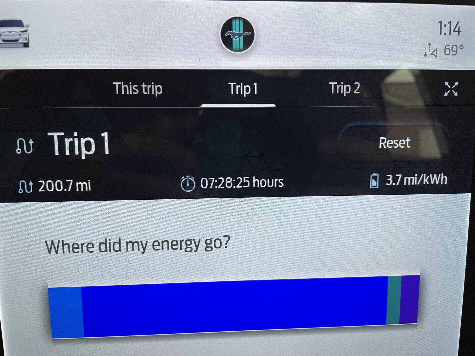

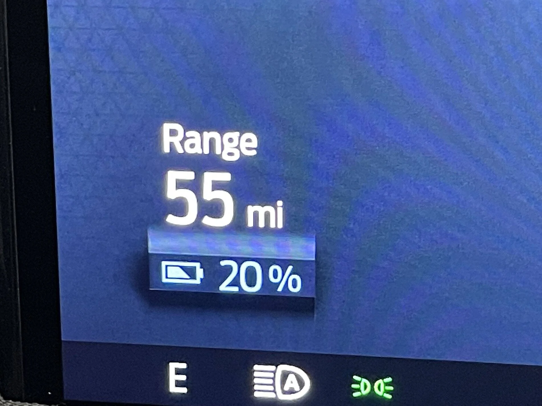

So interesting test I did, not sure if its an accurate way or not, with my GOM. If this is not the best way to get your range, please educate me!
I started to see a decent drop in range this month. I've always heard resetting your driving history helps with the GoM, so I reset it as I've never rest it since owning it. I live in San Diego, it gets to maybe 55 degrees at night and quickly warms up to at least the 60 degree mark, normally warmer. My car was showing me a 244 mile range at 90% while in the garage and conditioned. Typically my car will show between 290 to 304 mile range at 90%. I've never reset my Trip 2 or Trip 1, both showed 4678.4 miles at 3.9mi/kWh. I will also add when I check my current trip when driving into work I'm always at either 3.9 or 4.1 when arriving. I made sure I checked every day this week.
So, I reset my Trip 1 with the car at 90% showing 244 miles. I ran the car down to 20%/55 miles, showing 200.7 miles on trip 1 at 3.7mi/kWh. Given I get about 15 miles per 5% of charge, that would give my car 60 miles of range vs the 55 it was showing. This would give me a total range of 260 miles at a 90% SOC. I would get 273-280 miles every day when I used to only charge to 80%.
So seems like the GOM is actually pretty damn close, only off by +16 miles. What is odd is that my usage shows 3.7mi/kWh. I'm assuming this is lower cause I had my family with me 3 times this week, was her birthday, and I had to run the heater lol Even at 3.7mi/kWh I should be sitting around 325 miles of range at 100% or around 295 miles at 90%. Oddly enough that math of 295 miles is in the range where my GoM would sit during the summer time at 90% SoC.
So it being "cold" at 60 degrees really equal a 65 mile drop, or a 20% loss? First time owning an EV, I can't even IMAGINE the range people are going to see in actual cold weather. If my car is losing 20% in 60 degree weather does that mean people in the 40 or 30 degree are going to see a 50% cut in range??? I honestly did not expect to see any weather impact on the EV here in San Diego..
I am also a new EV owner and wonder if cooler temperatures have a significant impact or not. But one thing happens over time and especially when it gets cooler: tire pressure drops. Low tire pressure will definitely cause a significant hit to range, even 20%. Have you checked your tire pressure to see if they are at around 40 psi?
I just did a 9 hour drive (round trip) and was getting much lower efficiency than I expected. The trip screen was showing 99% of energy use due to driving, and really nothing due to climate or temperature, but it was in the 40-50 degrees outside. I was getting 2.2 mi/kWh on the trip screen. Now I did have the cruise set to 78 mph, so I know higher speed will have a big impact. But still. 2.2 mi/kWh?
Interestingly, in FordPass the trip log shows a higher efficiency than was showing in the car while driving: 2.5 mi/kWh for the trip. I wonder if the real time screen is not very accurate. Seems like it should be easy to measure energy usage while driving, but that does not explain the significant discrepancy.
I just checked the app and it looks like I’m 2psi under now. I’ll have to air them up this afternoon once my tires cool down again.
I did not even think to check that, thanks.
