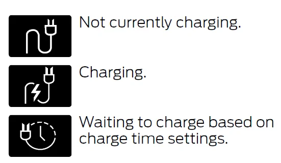

If you have this Icon on the Dash, it will pull power from the shore line if the time is within a scheduled charge/departure schedule.
Ford Mustang Mach-E Tips for Maximizing Your Mach-E’s Winter Range (via Precondition) 1638037737629
Reaching your max charge level by your next departure time is always the priority. When charge times are set, charging outside your preferred charging time windows could be necessary in order to finish by your next departure time. In this case, the vehicle will typically begin charging right away after plugging in.
They are trying to simplify or mimic a cell phone, where it will charge to 100% just before you take it off the charger. It's better to go to 100% charge, and then begin discharging, than staying there for a time.
It's confusing because there are too many variables they are trying to juggle. Locations, Charging Schedules, Departure Schedules, Max Charge per location, plugged in vs not plugged in.
Ford Mustang Mach-E Tips for Maximizing Your Mach-E’s Winter Range (via Precondition) 1638038466519
"Precondition" will happen whenever the battery needs to be heated or cooled, it would be nice to see some sort of indication when the system determines or activates this logic on the interface and mobile app somewhere. You could only use remote starts 2 times in a row before you can reset it via opening the door.
It's happening in the background, I think folks just want to SEE that it's happening.
