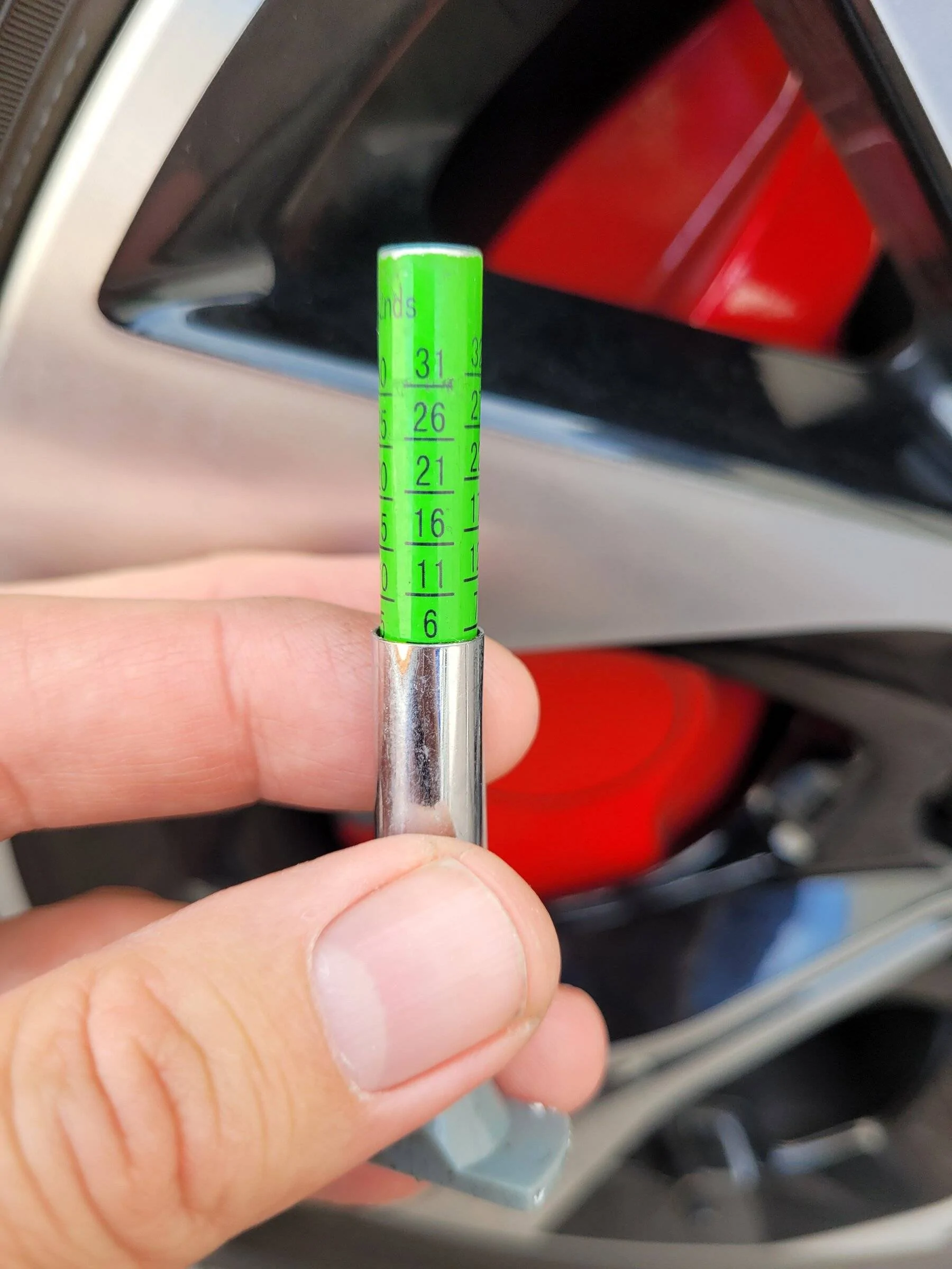

Rotating tires on this car doesn't seem to matter as much as other vehicles. I have rotated my tires once so far.... around 21k miles. I am at 37k now and all 4 tires have the same tread depth remaining (about 6/32")

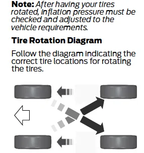

QUESTION if you do it yourself how do you rotate the tires? Aren't they rotated diagally....don't you need a lift????? Just what I heard I am not sure so I am asking....
Thanks
The tires (if not unidirectional) should be rotated so that the rear tires go straight to the front and the front tires switch to the opposing rear corners. 😁🐩
This is from the Owner's Manual. White arrow toward the front of the car. 😎🐩
