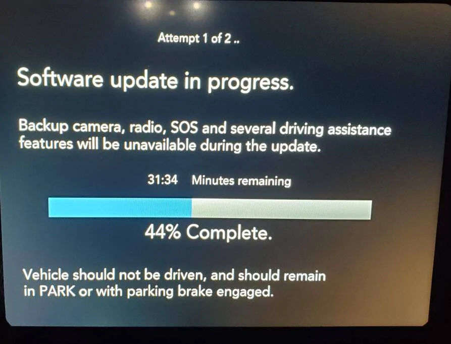

What happened when 3.5.3 stranded you? Were you unable to get into your car or would it just not start? Was there a message on the screen that said it was updating and you had to wait? My Jeep 4xe had that one time. It said it was updating and gave the time remaining. It did ask me not to drive it until finished but I that was just a recommendation. If I NEEDED to drive then I could just start the Jeep and the update would cancel and try again later.

Updating, have to wait message. I think it said 10 minutes. I stowed the groceries walked to Starbucks (100 feet away), got an Americano (so they couldn’t serve me old coffee if I just asked for a cup of coffee), strolled back and it was ready. Less than 10 minutes.

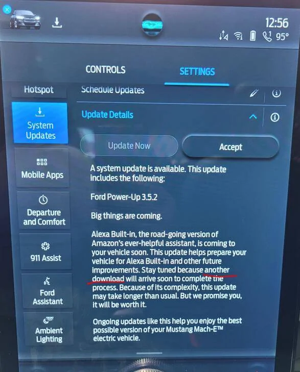

That is interesting. Last update I accepted is 3.5.2 and Alexa appeared and the A/C button was relocated. I never saw nor accepted a notice for 3.5.3. The next notice I received was for 3.5.3.3 which I just let expire and it hasn't returned.
@Kamuelaflyer and I suspect that 3.5.3 installed by itself. Does that sound possible? Perhaps 3.5.2 and 3.5.3 are part of a single update that split into two parts? So accepting the first might have also accepted the second. Makes sense because the release notes did say something about this one taking a little while longer. I didn't get the Alexa icon or A/C button relocation until much later in the day (if I remember correctly...)
You got 3.5.2 on Oct 5th and 3.5.3 on Oct 13th. Sure you didn't recall accepting 3.5.3?
