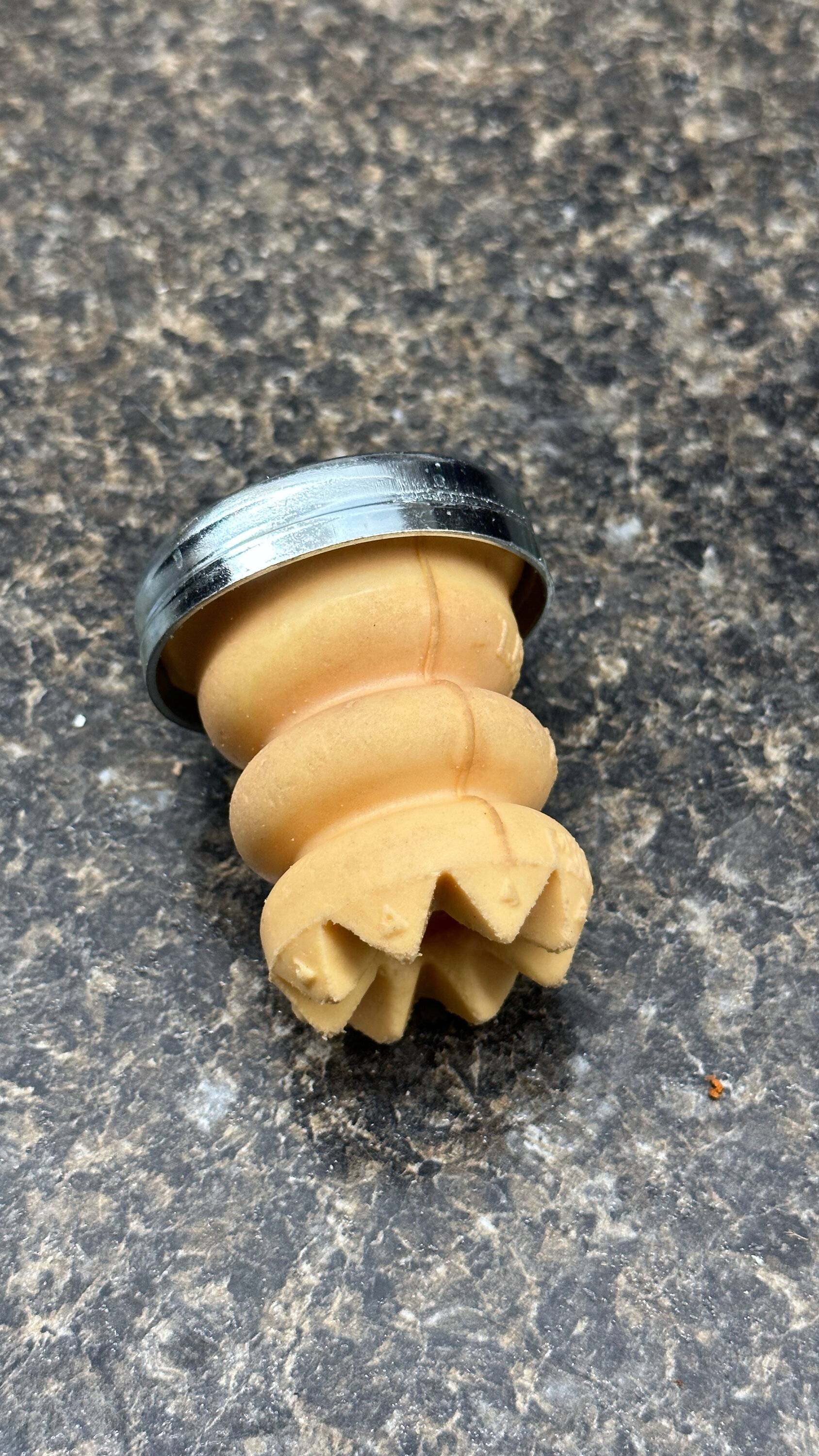

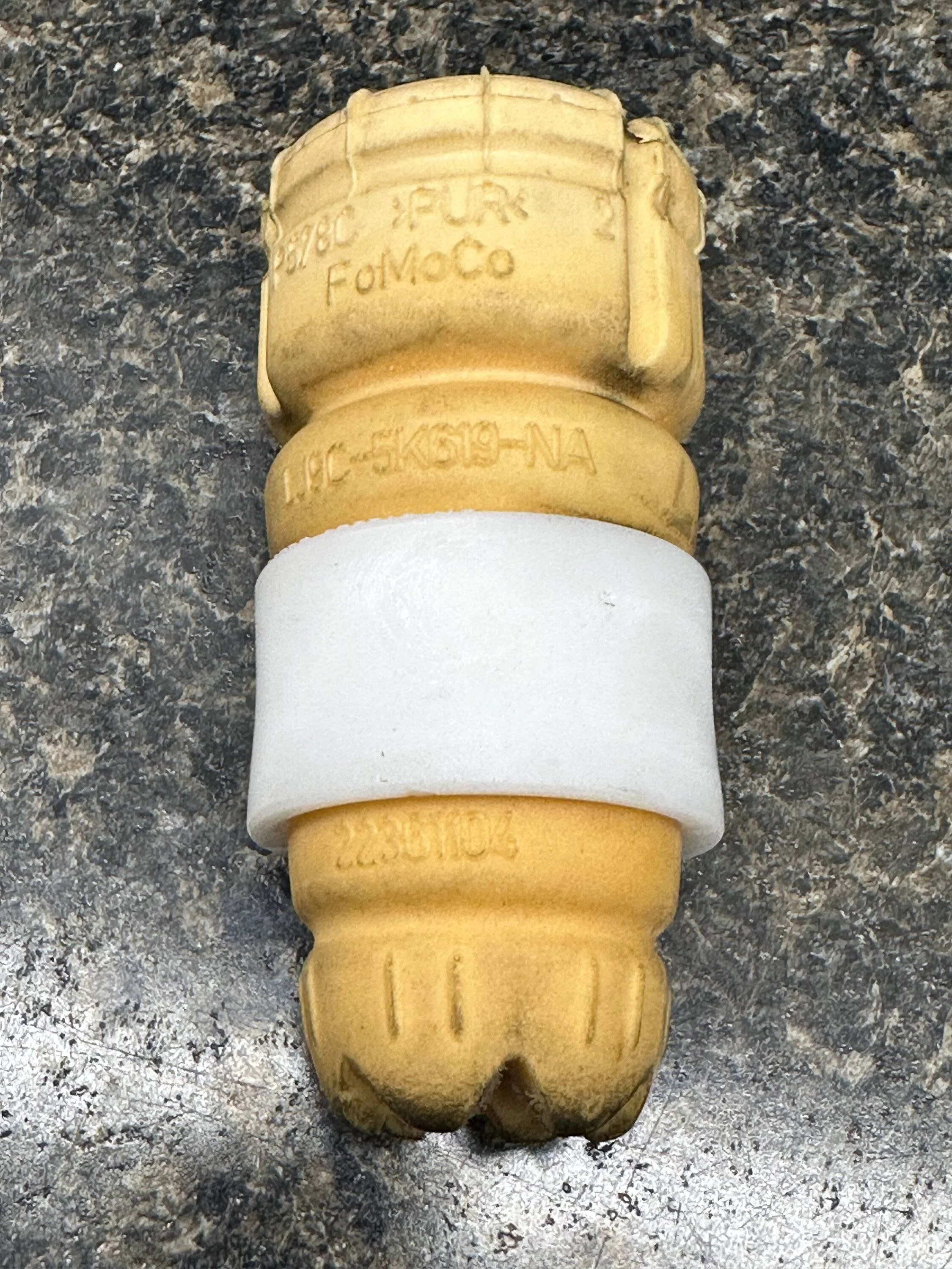

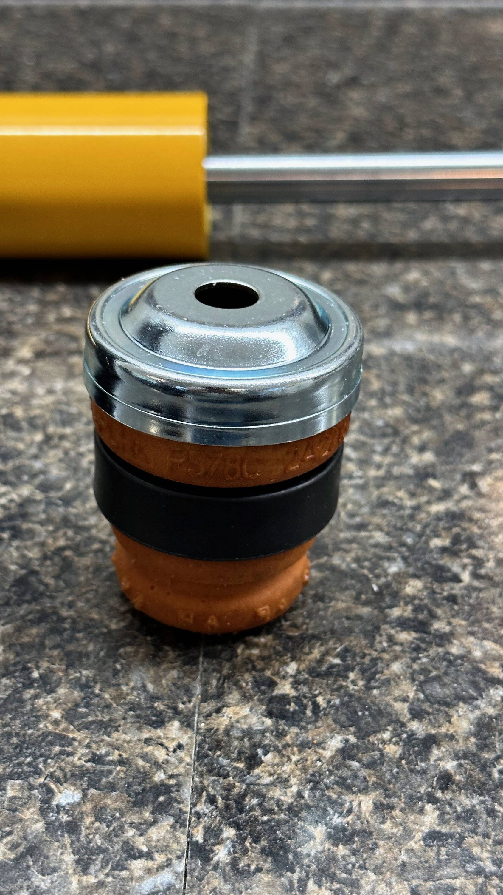

UPDATE ON BUMPER STOPS:
I am going to add this info to the first post but wanted to also share it here. There is a difference between the GT and all non GT bumper stops. The OEM bumper stop I was working with were from the GT shocks. They are the ones below with the white plastic collar on top.
Ford Mustang Mach-E UPDATED: Replacing Rear Shocks: Reducing the rear end bounce. IMG_5048
As I had stated, if you want to use these, remove the white plastic collar and place the bumper stop into the Koni metal cap.
Ford Mustang Mach-E UPDATED: Replacing Rear Shocks: Reducing the rear end bounce. IMG_5050
Or purchase the Steeda bumper stops and do the same thing.
Ford Mustang Mach-E UPDATED: Replacing Rear Shocks: Reducing the rear end bounce. IMG_5044

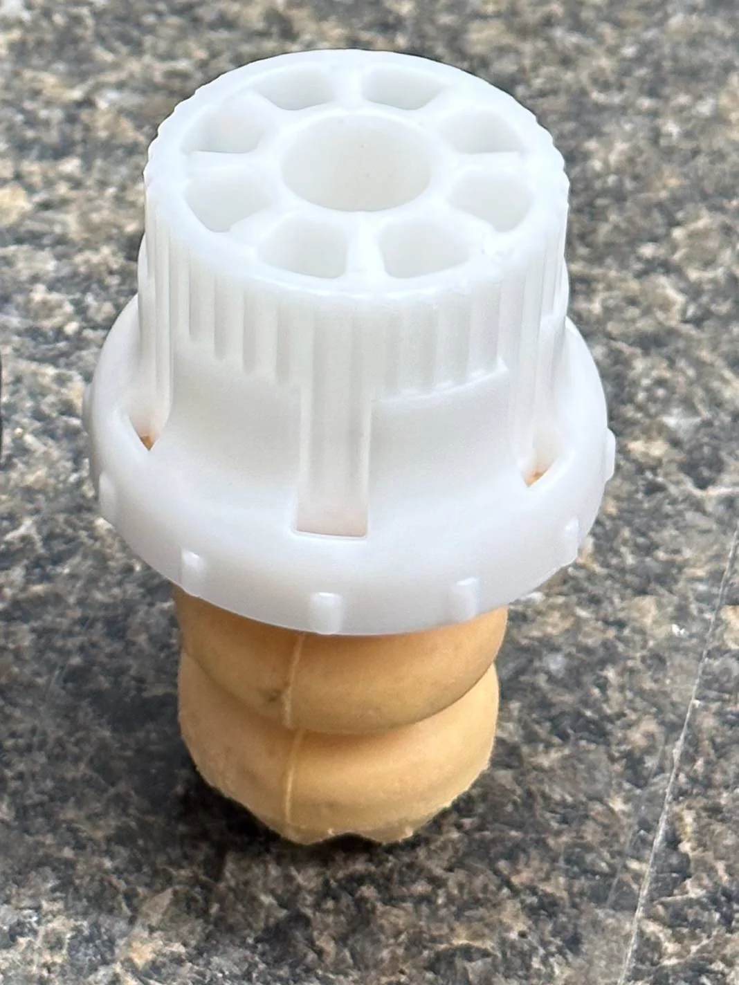

I came across a non-GT shock with a different bumper stop. It is taller and has a much smaller hole which will not easily fit onto the rod of the Koni shock. Therefore if you have anything but a GT, you should purchase the Steeda bumper stops. Personally, I would purchase the Steeda bumper stops no matter what model you have.
This is what the non-GT bumper stop looks like.
Ford Mustang Mach-E UPDATED: Replacing Rear Shocks: Reducing the rear end bounce. IMG_5099
