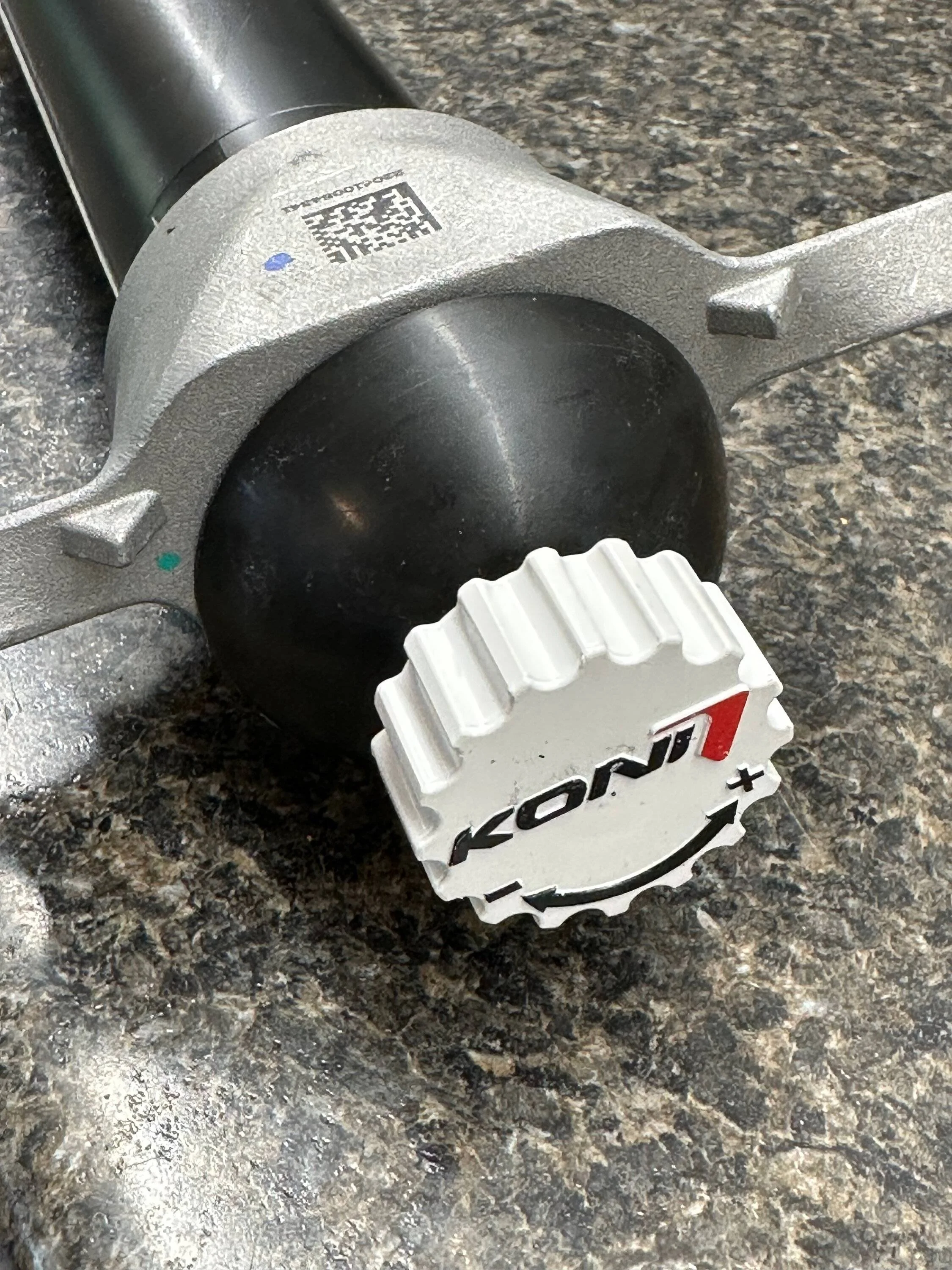

For a parts list and instructions on how to adapt the Koni shocks to fit the Mach-E (non GTPE) scroll down to UPDATE

UPDATE:
Between myself, Anton, Erik, and Lee, we are done testing. I've stated before and so have others, the Mach-E will NEVER have a cushy, luxury ride. The suspension does not have enough travel for that. Changing out the rear OEM shocks to the Koni’s adjusted to the most firm rebound setting seems to greatly reduce or in some cases eliminate the bouncy ride in the rear BUT the ride will be a bit more firm. I personally like the a firm ride and so does Anton and Erik. I’ve also stated many many times, these might not be for everyone. If you want to reduce the bouncy ride in the rear, this should work for you. If you are looking for a Lincoln soft ride, that will never happen and in fact will firm up the ride a bit.
All of this said, if you are interested in changing out the OEM shocks for a pair of Koni Yellow Sport adjustable shocks, until they come out with a dedicated shock made for the Mach-E, I will list below what you will need. This is only for the rear shocks because as of now, nothing is available for the front struts and I will not be trying to work on that anytime soon. We have talked with Koni several times and hope they will be coming out with a full setup in the future.

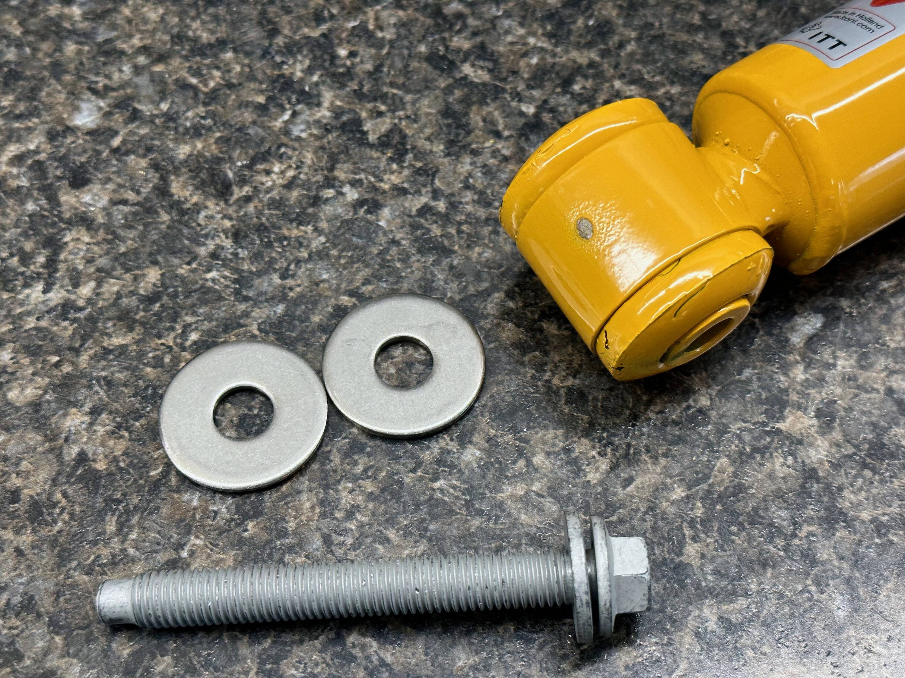

(4) SS washers Oversized 1.5" OD for 1/2" screw size (McMaster-Carr Part: 91525A337)

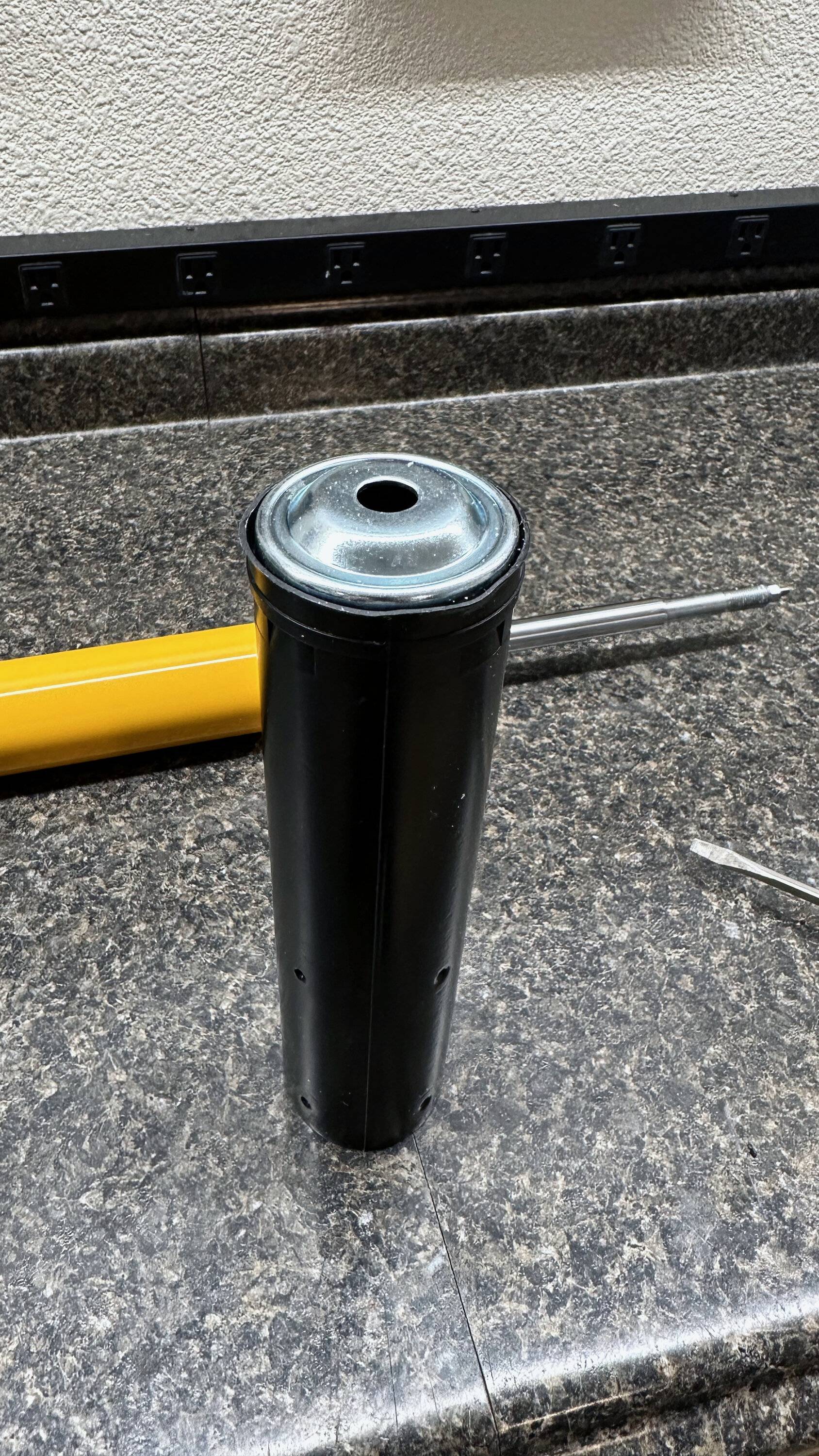

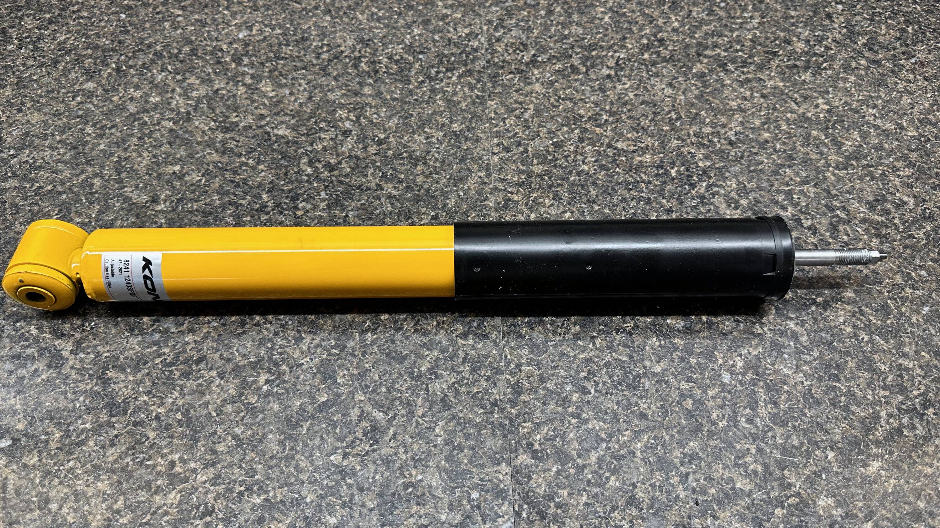

Koni shock as it comes out of the box

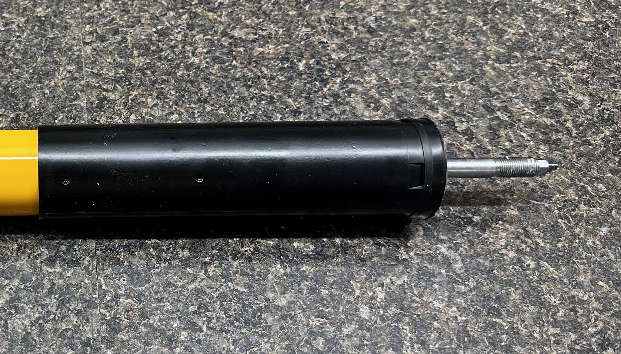

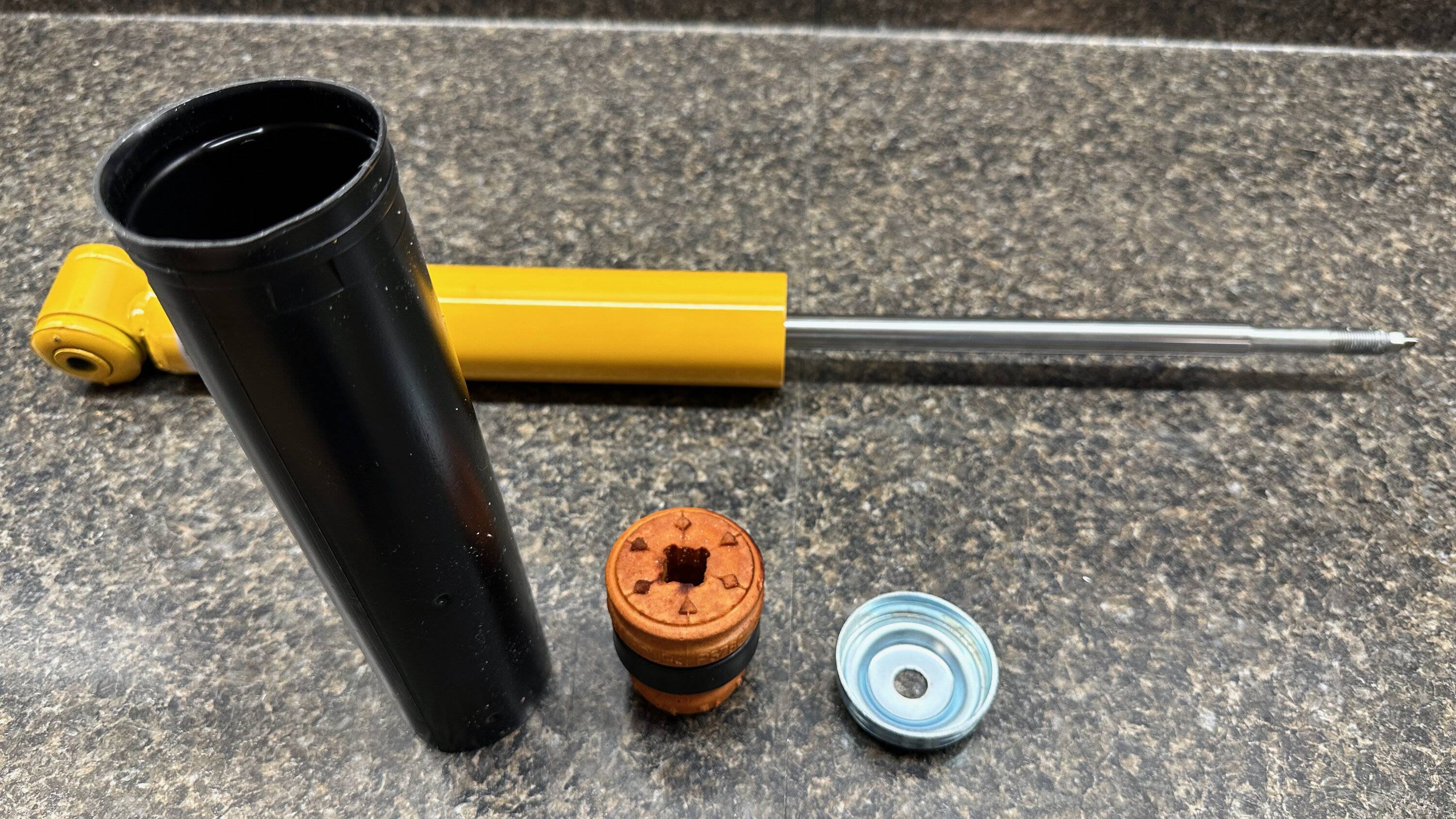

Slide the dust cover off the shock and with a flat blade screwdriver in the hole of the metal cap, pull it out.

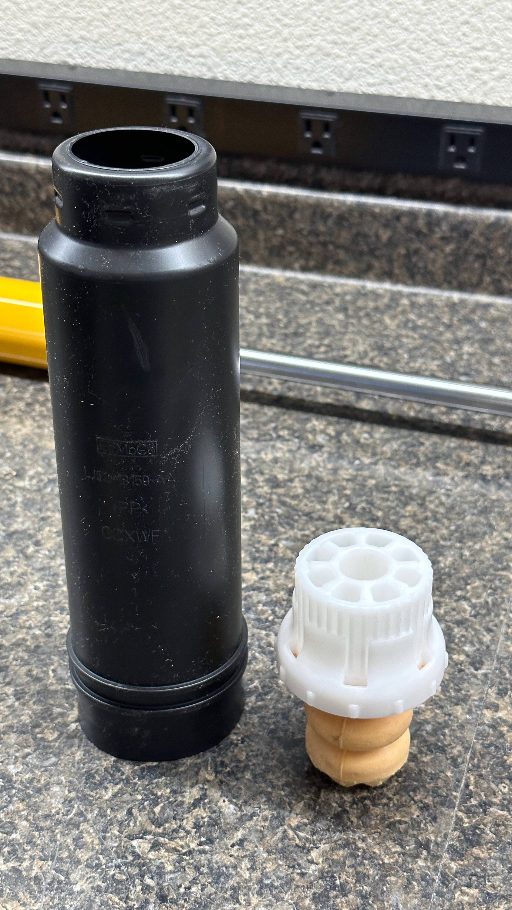

Steeda bump stops
Push the Steeda bump stop into the metal cap and snap it back into the dust cover.

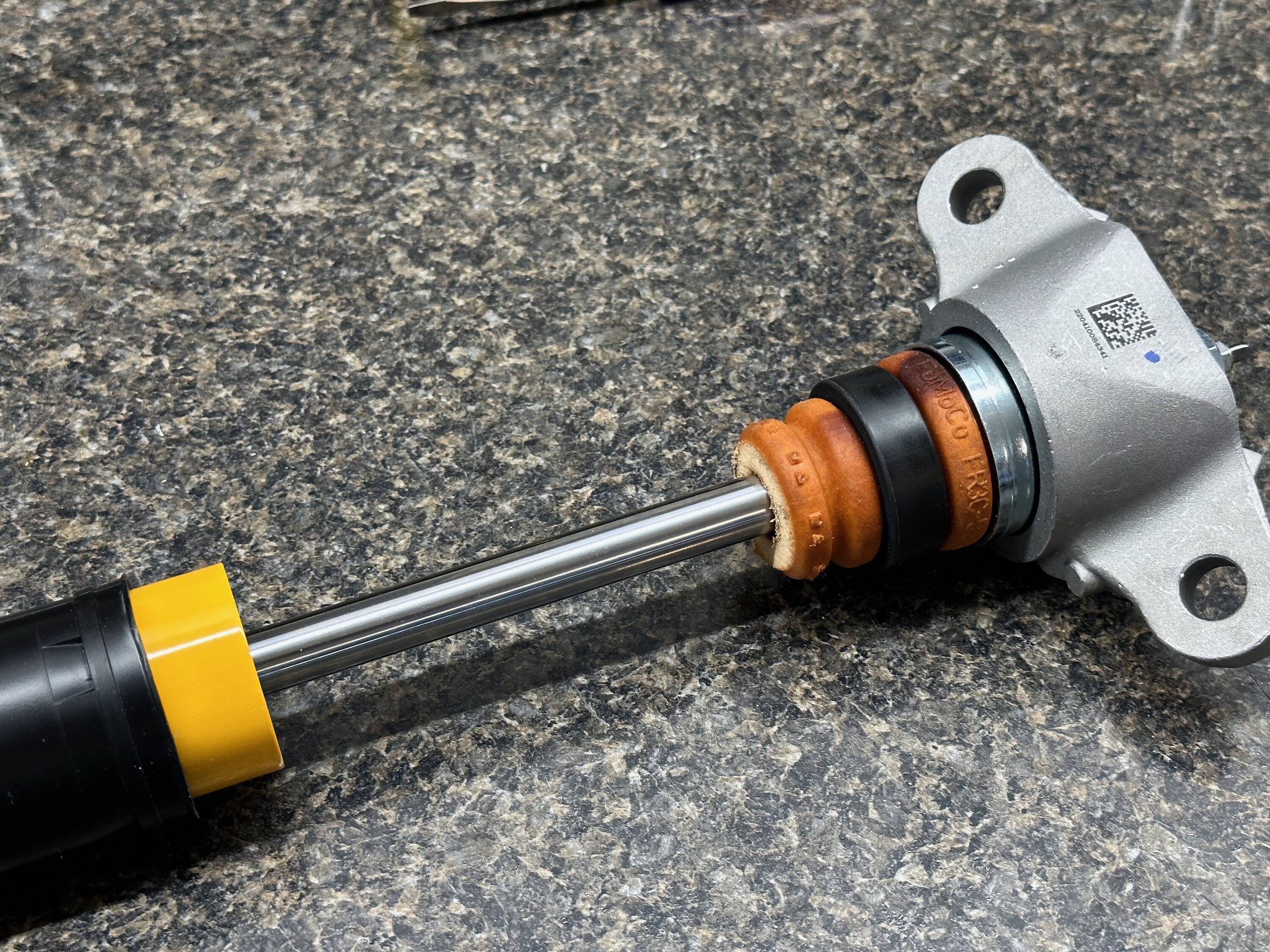

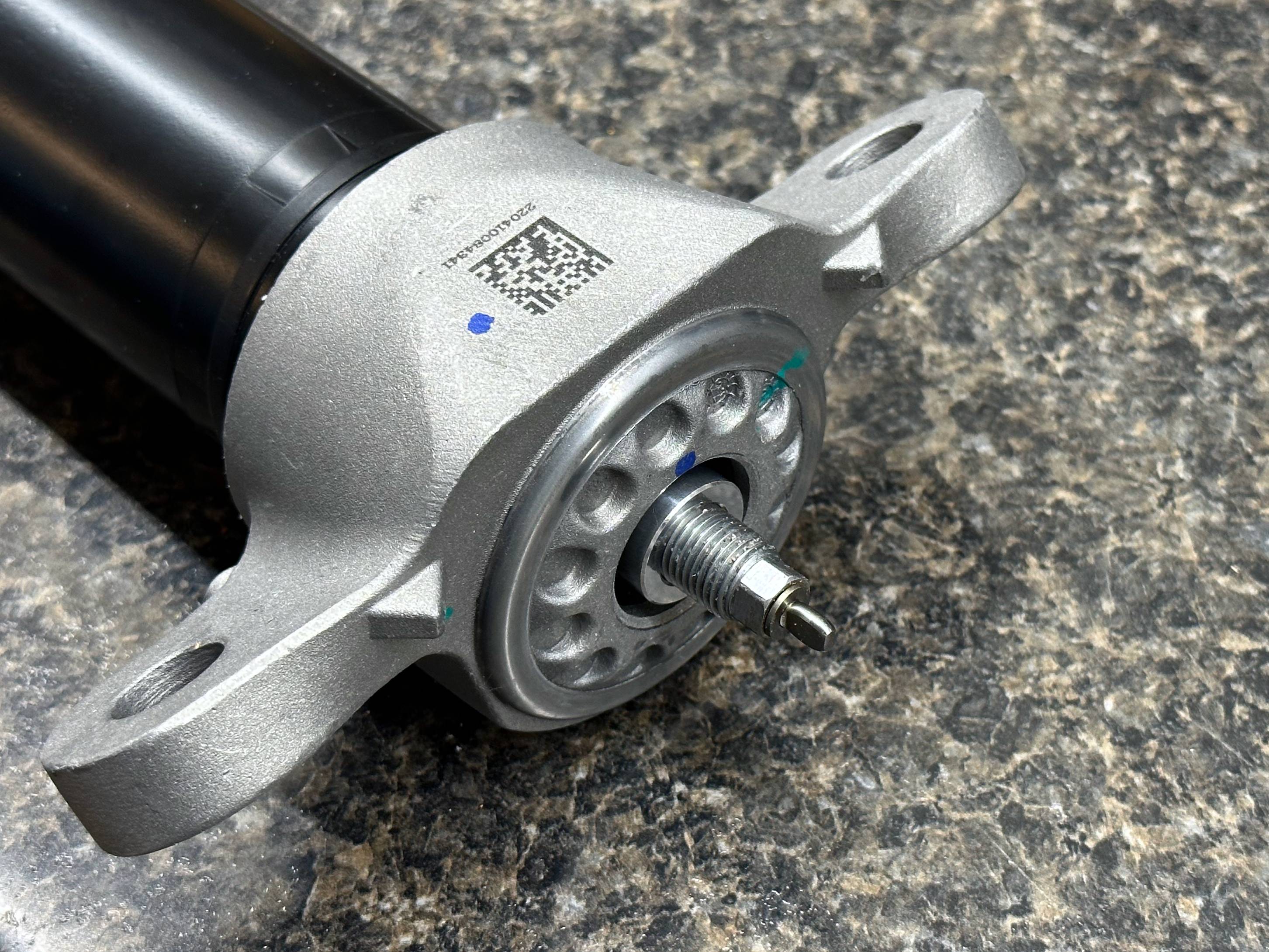

If you want to use the bump stop from the OEM shock, you need to remove the upper mount. Pry off the black cap on the upper mount and with a 13 mm socket, remove the nut from the inside of the mount. Lift off the mount and slide the dust cover off the rod.
Push down on the white plastic spacer at the top and it will fall out of the dust cover. Pull the bump stop out of the white plastic spacer and push into the Koni metal cap if you want to use this one instead of the Steeda.

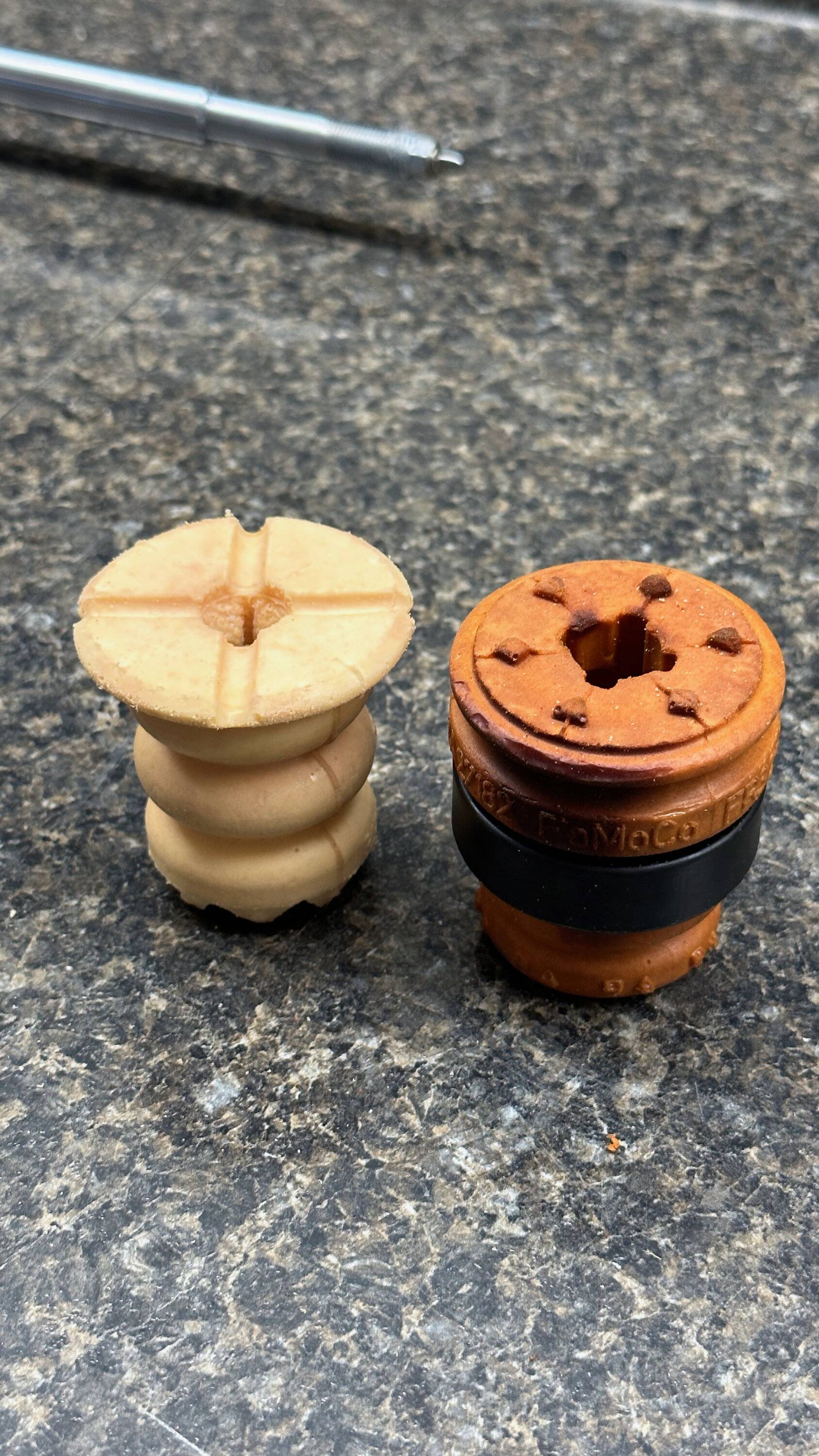

OEM and Steeda bump stops for comparison
Slide the dust cover back onto the Koni shock and push it down until the metal cap bottoms out on the rod collar.

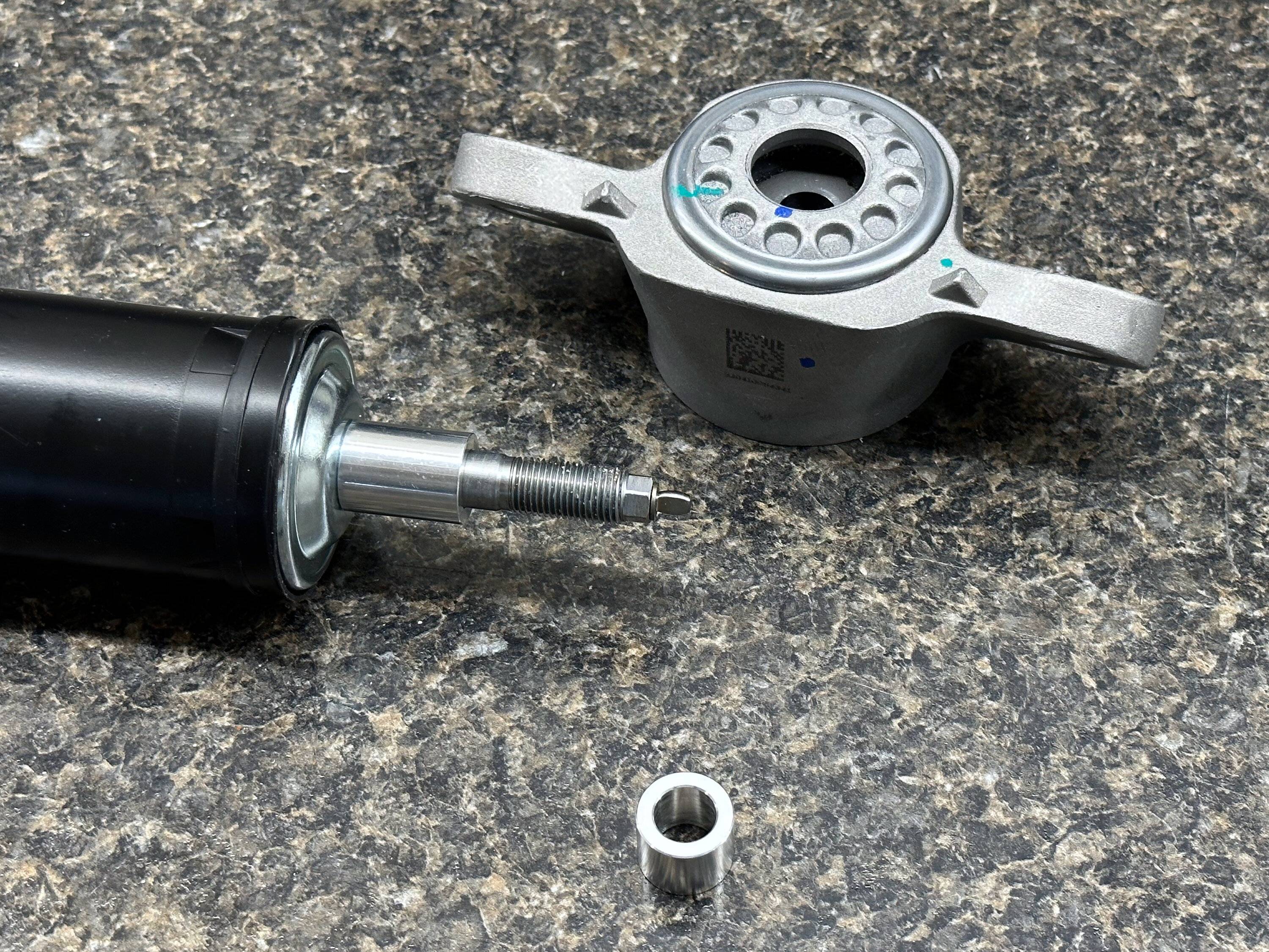

The hole in the upper mount needs to be enlarge using a 1/2" drill bit.
Upper shock mount with the two spacers needed to assemble
Slide on the 25 mm long spacer on the shock rod
Install the upper mount and slide the 15 mm long spacer over the shock rod
Place the lock washer and nut provided with the Koni's on the rod end. While holding the end of the shock rod (not the adjusting tab) with a 9 mm wrench, tighten the nut with a 19 mm wrench to 20 ft lbs.
When all tightened, you should have a very slight gap between the top of the dust cover and the bottom of the upper mount

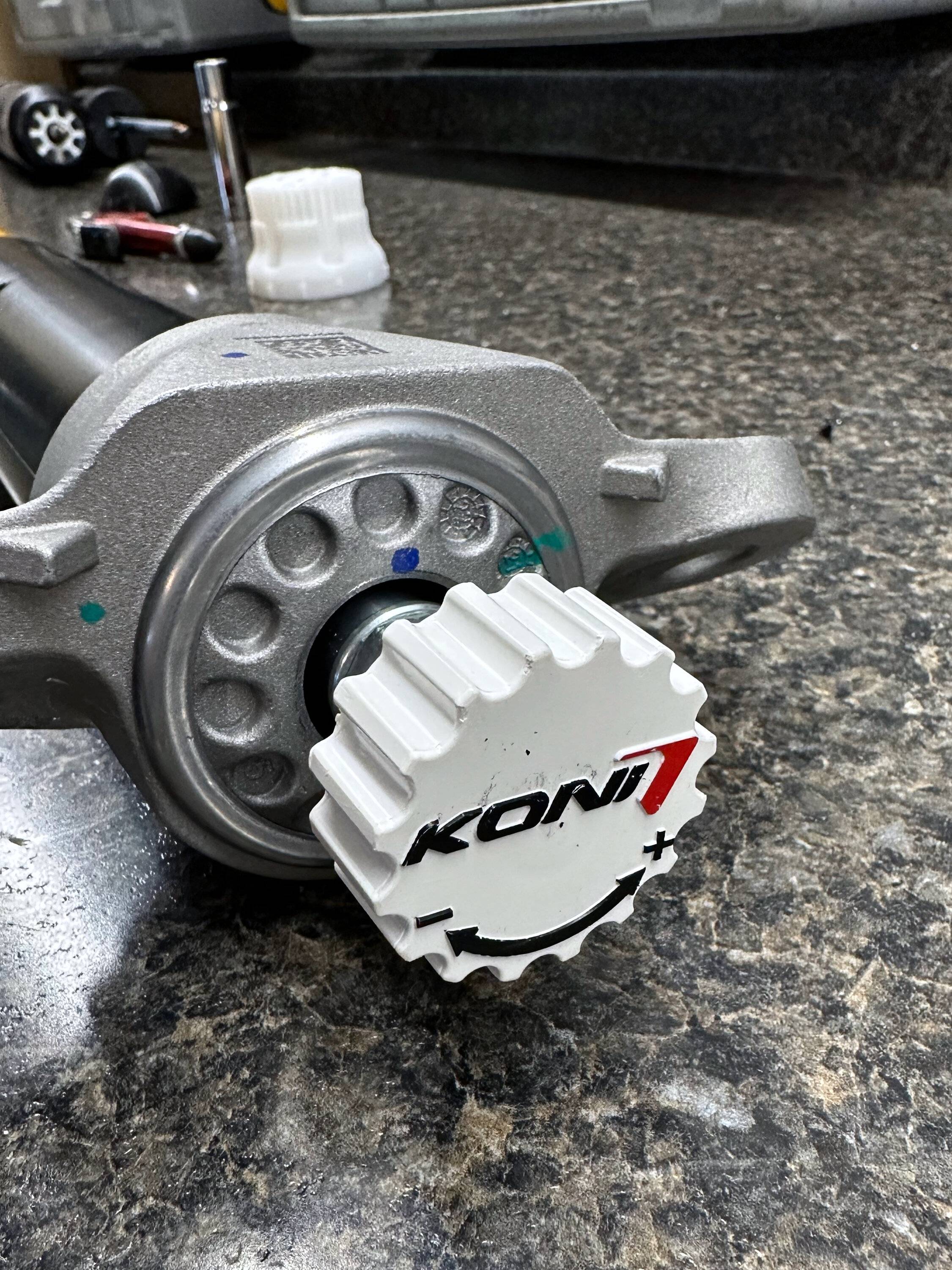

Take the supplied adjusting dial and turn clockwise (-) all the way until it stops. It is usually at this setting from the factory. Now turn counterclockwise (+) 2 full turns. This is the maximum rebound setting. Do not turn more than 2 full turns otherwise damage to the shock may occur.

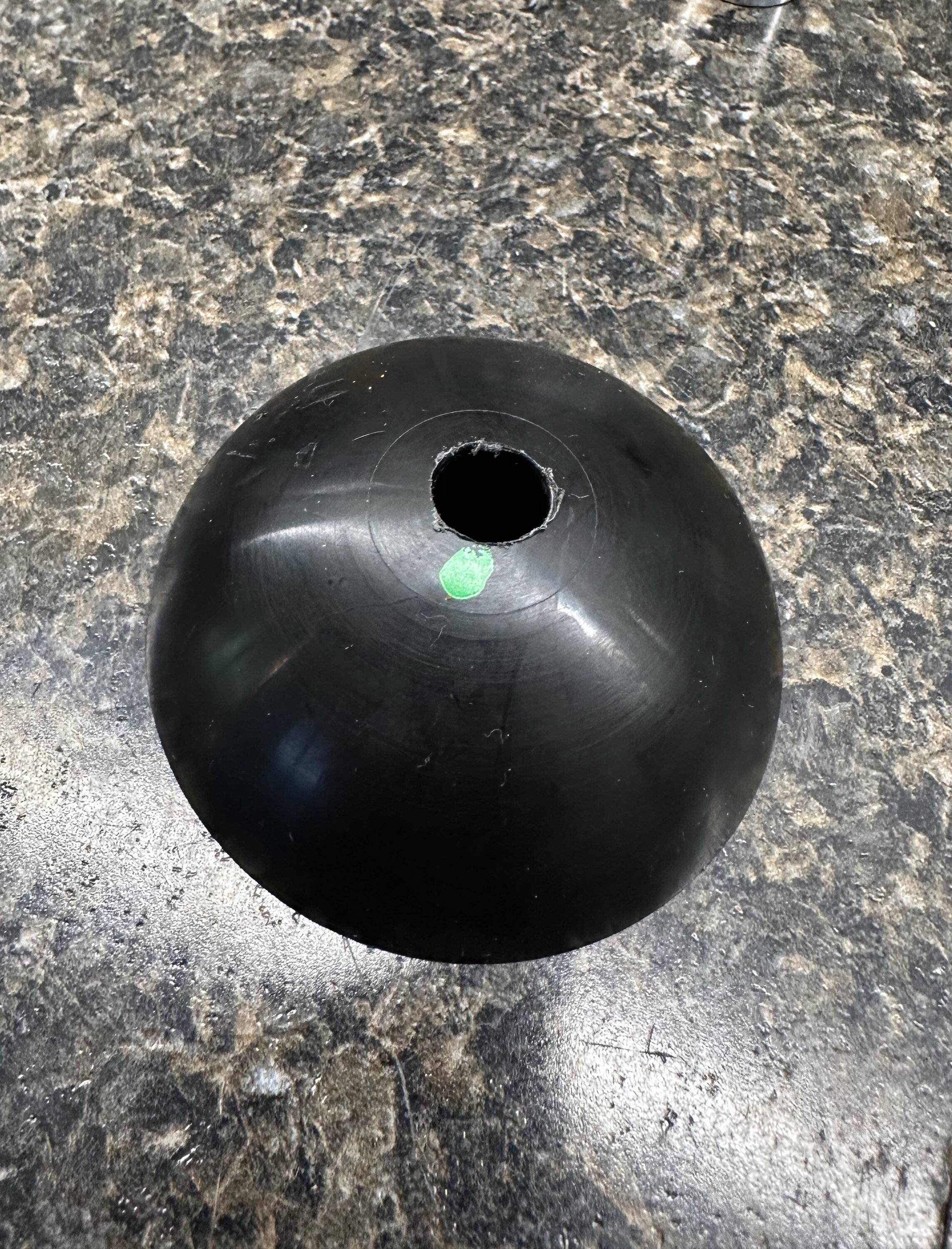

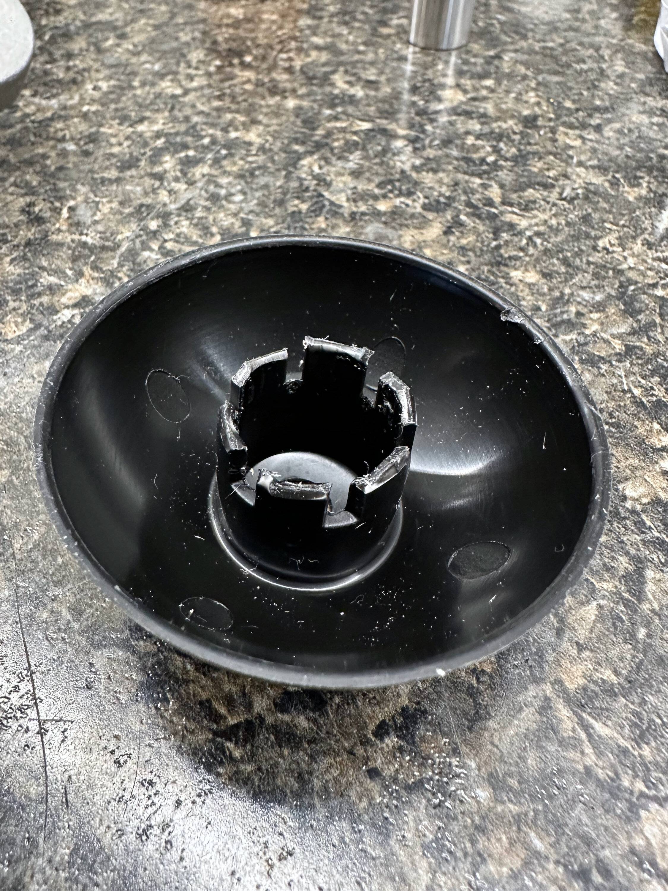

The black plastic cover on top of the upper mount needs to be altered to fit. First cut the tabs off just below where they protrude out. Then drill a 3/8" hole in the middle at the top.
Lightly push the cap on the top of the mount and then using a rubber mallet, tap on it to seat flat down on the mount. The adjustment tab will protrude out from the cap and is still able to be adjusted if you haven't done so already.

The two oversized stainless steel washers are needed to take up space on either side of the lower mount because of the slight gap between the lower mount and the lower control arm. Depending on the thickness of the washers you buy, you may need to use three, one on one side and two on the other. The bolt shown in the photo is the factory lower mounting bolt. I have placed it in the shock with a washer on either side to show what it should look like when installed. This is actually the tedious part of the install trying to place those washers in-between the lower shock mount and the lower control arm while sliding in the bolt. It takes a little finesse and sometimes a few choice words.

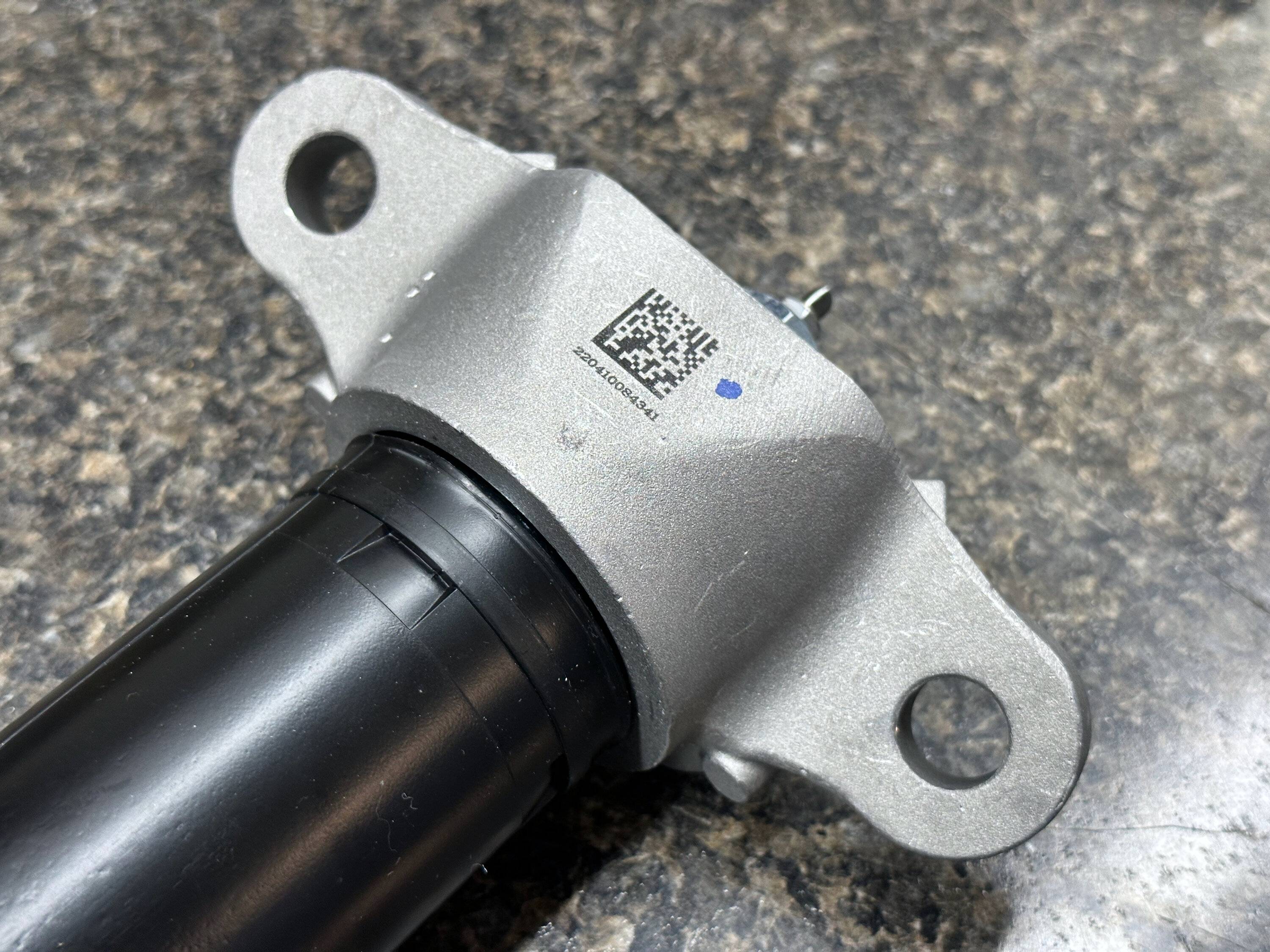

(2) Ford upper shock support PART: LJ9Z-18A161-A (not needed if taken from OEM shocks)

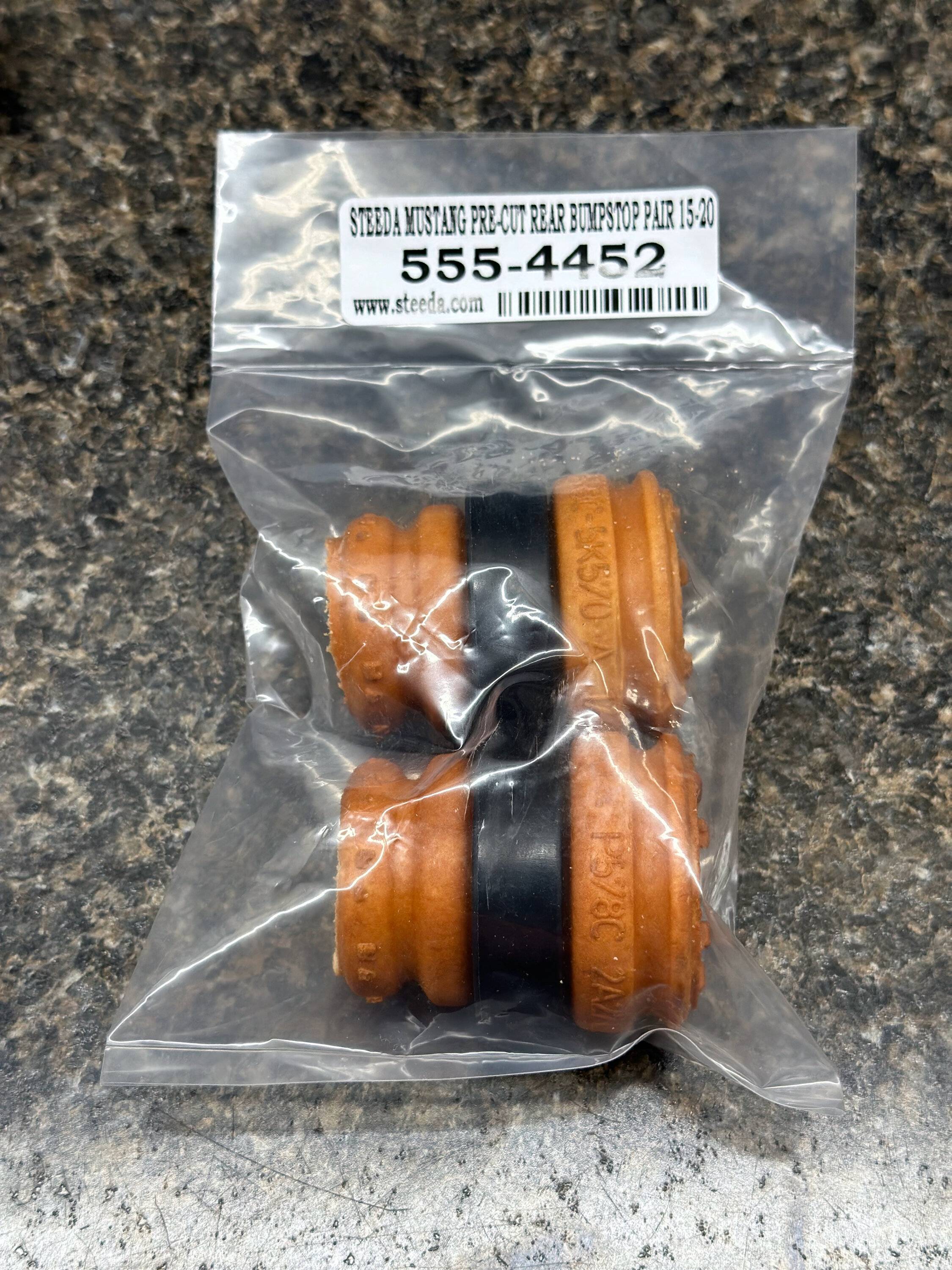

About the bump stops, I prefer the Steeda’s because they are heavy duty compared to the OEM’s, already cut to the proper height and fit into the top cap of the Koni dust cover cap better.

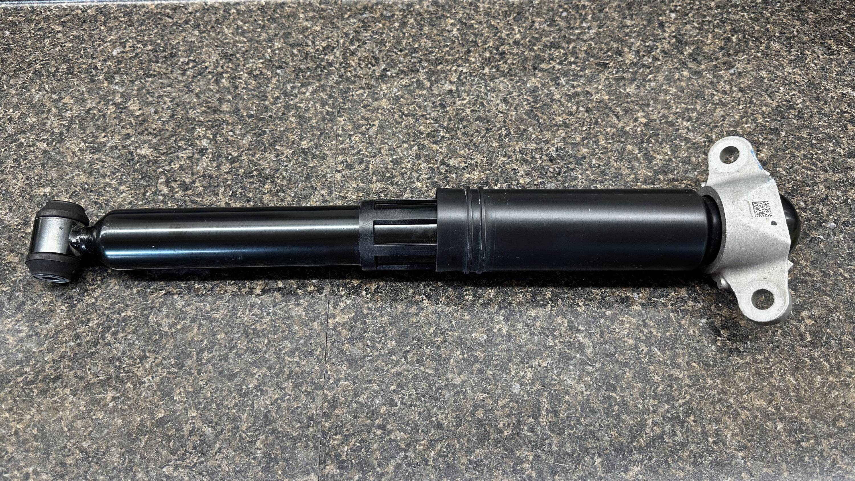

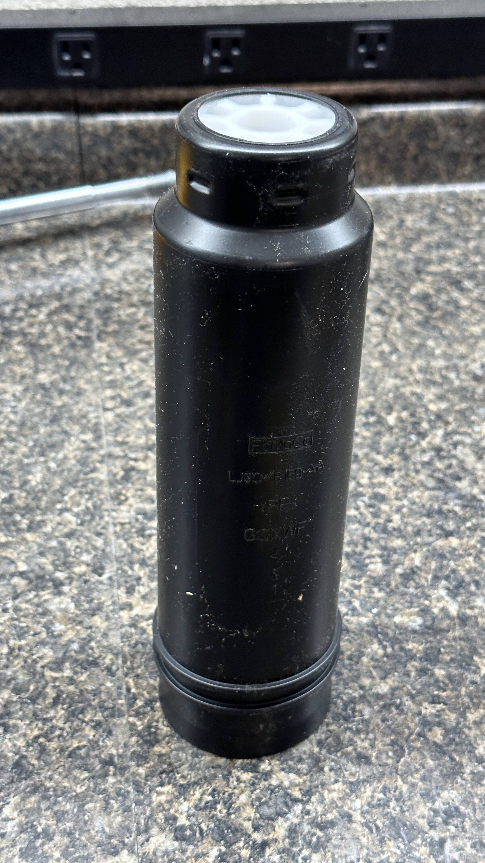

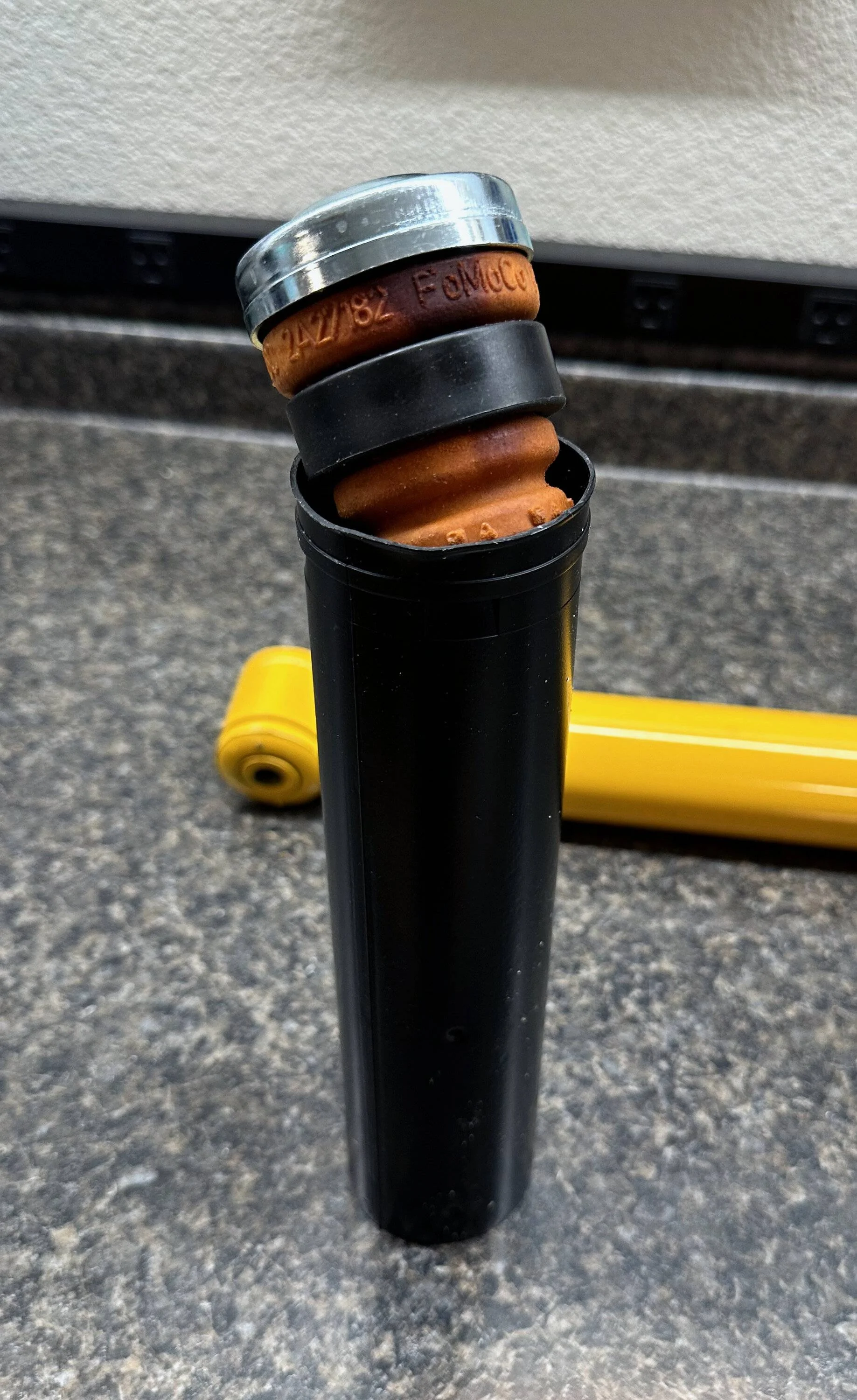

Steeda bump stops

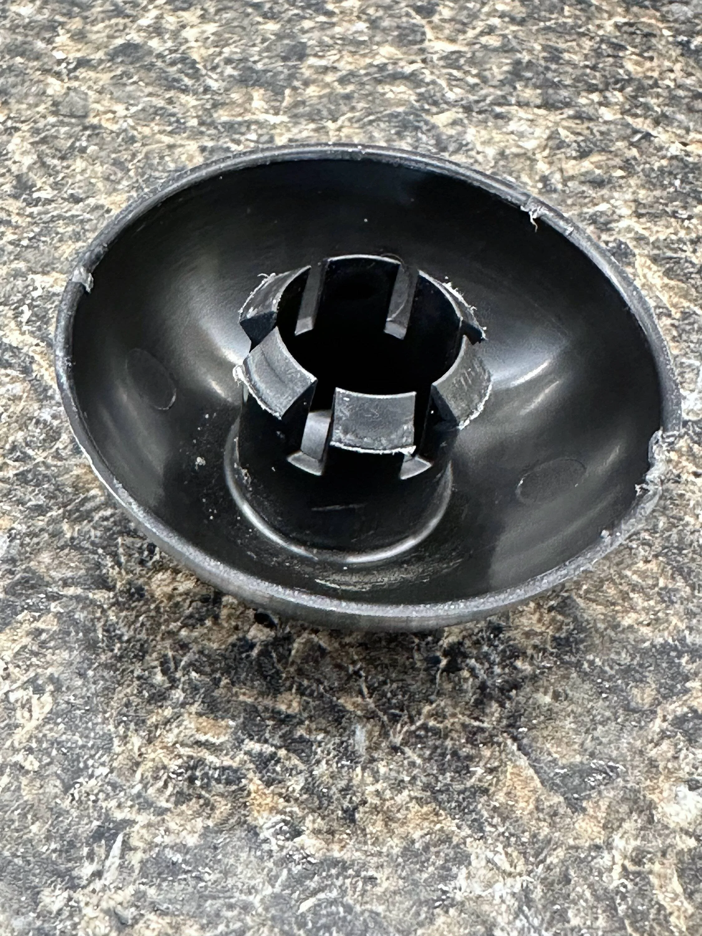

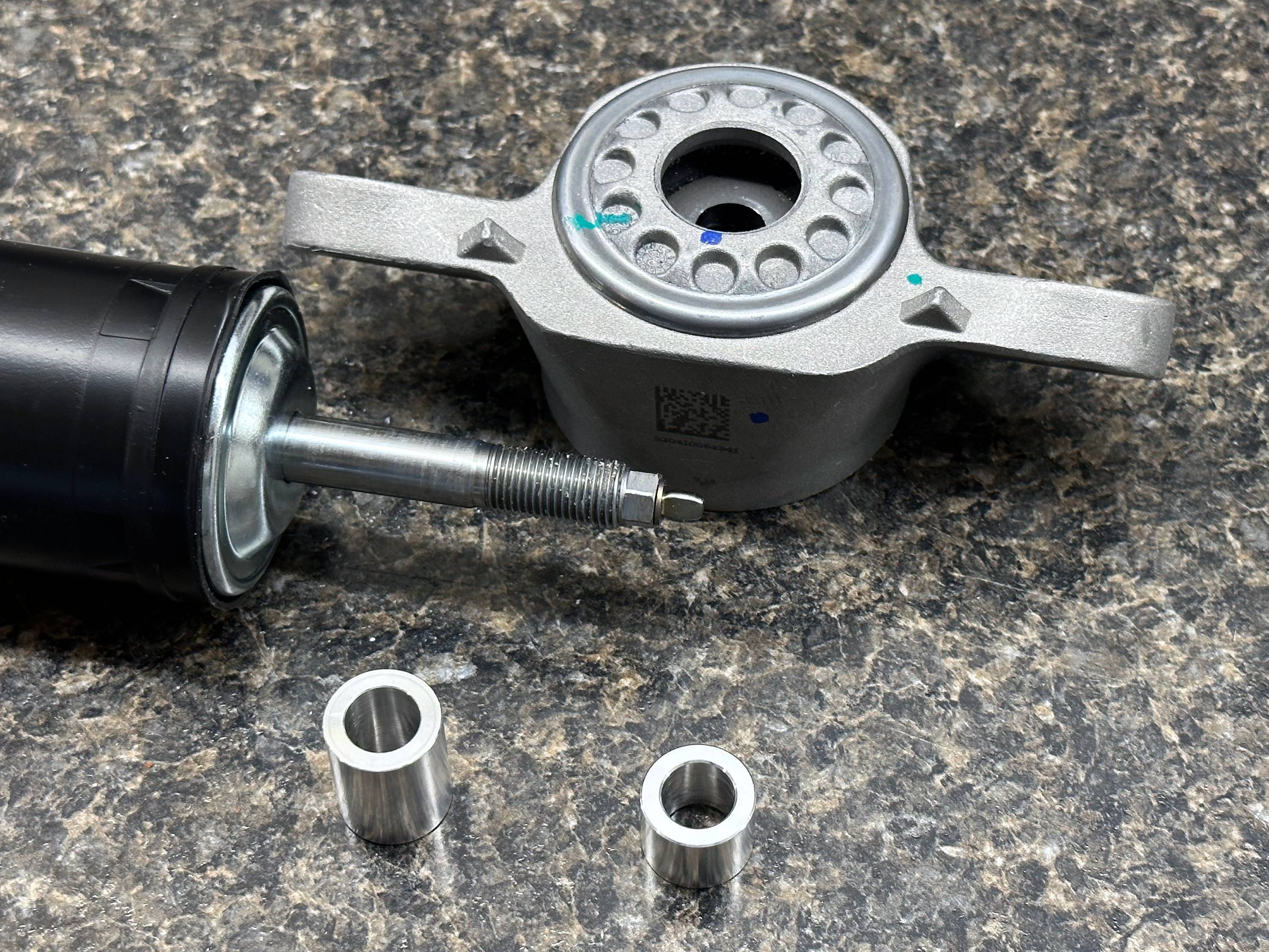

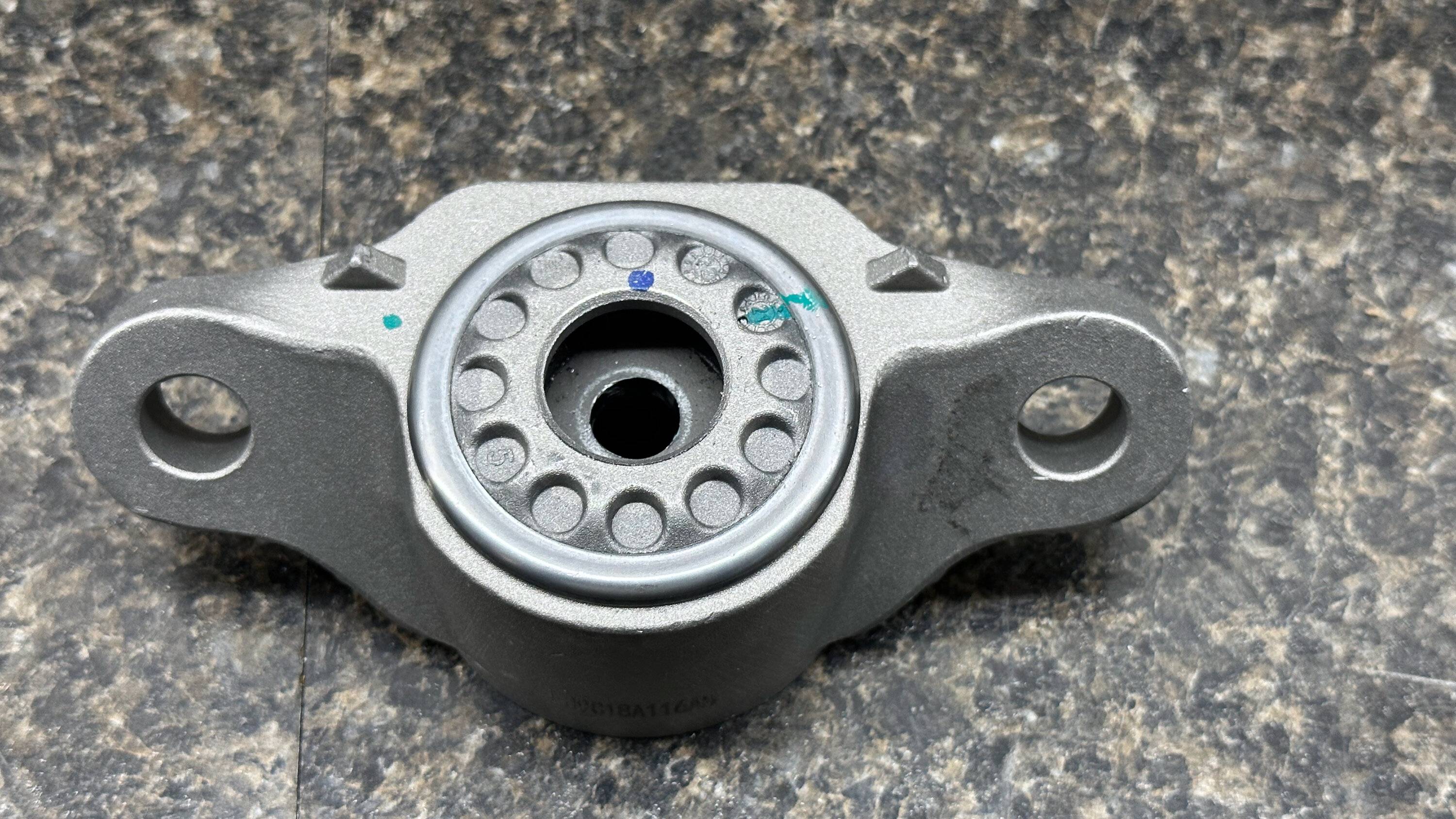

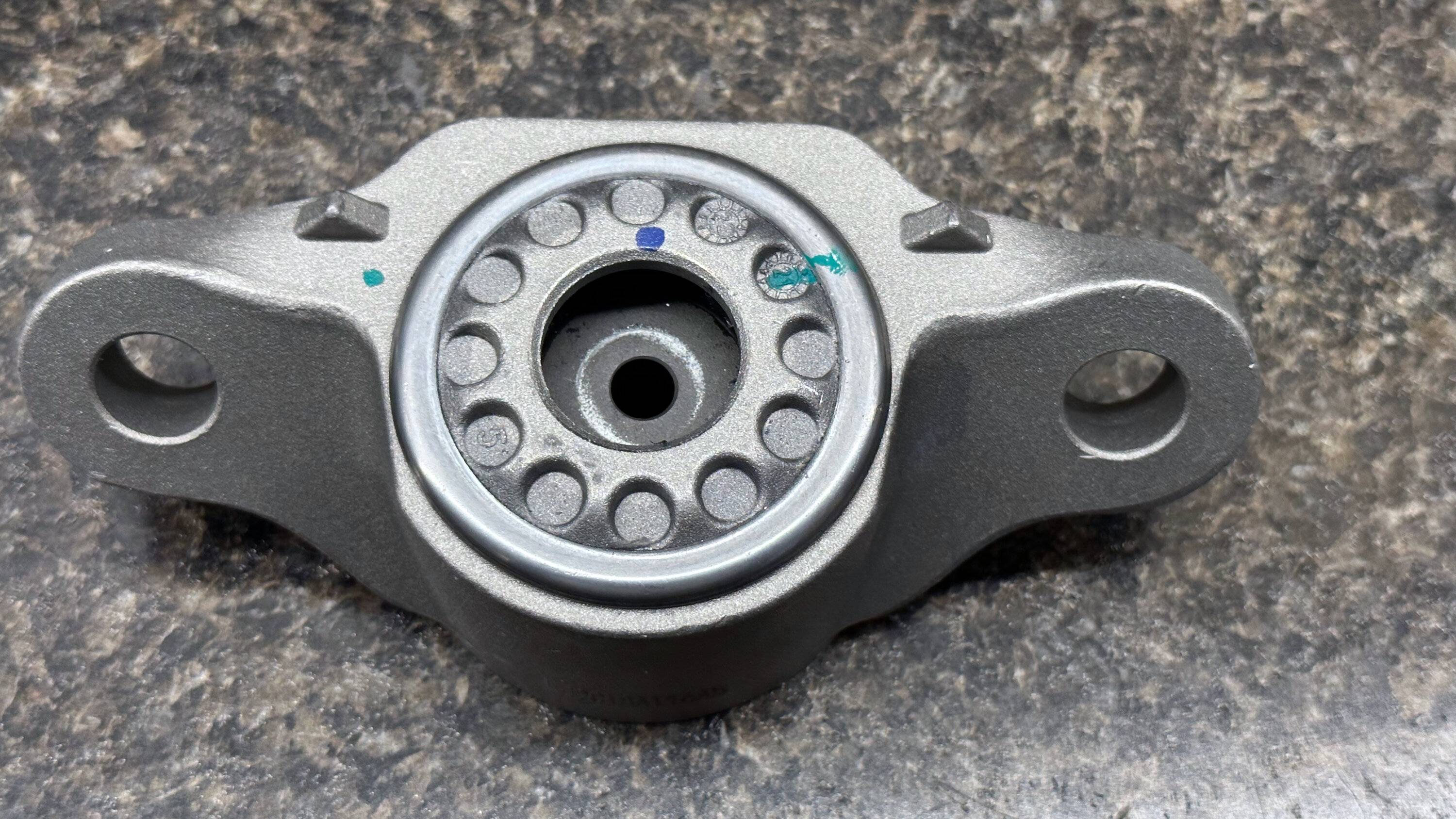

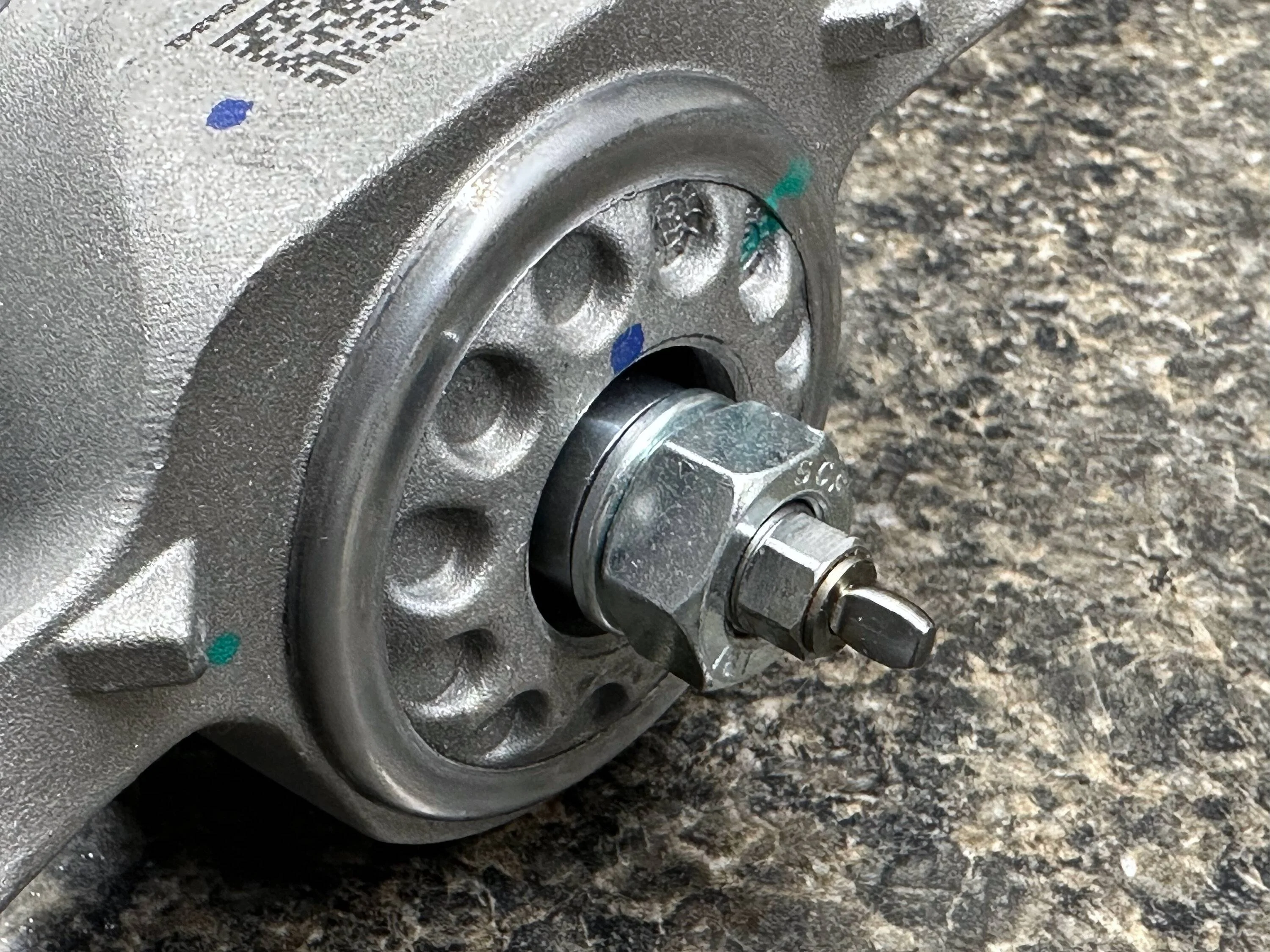

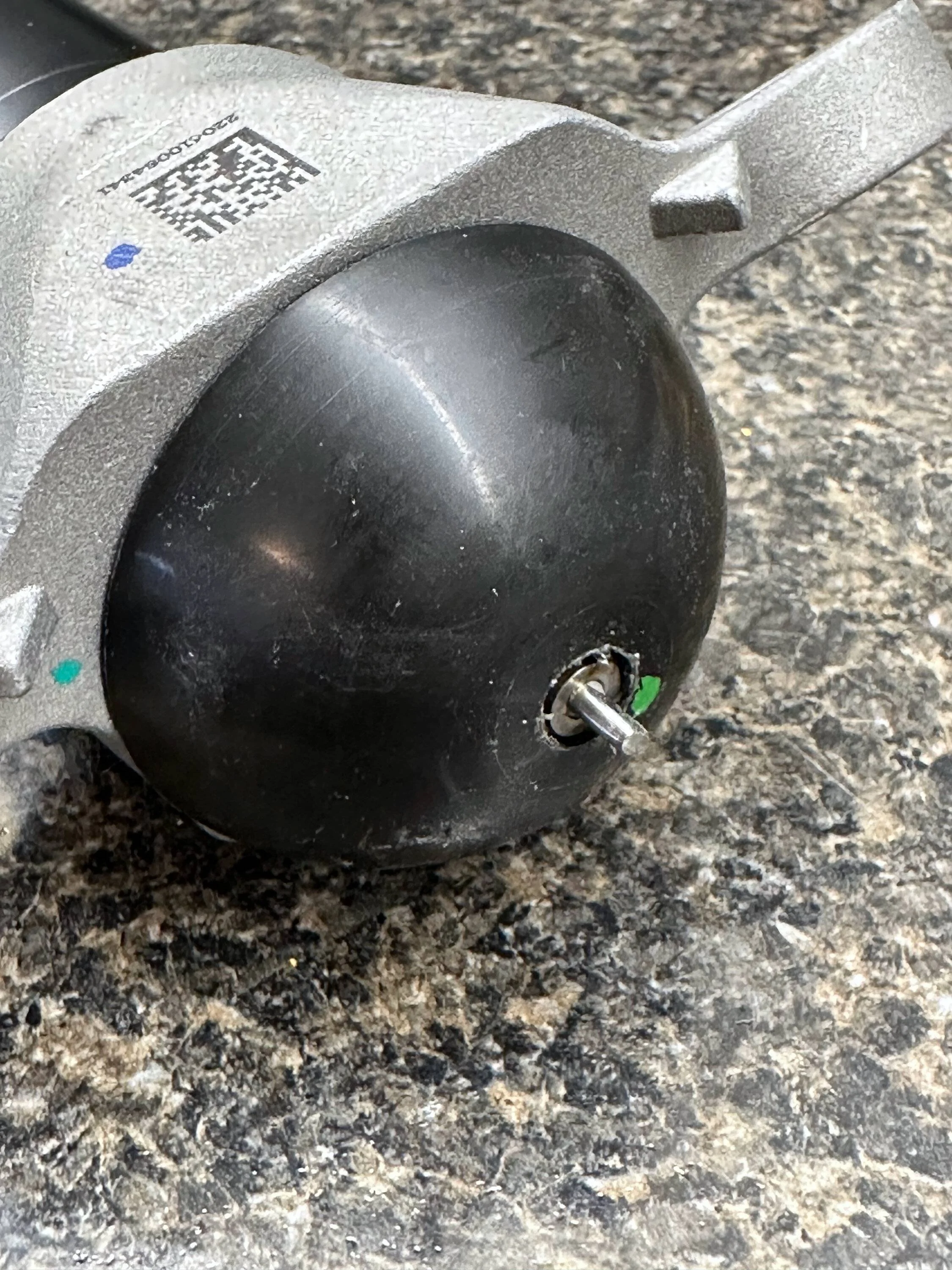

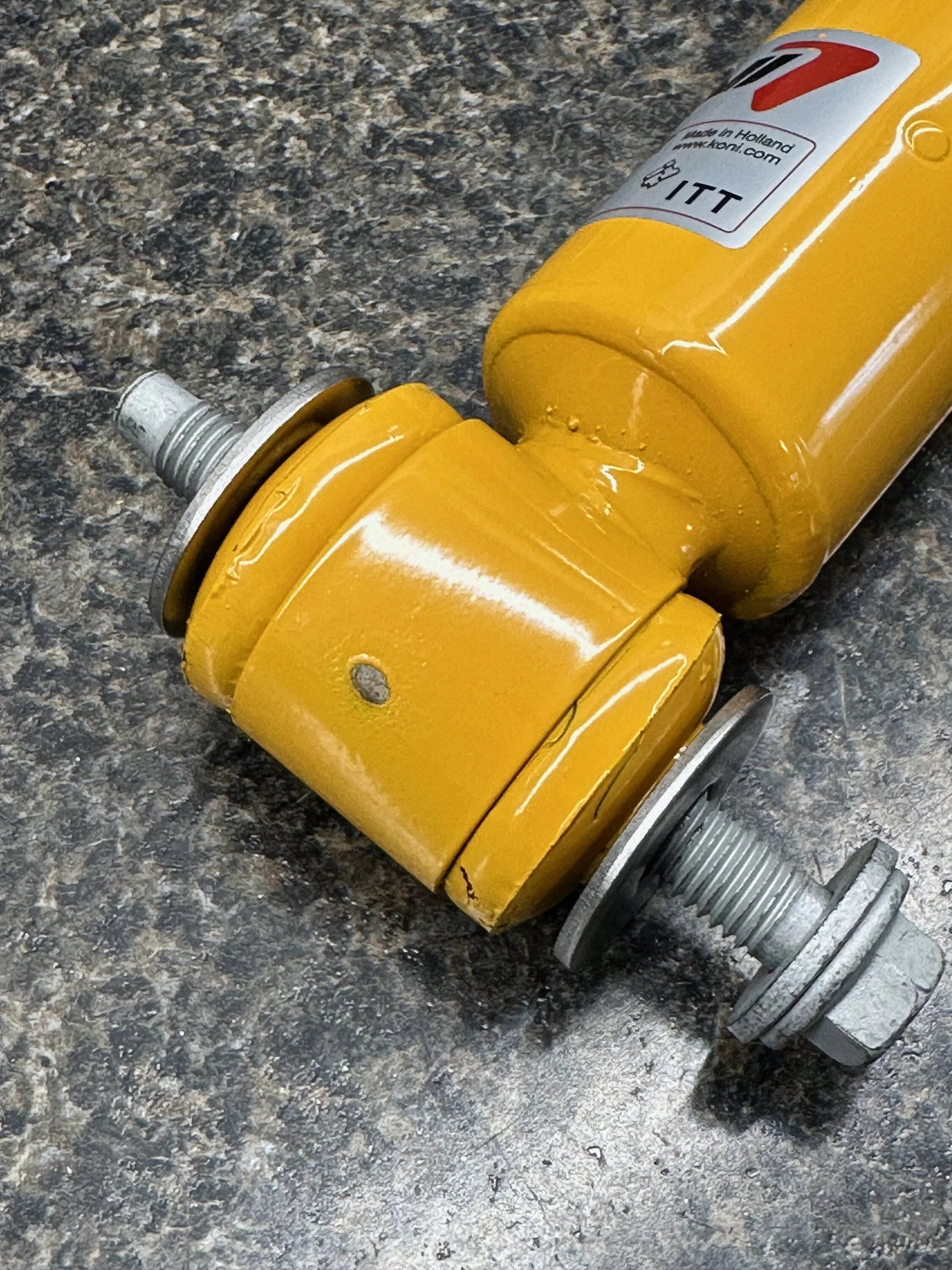

Wanted to mention about the adjuster poking out of the top of the cap. I could have used a longer spacer below the mount which would keep the adjuster within the cap and no hole would need to be drilled. The problem is there would be a 1/4" gap between the top of the dust cover and the mount for debris to easily get in. While this should not be an issue since the OEM shocks have a gap there, I wanted to minimize it.
To seal the area around the adjuster tab, I could have drilled a larger hole and put a small cap in the hole, over the adjuster but that is just one more part to find/purchase. Erik and Lee both suggested to just put a dab of RTV silicone over the adjuster tab after making sure it was adjusted properly. I don't show a photo with RTV silicone over the adjuster tab.
