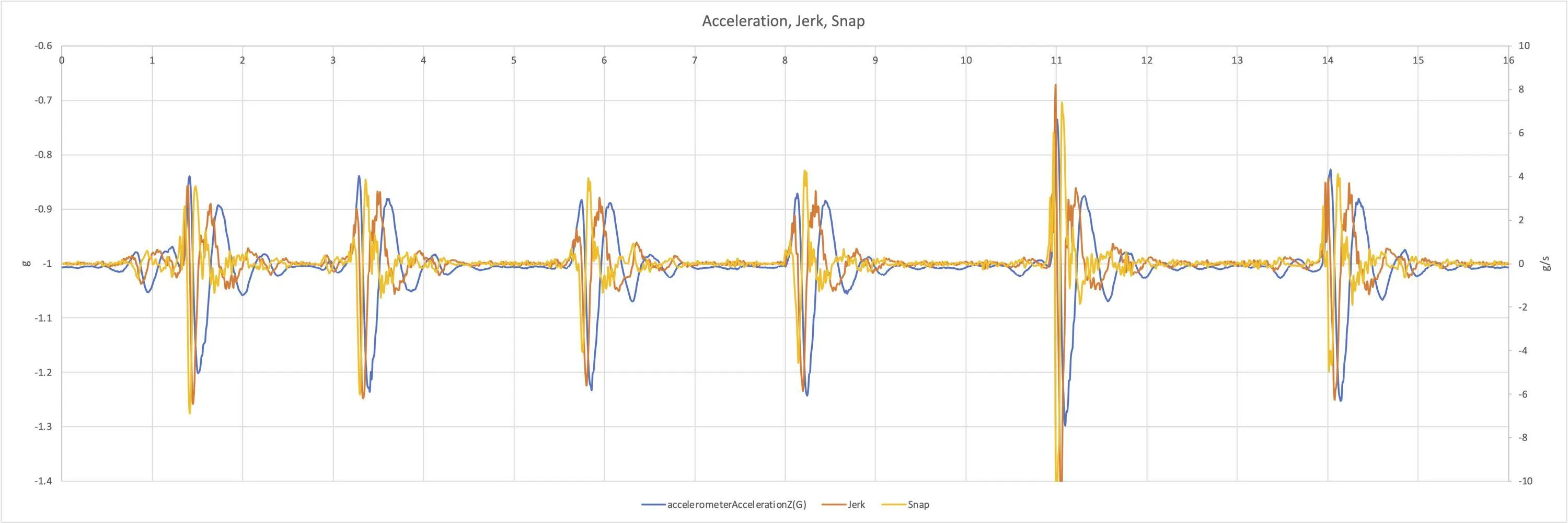

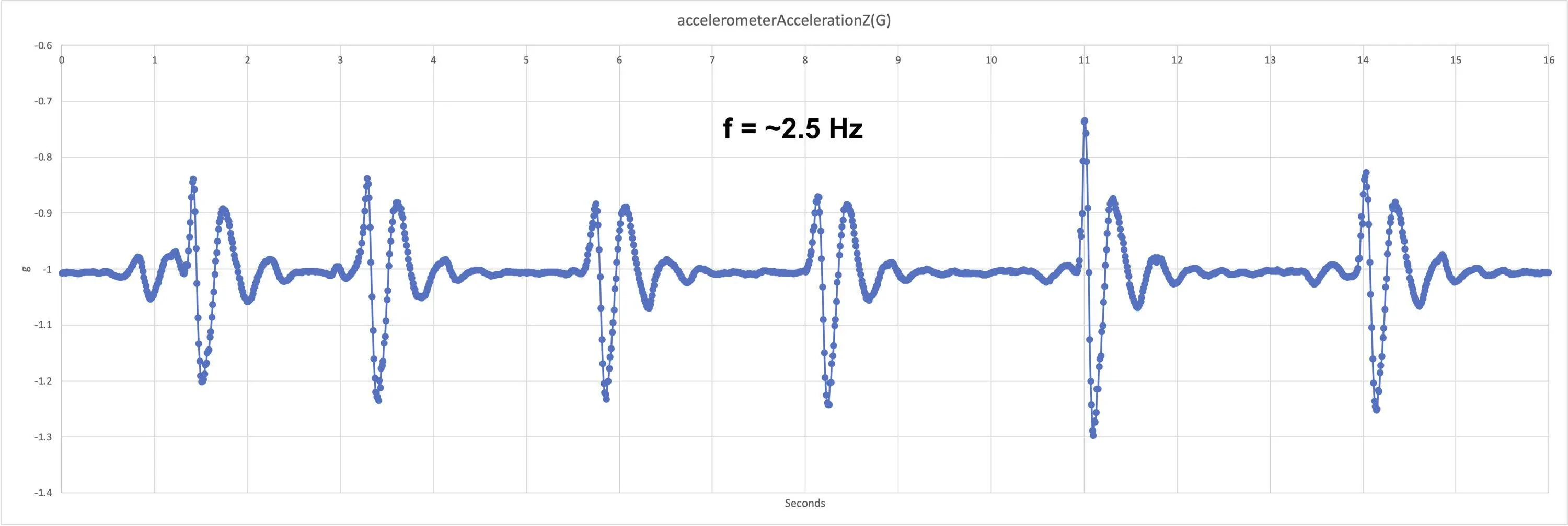

Alright, you guys got me excited so I decided to go body slam my Mach-E a few times for science:
Ford Mustang Mach-E UPDATED: Replacing Rear Shocks: Reducing the rear end bounce. Mach-E Suspension Bounc
That's 100 Hz accelerometer data. I put my iPhone on the trunk floor and then body slammed the tailgate briefly (immediately let up so it could rebound).
But holy cow, look at the valving. Rebound less damped than compression. You can also see the bounce afterwards, it's about 3 cycles long! Last, the natural frequency of the suspension is really close to 2.5 Hz, which is race car fast.
And for the nerds, here's a graph of jerk and snap (derivatives of acceleration). The data gets noisy but I can defiantly tell the rebound direction is more forceful than compression. Ideally the jerk decay should be balanced in both directions for optimal ride comfort.
Ford Mustang Mach-E UPDATED: Replacing Rear Shocks: Reducing the rear end bounce. Accel Jerk Sna
So some work to be done here. I'd be happy if I could get the valving a bit more symmetrical to slow the rebound, get the bounce damped in under 2 cycles, and slow the frequency down to 2 Hz or less.
I've also attached the raw data file if anyone wants to do more with it. Just change the extension back to .csv (forum doesn't allow .csv file upload).

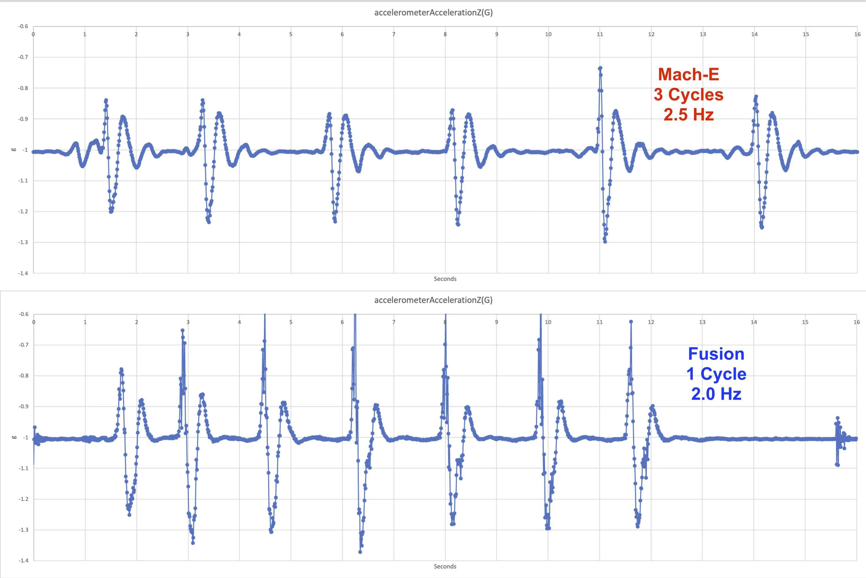

And as a follow-up, here's a comparison of the Mach-E to my old Fusion, which has a great suspension. Same exact scales.
Ford Mustang Mach-E UPDATED: Replacing Rear Shocks: Reducing the rear end bounce. Bounce Comparison
This shows how underdamped the Mach-E is. The Fusion damps everything in only 1 cycle vs. 3 for the Mach-E. The spring constant is less (car is much lighter) so there's more acceleration from my body force, but the bump is over with much faster than the Mach-E. The Fusion is the kind of graph we want.
You can see the Fusion damps everything in only 1 cycle. The spring constant is less (car is much lighter) so there's more acceleration from my body force, but the bump is over with much faster than the Mach-E. The Fusion is the kind of graph we want.
Thanks for these graphs Lee. Anton will be doing more testing with graphs like this. While I understand it is important to actually see what is going on, both of us were really more focused on what we felt. Anton has been driving his car on these roads for over a year and is very familiar with it. Any little change and he can easily tell and the only time the car just about stopped bouncing was when the Koni's were adjusted to the firmest setting. Even my magneride has a slight more bounce than the Koni's did. Going over several different sized speed bumps, again only the Koni't had one cycle. It felt just like my ICE Mustang. I can't wait to try the Bilstein's this weekend.

G-force data would be accelerometer which is what you would want. And ideally you should have the phone be mounted to the vehicle so that it is reading the vehicles vibration and not the phones where it might be bouncing a bit more freely
Yeah this is very interesting data and it makes things factually clearer.
For the record, both Sonny Boy and I came from Fusion Energis. His was a new 2013 and mine was a new 2015... I bought mine because I liked his so much. Both our Fusions just ATE the OEM shocks... he put Konis on his and I put Bilstein B6s on mine. His rear shocks were hand-compressible in about 30k miles when we took them off... not that he's a gentle driver haha.
My butt dyno (on my Mach E ER AWD Premium) completely agrees with your graphs. KW coilovers, albeit at a salty price, completely solved the Pony Pogo for me with their superior design with adjustable damping settings. I am still working out some KW-induced camber issues in the rear wheel set thanks to the altered geometry...

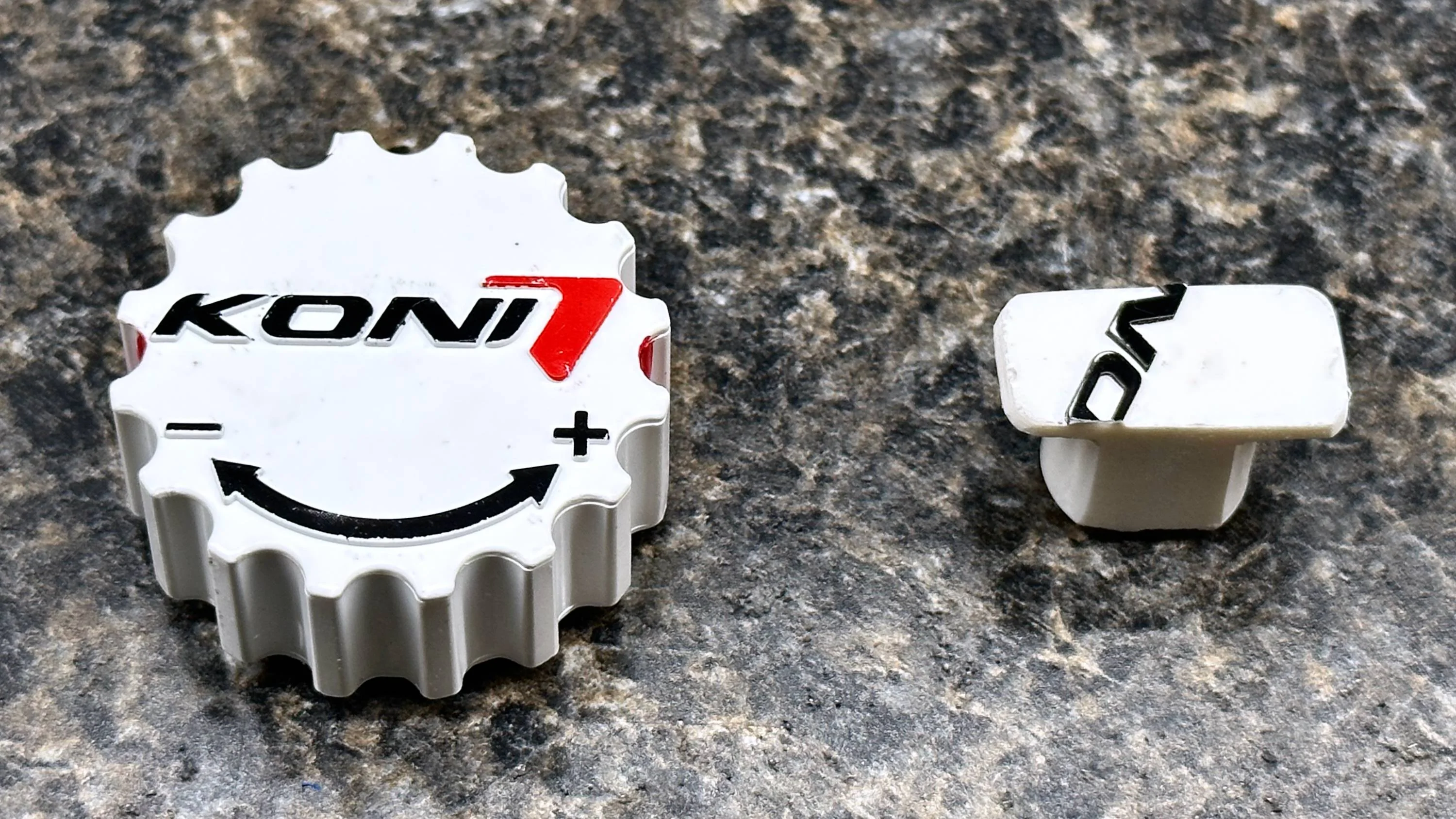

Yes Ken they can be. The Koni has a large round knob that fits over the top of the protruding stem. However that dial is too large to fit on the stem once the shock is installed. I took one of the Dials and cut it down into a square that any 1/2" or 13mm wrench can easily turn. In order to get your hands in there, you do need to lift up the car slightly so you have to use a floor jack but only a couple of inches. You place the now square knob on the top of the shock and with one hand you hold the knob down on the stem and the other using the wrench to adjust.
However, when we adjusted the Koni's, the closer we got to the most firm setting, the better the ride so I personally would not suggest anything less than that setting. And again, it only adjusts the rebound. The compression virtually stays the same throughout the entire adjustment.

Below is a photo of one of the knobs I cut down and at first I made it into a T but I then realized that would not work. I could only adjust with a wrench so I also cut down the T part and made it a square but never took a photo of it. I am sure Anton can snap a photo or I will this weekend.
