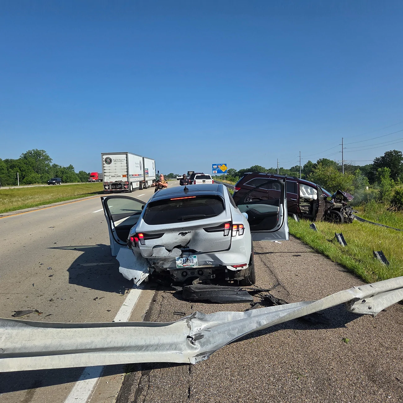

I've been using an Autel 48 amp for 3 years with no problems. Unfortunately our MME was totalled today. An idiot driving about 100mph ran into the back of our car that was on cruise at 67 mph.
My wife has a broken arm, clavicle and sternum. I had bruising to my ribs and leg.
The kicker is I had a cat scan done and the Dr. said I have a tumor in my kidney and it will need to be removed. What a day.

I’m glad you two made it out alive. That’s the most important thing. Everything else can be fixed, dealt with over time

What an awful day!!! I hope you and the wife mend up quickly and just glad everyone is alive!!! Thank goodness the MME is such a "tank" or it could have been worse!!!

Wow! Usually those minivans are the ones doing 50 in the left lane. Glad you survived it. I had a friend who had a similar situation but on a bike. He crashed, broke some ribs, road rash and, oh yeah, a tumor on his kidney. He considered it a fortunate accident as he had no symptoms and would never have known about it until it might have been too late. He had it removed and all was well for many years. Hope everything works out for you. Get well!
