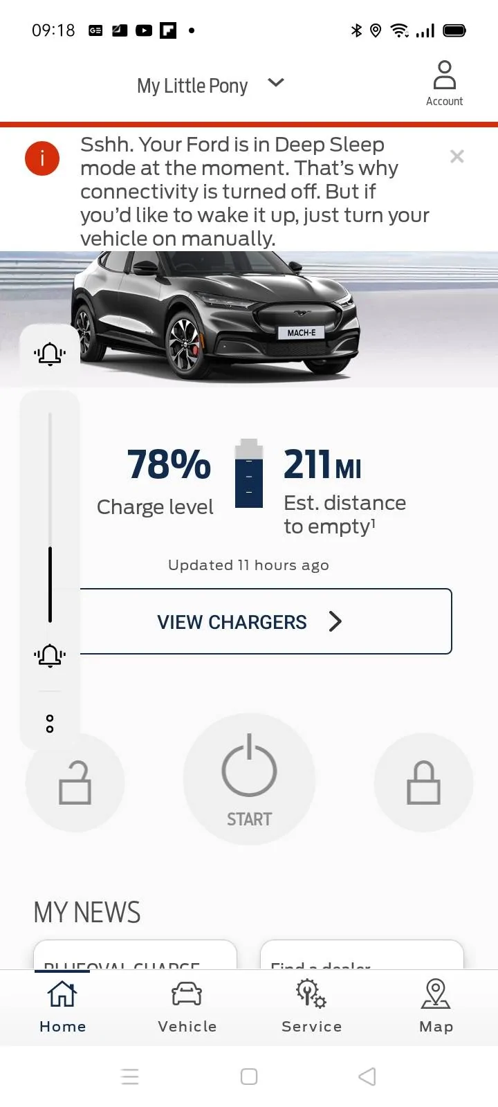

This is a screenshot of Ford pass app that I get when car has been parked for about an hour all the functions freez and do not work

I realize that it shows up for some in FP. I have never seen it myself and I searched the forums and can't find a picture of it. People use the phrase for the sleep that occurs at 1 hour all the time on this forum, so again, it's just a misuse of the phrase based on what Ford claims deep sleep should be.
I see the term regularly in FordPass if I try to interact with the car through FordPass if the car has sat unused for more than a day or two. It’s been that way since new.
Thanks for sharing the screenshot.
My wife talked me out of taking my MME to the beach last week, so it has been sitting at home in my garage of almost six days now. It is not plugged in because I was worried about what could happen if a thunderstorm came through (which one did, BTW) and we got a power surge from a lightening strike.
Anyway, my car has been unplugged and sitting for six days and I do not see any message in FP about sleeping. The information has not been updated for five days, but if I send an unlock command, I will probably get an update.
I have never seen that deep sleep message you have.

That's the problem when that message is displayed I can't communicate with the car I have to go and sit in it and press the start button it will then be ok for about an hour or so and then go back into deep sleep apart from that the car is great
Do you have Phone as a key set up?
I’ve definitely seen Deep Sleep, but not this message worded like that. Mine is something similar like your car is in deep sleep, remote functions have been disabled to save battery. Are you in the US?

No I am in the UK no I do not have my phone set up as the key .

Yes, thank you for the screen shot.
I left my car for 10 days and never saw anything like this. Very strange how some of us have it and others don't.
This is one that I would agree that the dealer would have to work out. I'm curious if they looked at the versions of the communications modules to see if there's any updates available. I assume they would, but I can only imagine it's a software issue. Not sure how hardware would cause this.
Could you provide more information on your car. Model year, trim etc? Maybe even DM me your VIN so I can take a look.

After doing a bit more research into this it looks like there's an SSM 50751 issued for UK customers who experience this. As I suspected it was a TCU (Telematics Control Unit) software bug. The OP however has a fully updated TCU, so I'm not sure why he is still having the issue. The dealer did attempt a number of times to re-program the TCU and it would appear that, although the programming was successful, the result has been unsuccessful. I would assume they might be replacing the TCU in the end.
See here:
https://www.macheforum.com/site/threads/uk-customers.588/post-419900
See here:

Could not find any information in the UK version of the manual for Deep Sleep mode FYI.
