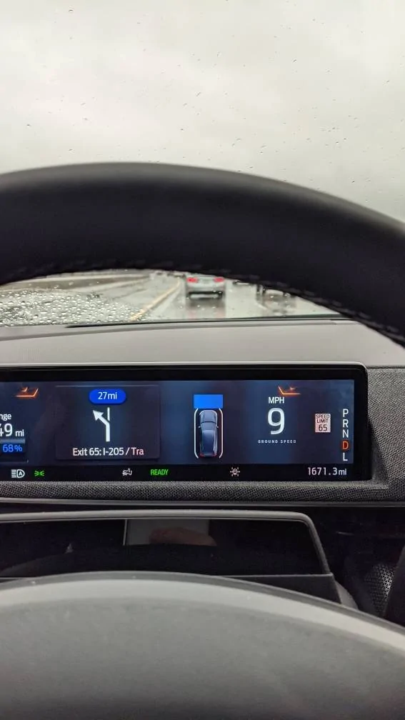

A while back I wrote a thread about BlueCruise and a question from @RMoore was asked of me regarding inclement weather and Lane Centering. At the time of my BlueCruise trip the weather was perfect so I responded to him with my experiences using Audi's version called Lane Assist. I gave him my very favorable review of Lane Assist and touted how much I loved it. This topic also came up previously here.
Today I was driving from the Bay Area (CA) to Sacramento (CA) and we had an unusual amount of rain. Yes, I realize that us California's probably think .0005 inches an hour is a torrential downpour, no comments needed. I noticed how poorly lane keep assist was handling the conditions. It was really having a hard time, going from a lane lock to nothing, non-stop. Even at very low speeds it wasn't able to grab clearly visible lane markers.
Later on in my drive I was presented with rain again and it did better, but still had issues.
I welcome feedback on what your take is here. Since many other people have had their vehicles much longer, how was your experience in the rain?
Ford Mustang Mach-E [Video] My Experience with Lane Keep Assist & Rain PXL_20211024_174210755.MP

Just a quick note of clarification here. It looks like what you were using there was lane departure assist, and not lane centering. There's no way on the mach e to have lane centering turned on without some form of cruise control.
As far as my experiences, yesterday in Utah we also had pretty heavy rain. I had Cruise with Lane centering on and it did very well. Once it got heavy enough it was actually my radar that started cutting in and out, but the lane centering kept going like a champ
As a side note, this is after doing the IPMA update in FDRS.. Before I ran that update lane centering was non-functional in these kinds of conditions

In your video, lane centering is NOT active. That is lane keep assist.
When lane centering is active, a "bubble" appears around the sides of the car instead of vertical lines.
It looks like you did not have cruise control active? On this vehicle, lane centering can only be used in conjunction with cruise control.

Thank you both I changed the title. And that would explain why @JohnnyForensic was probably confused. My apologies. Why they change the name when it's used in conjunction with cruise and without is quite strange especially since with BC you have no option to disable it, nor would you want to...

Well it's not just a name change. Lane centering does as the name implies and keeps you centered.
Lane departure doesn't kick in until you're about to cross over a lane line. At which point it'll bounce you off of the line.. if left unattended, that will just ping-pong you back and forth between the lines.
That being said, it is odd that even that was going back and forth between green and gray.
If you would like, you can send me a DM and I can check your VIN to see if you still need the image processor update

Thank you. I guess I just assumed it was one in the same. My other vehicles called it the same thing regardless of if it was activated with cruise or without. Interestingly, Audi gives it a different name, but only for low speed, similar to Ford's "stop and go" language via the link you sent. I understand the fundamental difference in language, but even without any form of cruise on, to me at least, it feels like the car handles the centering, if you will, the same as when basic ACC is enabled. The only time I noticed a difference was with BC enabled, which will even ping-pong me around every time I hit an expansion joint, but the centering with BC feels more enforced.
