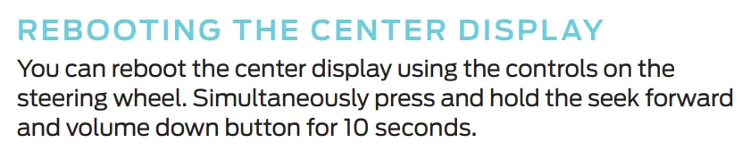

Have you done the Sync reboot? i.e. hold volume down and next track on your steering wheel at the same time until the center screen goes dark
OMG! Thanks so much! I’ve been scouring the Internet for a solution for this for my brother’s Mustang and this reset worked! Neither the button or the wake word worked! Thanks again!!!
Ford published the "reboot center display" instructions starting with Quick Start Reference v3, published 1/26/2021. They may have moved this into the full owners manual for later model years, though. This is from the thinner, full color pamphlet that's packed with my vehicle's supplemental owners manual in the glove box:
Ford Mustang Mach-E Voice Prompts Stopped Working 1722142527680-vc
