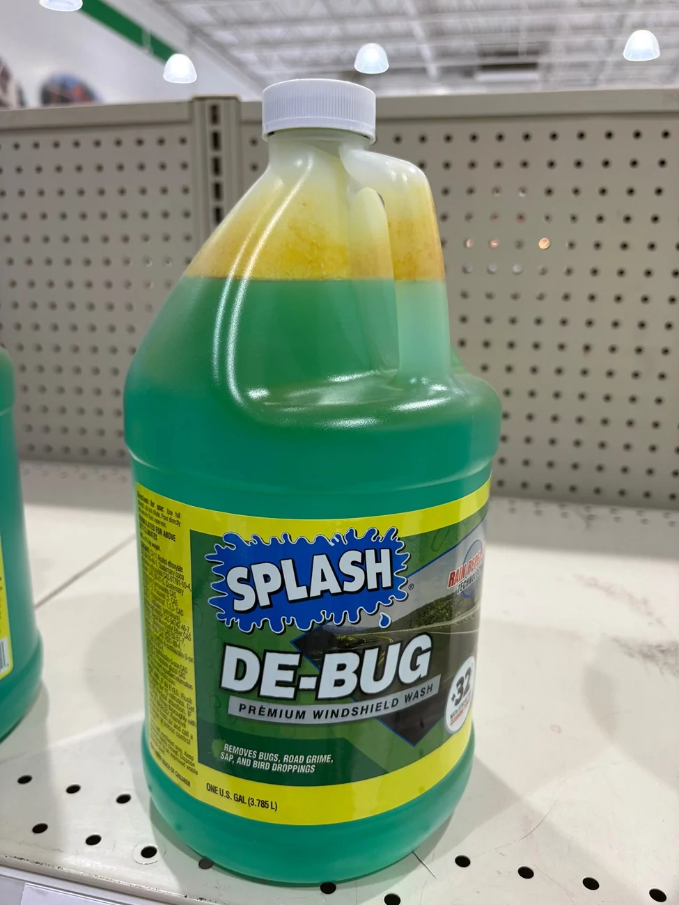

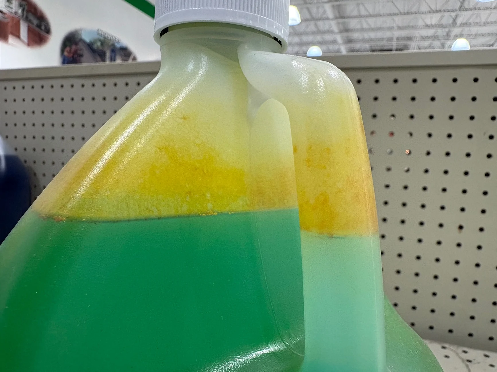

I recommend avoiding the bug washer fluid because it forms a sticky film at the surface that coats the inside of your washer reservoir and the fluid sensor, causing it to stick and malfunction.
These brand new bottles had a manufacture date code that was less than six weeks ago. Look how much sticky stuff has formed, that will be what happens to your reservoir. All the bottles on the shelf were like that.
Ford Mustang Mach-E Washer fluid sensor seems to be malfunctioning IMG_2079
Ford Mustang Mach-E Washer fluid sensor seems to be malfunctioning IMG_2081
