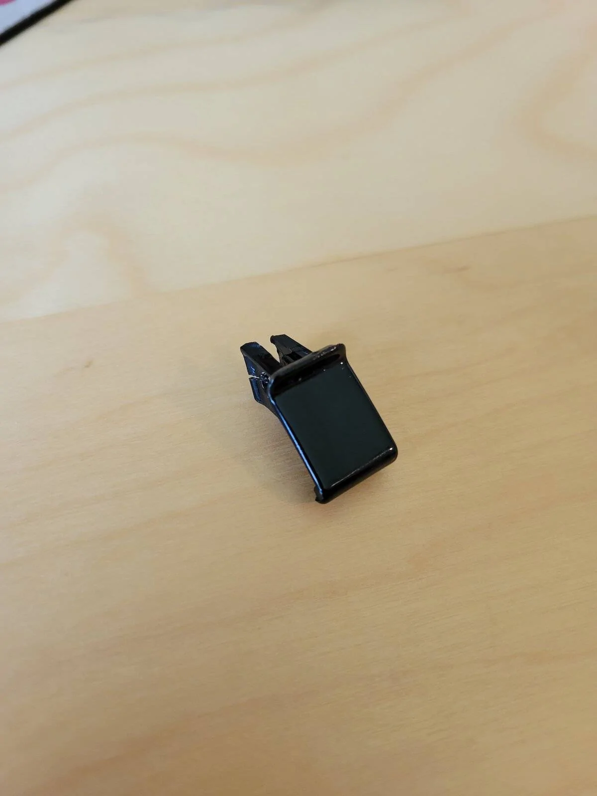

Can someone tell me the name/part no. of the piece next to camera. My son broke it off trying to open hood (I have no idea how) and if I can order and install myself that would be best.

It is the spray deflector to clean camera.
Can you snap it back on ?

It looks broken, but I will try to snap it back on. Thanks for letting me even know what it is to order part if needed.
Mine came off and I tried to snap it back on. After failing to do that, I took it to the dealer and they did it in a few seconds. They key was to have someone hold the windshield wiper washing stalk while the tech popped it back on. Doing that, the little nozzle sticks out and makes it easy to snap the cover back on. 3,900 miles later it is still on.
After a few washes I got it back on. It's a little loose but hopefully holds. Thanks for the help.

THANK YOU GUYS...I was wiping down my car and this piece came off, I literally was about to go to the dealer ??? I put a towel between the dash and wiper to keep it on then ran to the front and put the part back on.
Ha! I broke that thing off when I first got my car. I was able to just snap it back on though.
