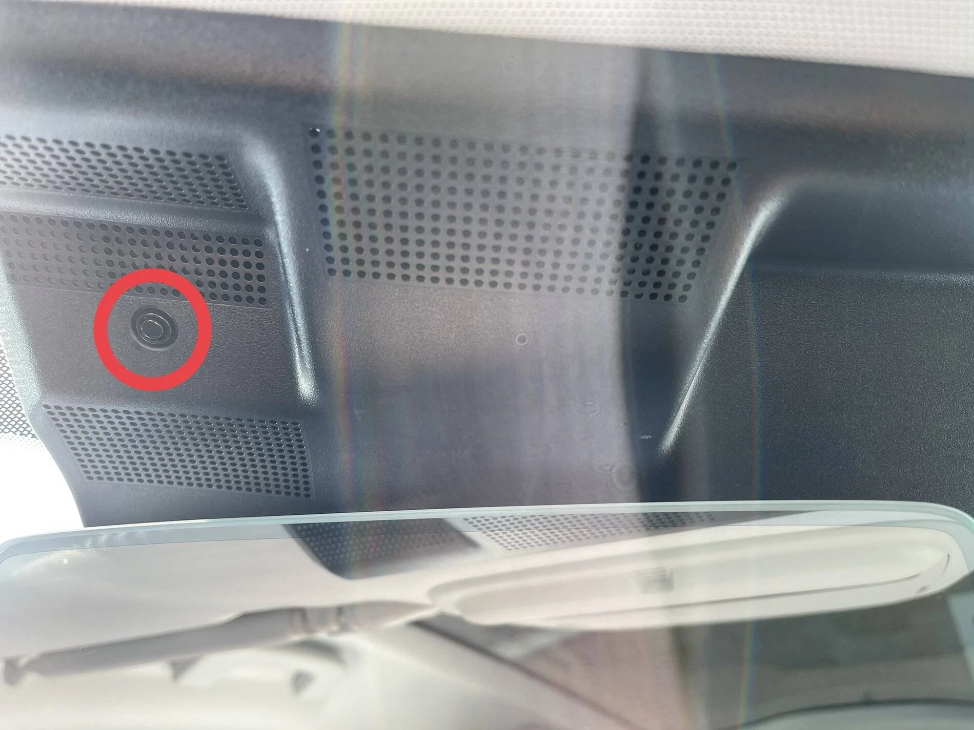

In the overhead console, there’s something that looks like either an LED or a camera lens. Any idea what it is?

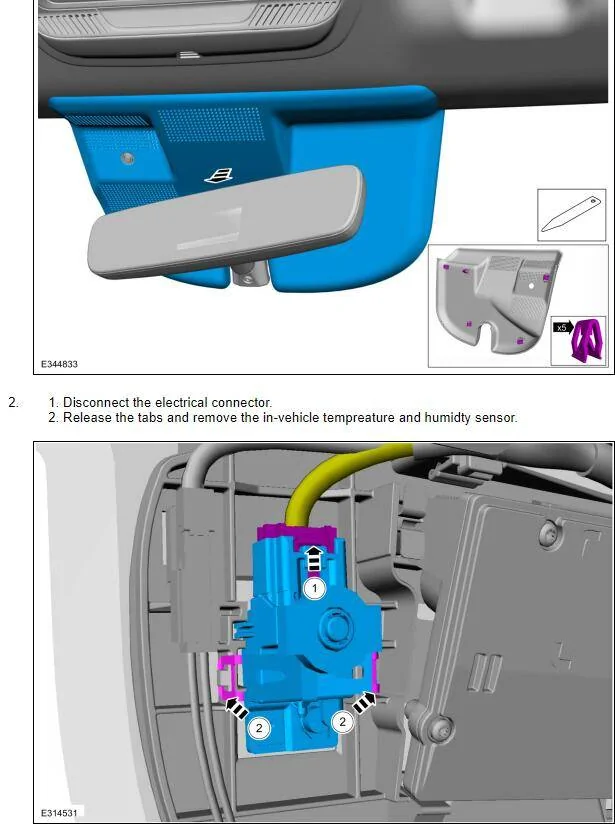

Temp/humidity sensor. The alarm sensors are under the little grille on the overhead console. Technically speaking, OP that is not the overhead console, its still considered the windshield.

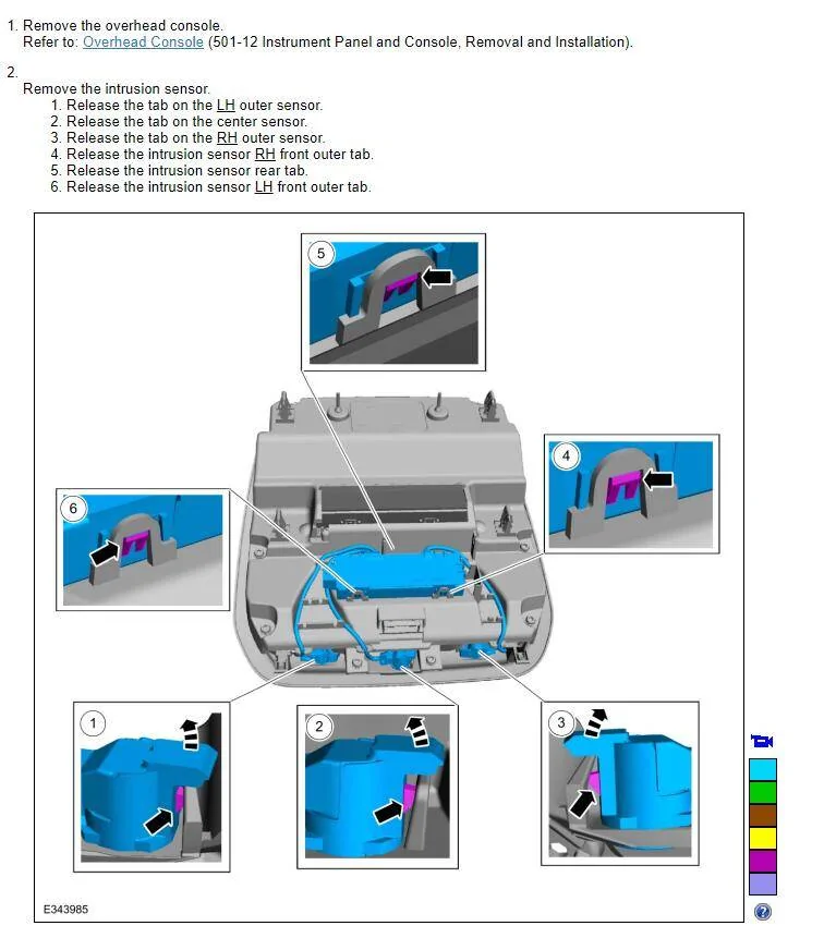

Intrusion sensors are here.
