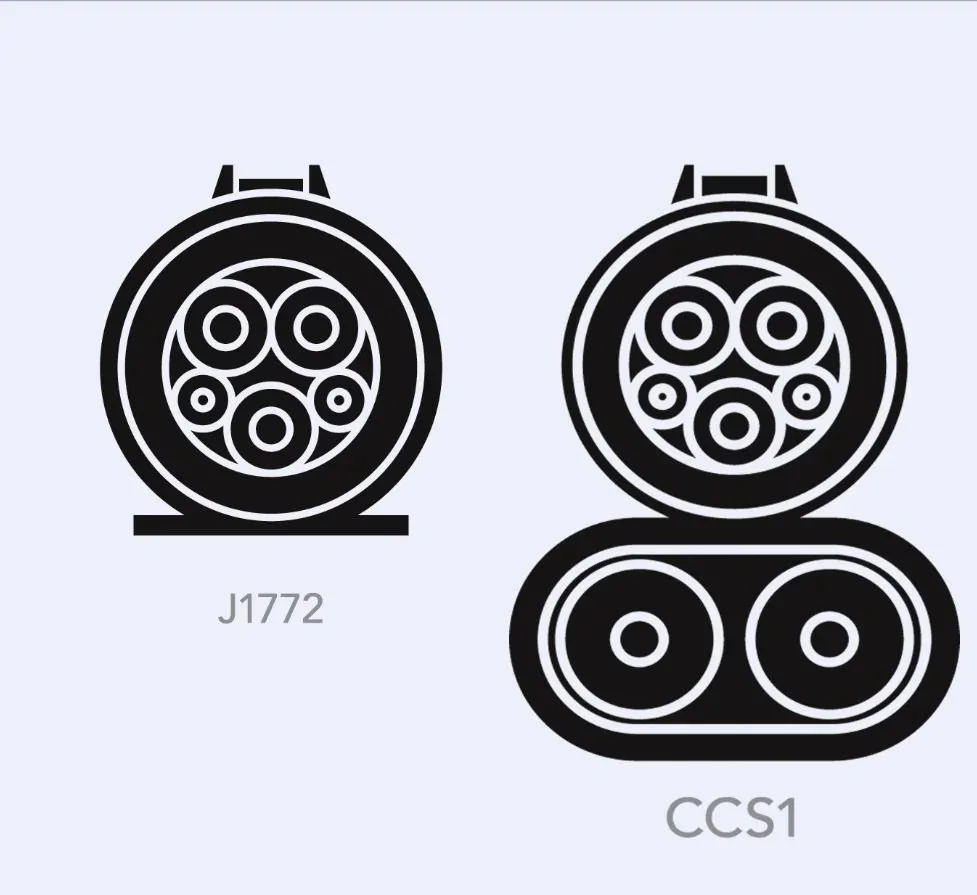

I am not sure whether our '23 can accept 325kW, but I'm suspect a V4 charger will throttle down if necessary. I will make sure the apps ae set correctly. I have two adapters, one from Ford and one from AtoZ. Is one preferable ?
You will get the proper charge rate, the car and charger communicate. Either adapter will be fine, so long a is the L3 adapter (CCS), there are also L2 adapters that are meant for home chargers.
Got it, thanks. We use the J1772 for 240v AC charging at home. The adapter is CCS1 on one end a Tesla on the other.
