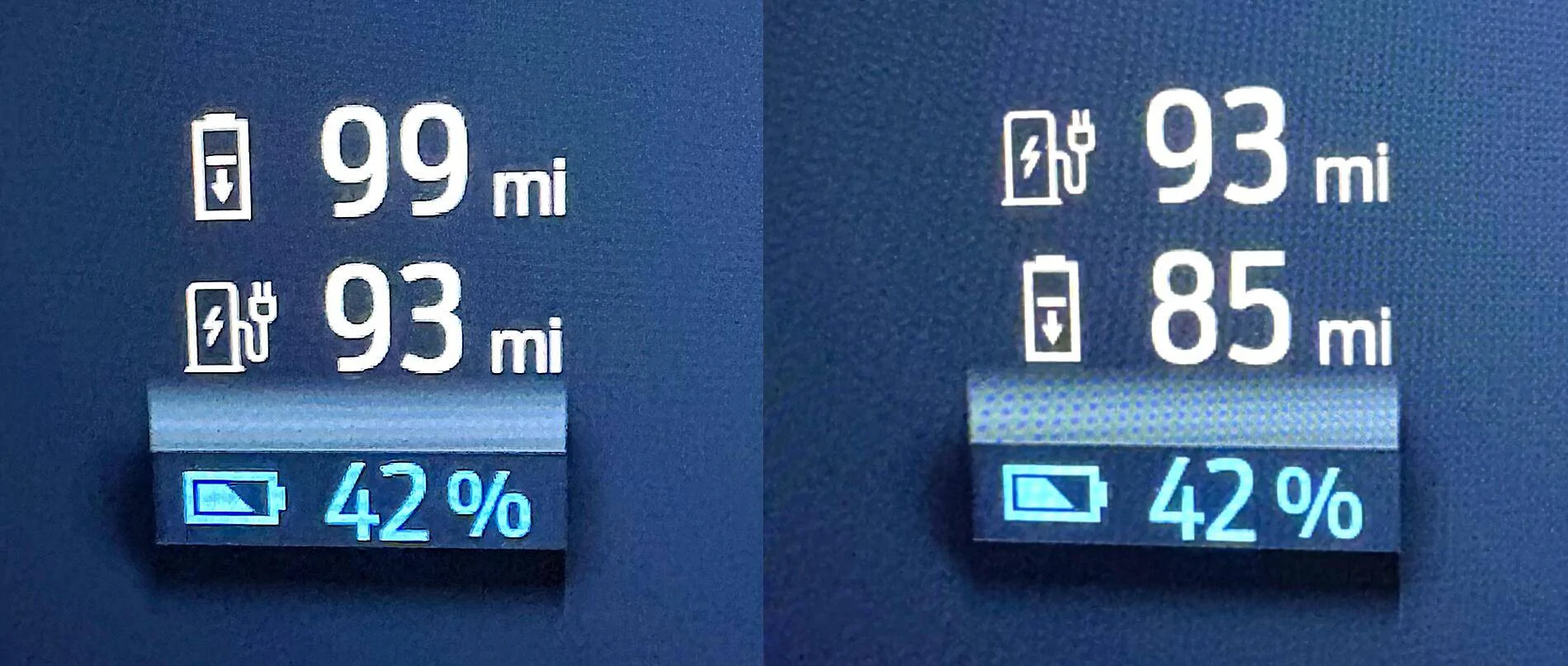

Yes. First of all, the numbers should NEVER switch places. Second of all, the charger or destination should turn RED if it becomes further than the range of the car. Ford knows about it, but I don't see much chance of them fixing it.

This hasn’t been fixed on our ’22.
We just ran into this issue today on our way home, climbing a mountain into a rain/sleet storm. For a ten mile stretch, I didn’t notice that the range/destination numbers had switched and believed I had a few mile positive buffer but had a few mile negative buffer.
We made it home with a few extra miles to spare because I noticed the problem and got off the freeway and onto surface streets for the last 15-mile stretch.
In this particular case, we were intentionally running the battery low, so it wasn’t a massive problem, but it sure could have been.
What a terrible UX/UI design decision.
I hope @Ford Motor Company gets this bug fixed soon. As mentioned early in the thread, these kinds of UI elements should NEVER switch places.

Easily more than half the mme owners and drivers don’t even know what those icons mean.
Thanks for sharing. Yeah it really sucks if you don't notice it in time. It's gotten me a couple times.
I don't have much faith in this ever getting fixed. Spedo glitch took a year or two, and that was VERY obvious.
Yeah, my hope is low. But I figured it doesn't hurt to bring it up again.
