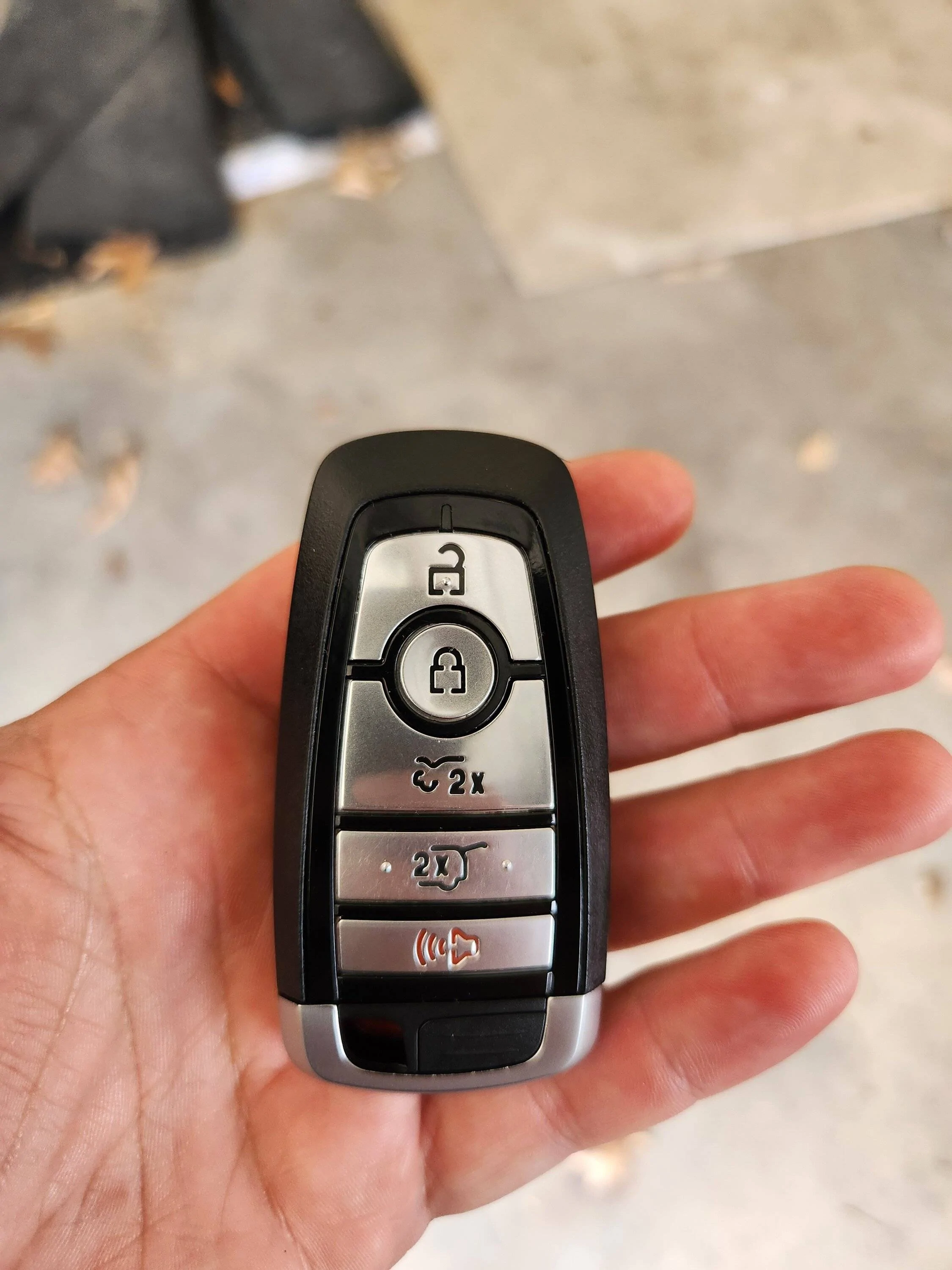

I’m actually thinking of that but I don’t want a fob with a tailgate icon (I’m a bit OCD) I want one with a hatch icon. I also want one with a Mustang on the rear - not a blue oval.
[/QUO
I actually bought one that was completely done as you are hoping for on ebay, paid $123 and worked perfectly first try
