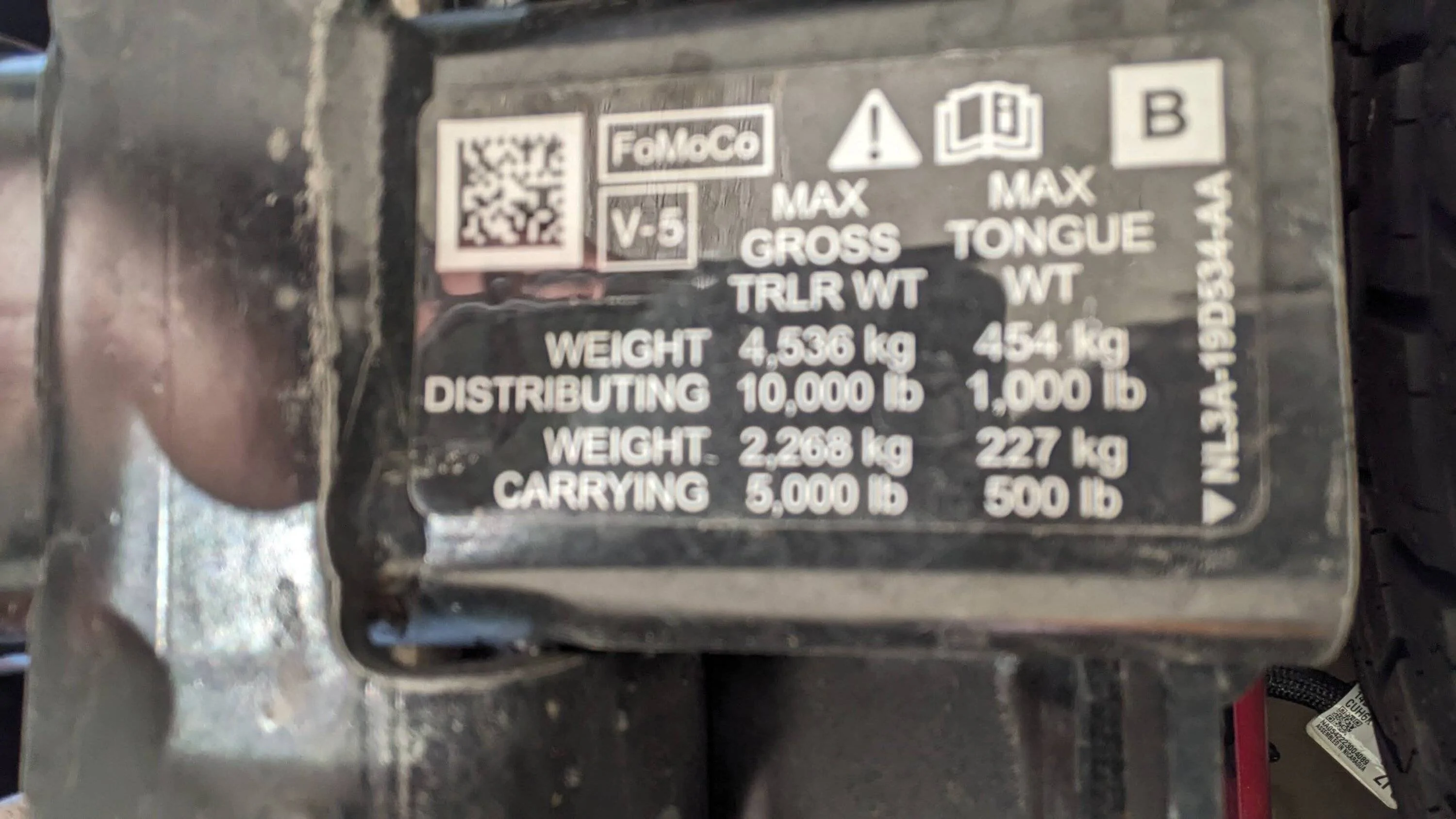

While a weight distribution hitch wouldn't be required on a Lightning with Max Tow, I would definitely recommend it.
A WDH is required on EVERY F-150 out there, including the Lightning, once you exceed 500 pounds of tongue weight.
This is the receiver sticker from my Lariat Max Tow. 500 pound tongue weight without WDH, 1,000 with WDH.
Ford Mustang Mach-E Will Mach-E tow the Lightship RV? Hitch receiver sticker
502
14,318
28,673
This is the receiver sticker from my Lariat Max Two. 500 pound tongue weight without WDH, 1,000 with WDH.
