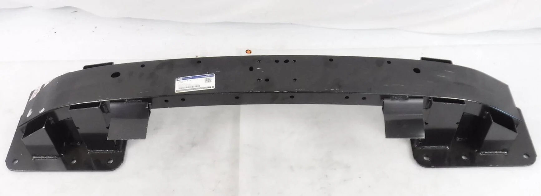

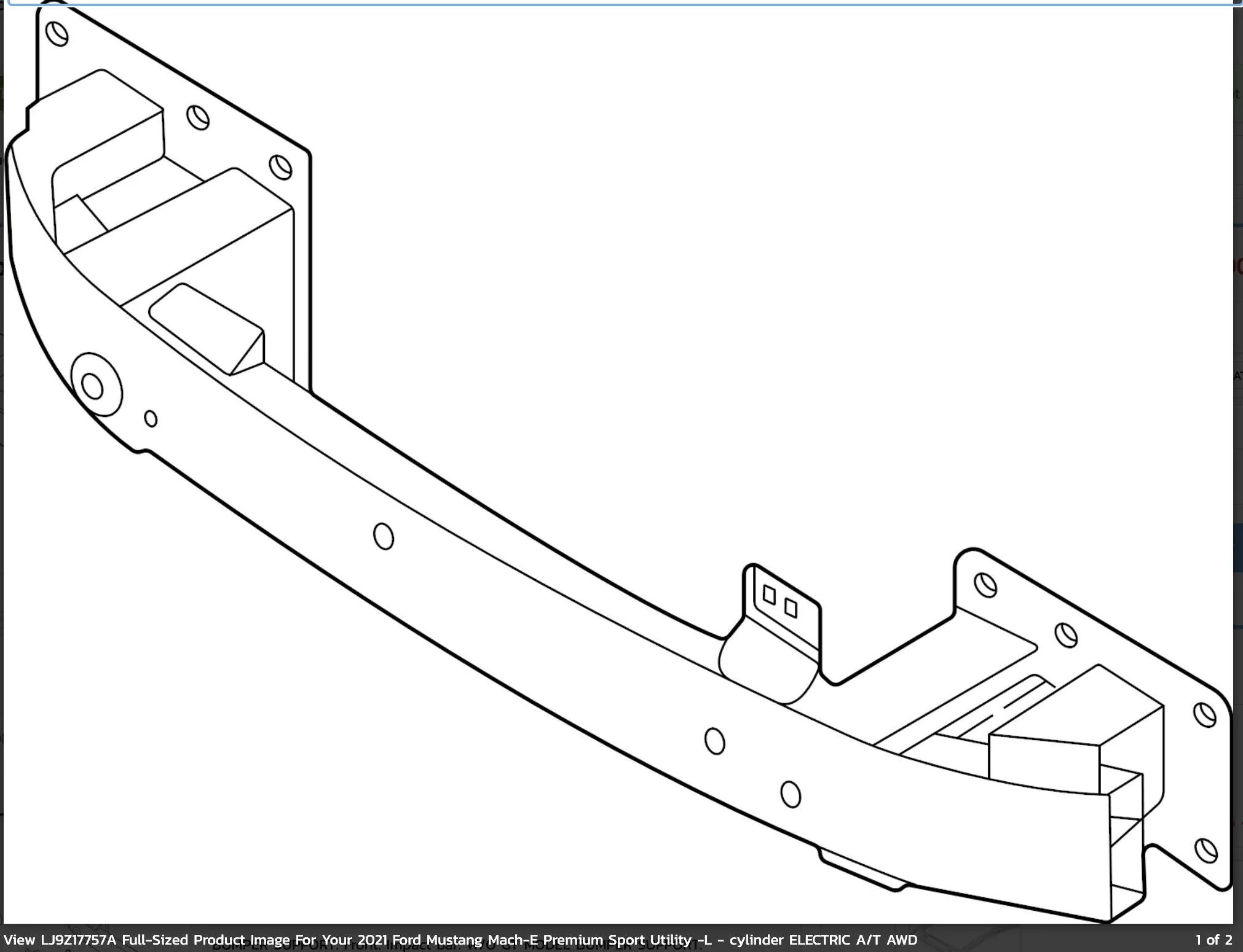

Does anybody have any pictures of a European MME front bumper? and or pictures of where the screw-in front tow hooks are mounted?
Does it use the same access port as the LVB 'recovery' jump cables?
I am contemplating a mod to add hooks. I hate the idea of just the Jhook holes underneath in the front. Could easily be impossible to reach if the front end is buried in a snowdrift or ditch. If there is a Ford part I could order for an access panel on the existing US bumper it would be easier than cutting and fitting with hinge or fasteners....
Access panel is already there.
Here is the US part - you can see the hole:
Ford Mustang Mach-E Mach-E Winch Recovery Tow Points 1642783217471
Ford Mustang Mach-E Mach-E Winch Recovery Tow Points 1642783292490
2021 Ford Mustang Mach-E Bumper Impact Bar (Front). W/GT MODEL, BUMPER SUPPORT. W/O GT MODEL - LJ9Z17757A | All American Ford, Old Bridge NJ (allamericanfordinoldbridge.com)
Perhaps one our European friends can id the Ford EAO part number?
