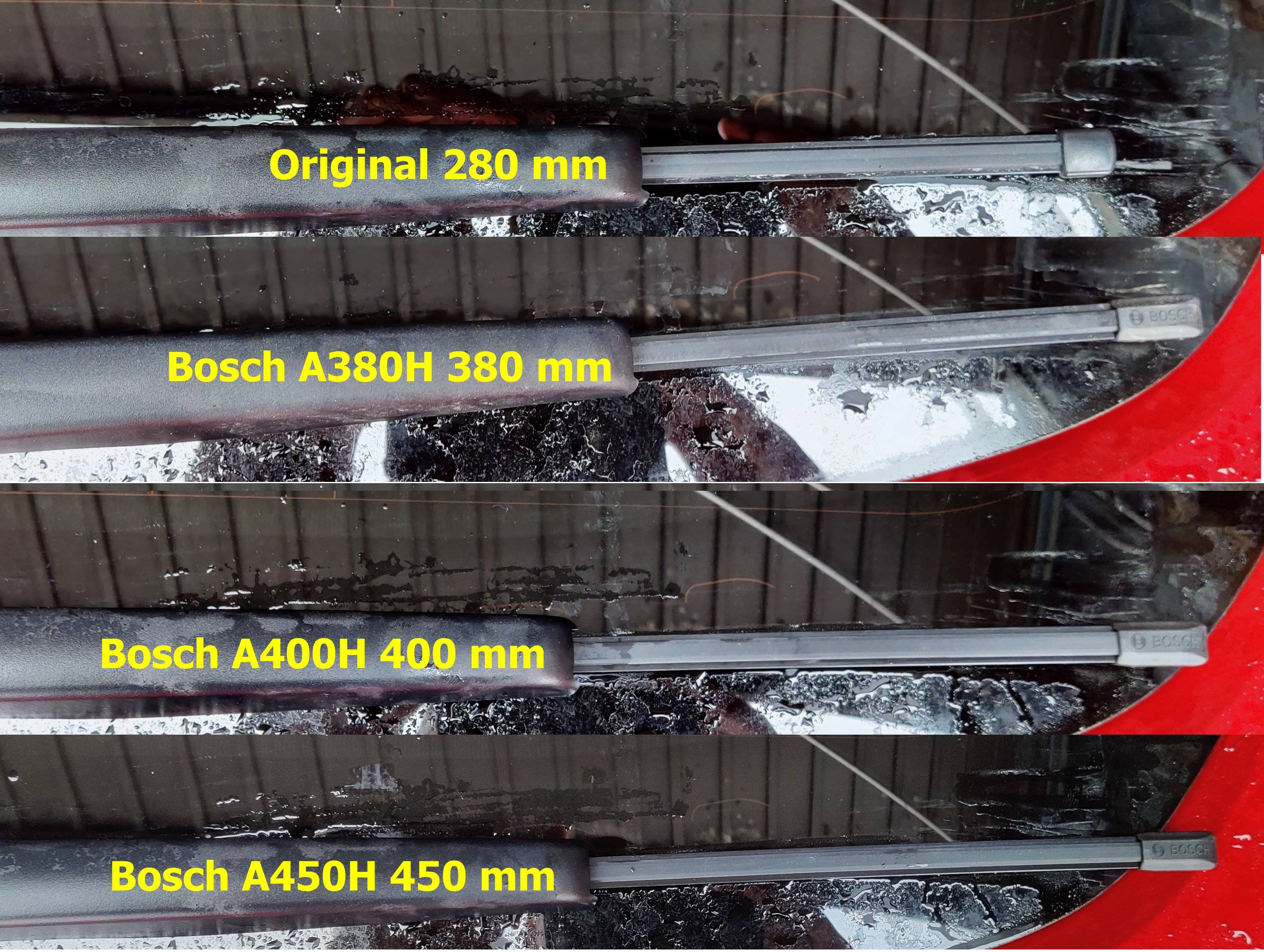

Hi guys, I just did a comparion for a MME forum in Germany regarding the rear wipers
all wipers do fit on the rear, the only blade exceeding the glas is the Bosch A450H, all others are perfect
As for the frront wipers we have tested Bosch A225S (length 650/550), on this one the passerger side slightly touches the A pillar. It works but due to the length of the passenger blade not recommended.
Then we have the A636S and A051S with a length of 650 repectively 530 mm, these are packs with 2 wipers same length. Yesterday we found out the Bosch A638S (650/530) which is for VAG vehicles does also fit the MME. These blades are recommeded and work perfectly.
Ford Mustang Mach-E Windshield Wiper Upgrades Vergleich

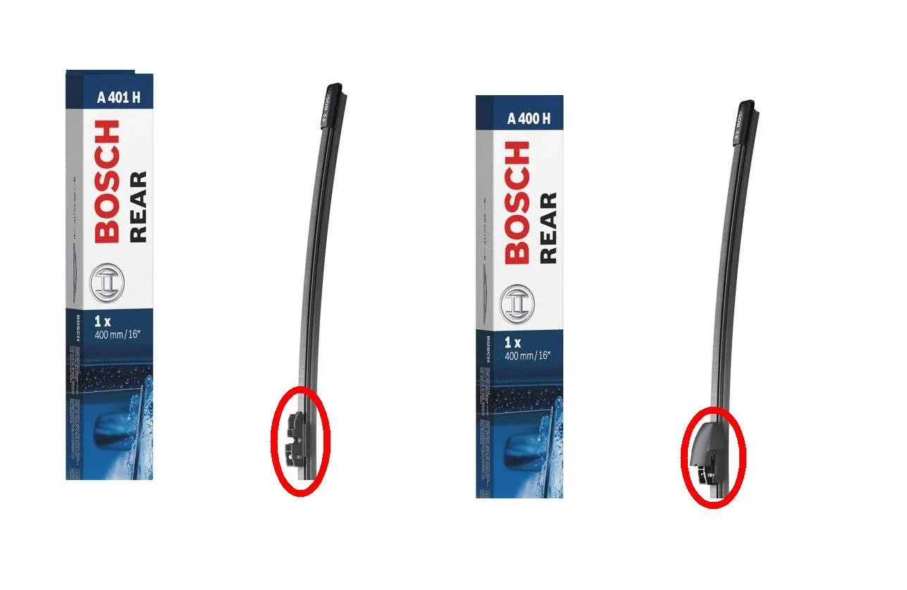

if you wonder why one mentions A400H and the other user A401H
then have a look at thee pic below. When you take off the cap on the 400 then you get the 401. That's all they are the same wipers
Ford Mustang Mach-E Windshield Wiper Upgrades 400 vs 401
