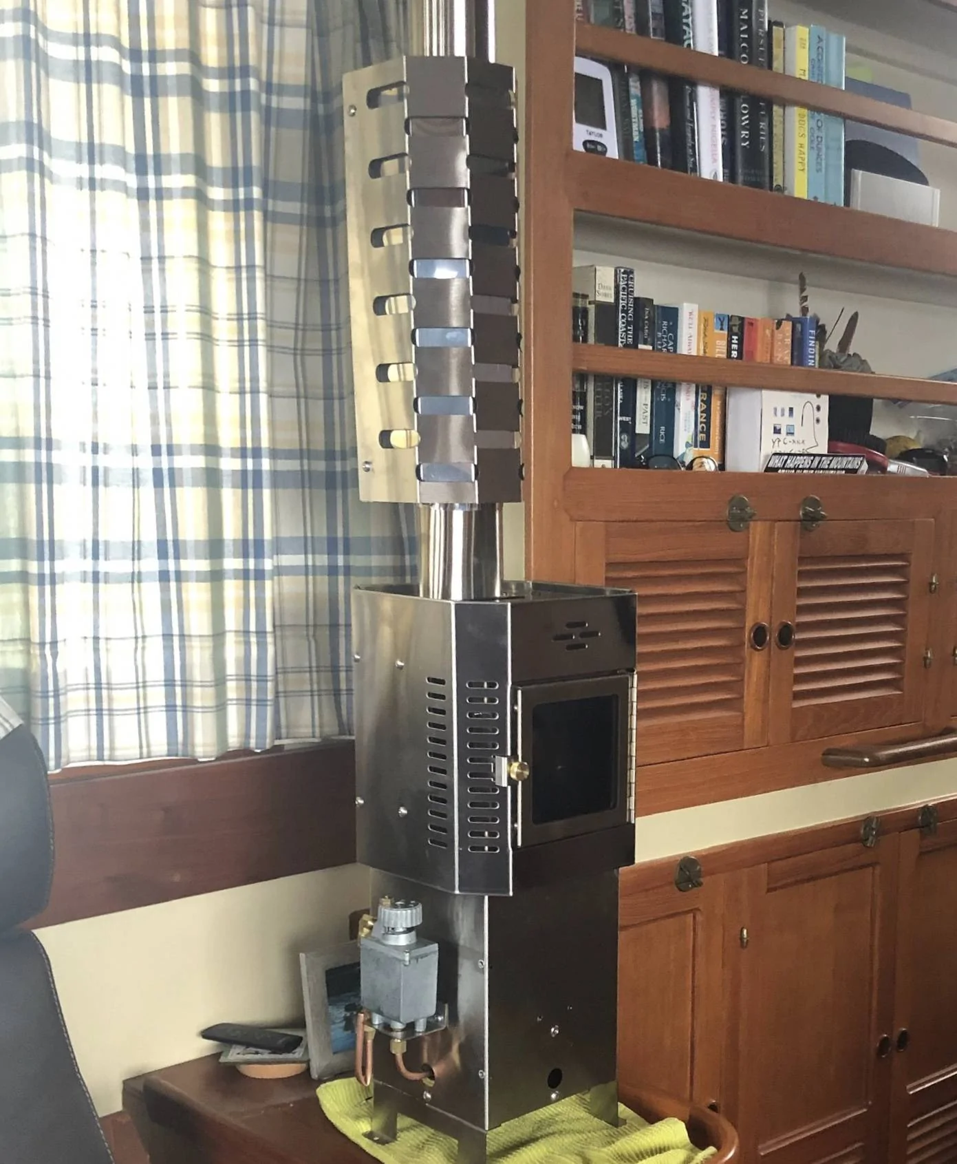

I haven’t been very excited about the heating system in our MME. One of the only issues I have with the car! I have been highly discouraging my son from purchasing a Lightning for this very reason, he’s in Alaska so this is serious stuff. But being a true Alaskan he has a solution for this. If it works on a boat it ought to be fine in a pickup.
Interesting thought, but I don't think having a live propane heater in a car would pass muster with the safety regulators!
It'd be fine. LP, Hydrogen, and CNG cars are already sharing our roads.
