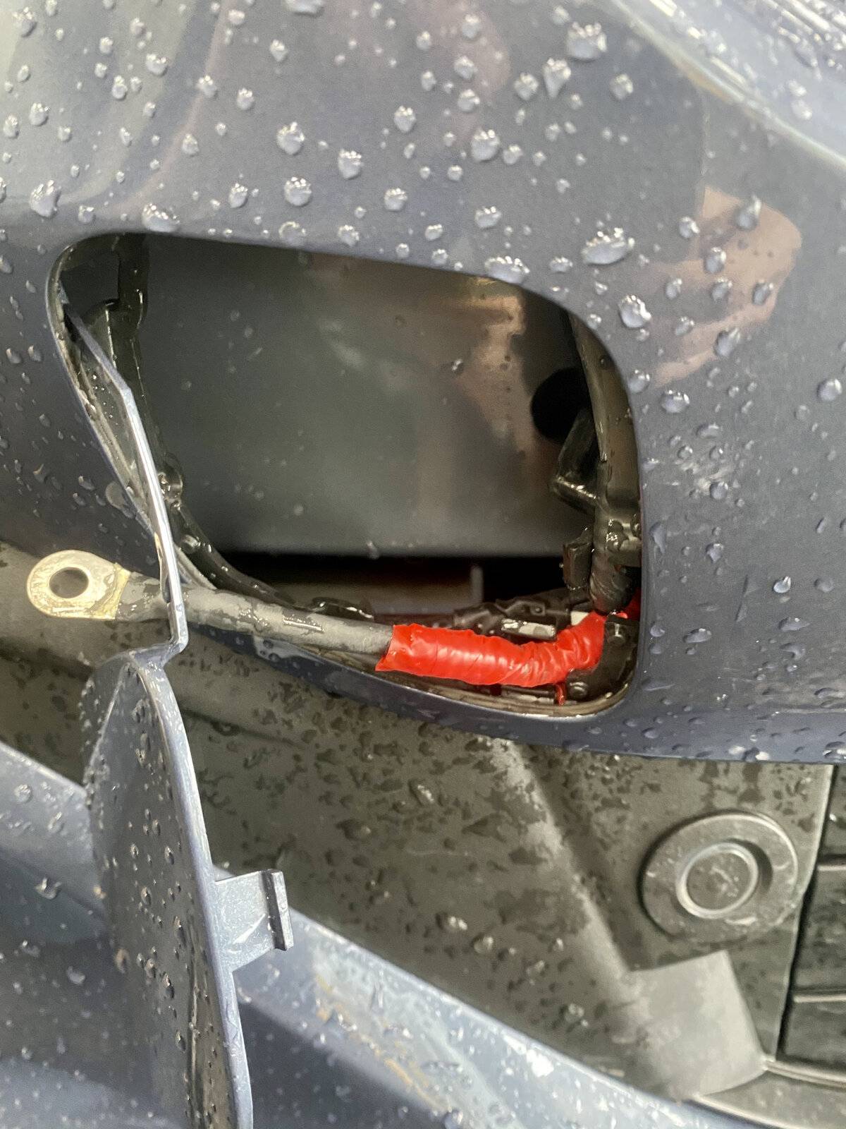

How about inside the cover with the terminals to open the hood? Is inside there magnetic? Or even a worst case you could probably make it stick to the end of the cables themselves.
Ford Mustang Mach-E Jump Start Guide in Owner Manual IMG_6043
Mostly plastic but I'm guessing some gorilla tape could hold a couple of 9v batteries in there. Someone else will have to check as Marlin's still in the hospital.

I haven't left this Forum. Still read it everyday. My Mach is 30 days out and will be here.
All this dead battery stuff must be corrected soon. As I look at this posted photo I
can see the positive cable is somewhat a large gauge. If it were to ONLY open the
frunk this would be overkill. Only a small gauge wire would operate a relay to open.
My guess (a guess) it is to charge the 12 volt battery. Does anyone have a wiring
diagram of the car or is it not out yet ? Again just a guess.

I can think of a few . . . they seem pretty small gauge wire (probably all that is necessary for the frunk popping, but would need to be heavier to actually do a jump, if they were direct contact to the battery, would need better insulated to avoid a short, they are not "live" unless the 12V battery is dead (they won't do anything if a thief tries to break into your Mach E without the 12V being dead), and I am sure other reasons I have not thought of.
The bigger question for me is one that @ChasingCoral posed . . . once you are in the frunk, easier access to the positive terminal jumper would have been smart with a small access panel rather than removing that entire big piece of plastic.
I had my first experience with this today and it certainly wasn't very intuitive or easy to snap off the covers. Why the world didn't Ford just put a simple little access door??

Yes, It was completely dead but I was able to open the door because it wasn't completely closed so I don't know what happened. I'm glad I didn't have to pop off the access panel to get to the frunk but it was not fun pulling up all those plastic panels. I had to call roadside assistance to help give me a jump and he had no idea what to do either but as soon as he was finally able to put the cables on the terminal it started right up with no errors or notifications. My car with built December 16th and it spent time at Speedway so not sure if this is a problem or if it was just a one time thing. I wouldn't think the battery should run down completely.

it's likely due to the size (gauge) of the wires and the current load expected in that scenario.
And they probably specified the smaller gauge wires to reduce weight in order to meet some specific mileage requirement.
