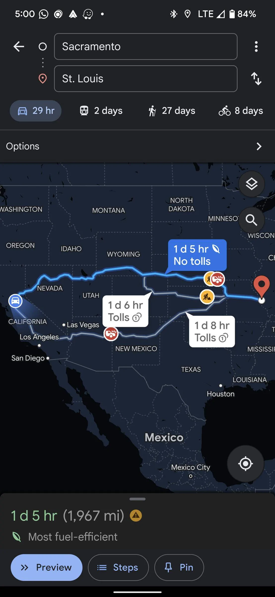

I will attempt factory IPC as built (alone) in a few hours and report back.
If it doesn't work I'll see you in a couple days ?
Ford Mustang Mach-E 12/17 Updates Released Screenshot_20220111-170028
Edit: Because FORScan is stupid, I had to order a different adapter. Will update tomorrow when it arrives.
