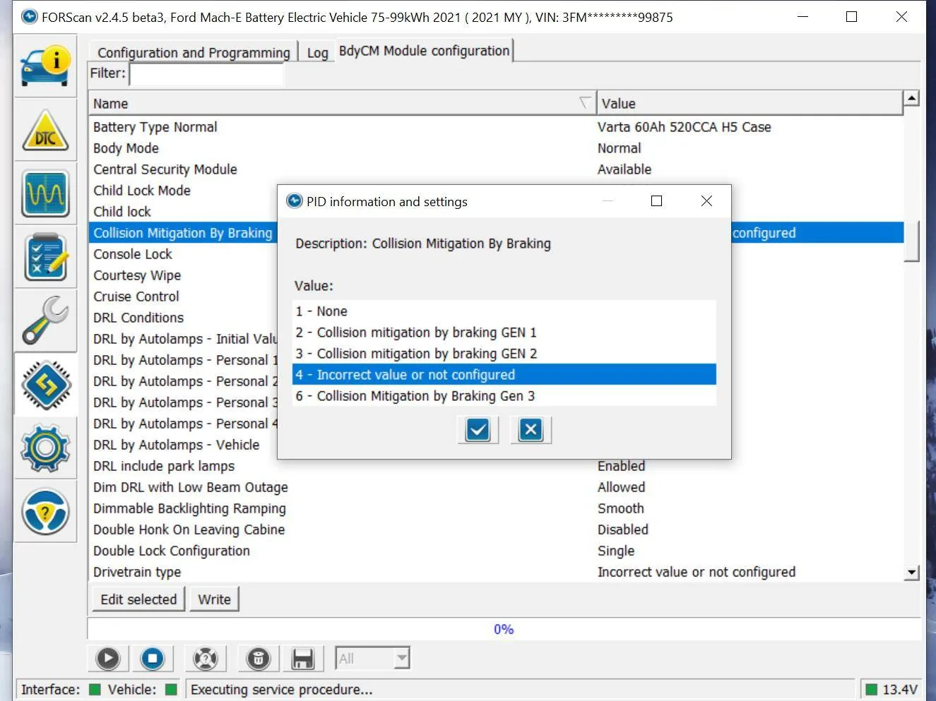

Has anyone experimented with this setting in the BdyCM with FORScan? I suspect the "Incorrect Value" setting is just because the FORSCan program isn't recognizing something with the Mach-E, but I suppose there is a small chance its related to the FDRS updates, and could affect BlueCruise. Also, note the Battery Type defined at the top is the 60AH (other threads discussing this).
It just means FORScan doesn't know what that value does exactly. It is common to see.
Yeah I saw it in multiple places, so not surprised. Another thing I thought might be interesting would be to compare the As-built ABS config from FORSCan to a car that hadn't been updated with FDRS (the one that breaks BC). I am new to FORSCan and just poking around. Plus I don't have access to a non-updated GT to look for differences.

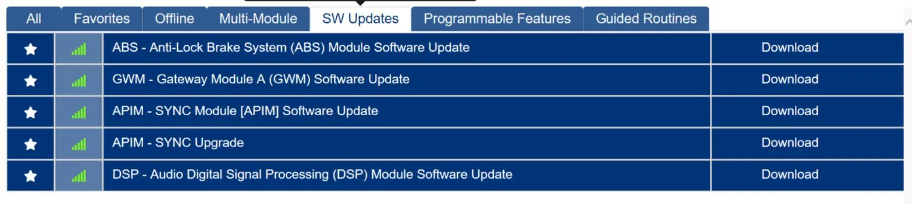

I installed all available updates for my Job 1 car with a 2-day license about a month ago except the door control modules because they kept erroring out. The car was at the dealer for the glass recalls this week, so they also ran through 21P22. They updated the door control modules and another ABS update showed up, so they did that too. The ABS update didn't disappear from the list, which I assume is the same bug that others have encountered. Not sure if the listed GWM, APIM, and DSP updates that show up for my car are real at this point. I did get OTA 2.1.0, so I'd be surprised if there's already another update for the GWM.
@louibluey , are you seeing new GWM and DSP updates for your FE? Has anyone successfully installed this APIM update and gotten the Sync version to change?
My Job 1 (ER RWD Premium 1/21 build) shows the same updates. I applied the 21P22 update successfully and got OTA 2.1.0. My OTA 1.7.1 failed, but I seem to have the new APIM version. Did your car's OTA 1.7.1 update fail?

My OTA 1.7.1 was successful, so I’m really not sure if the APIM update that shows up in the list is real.

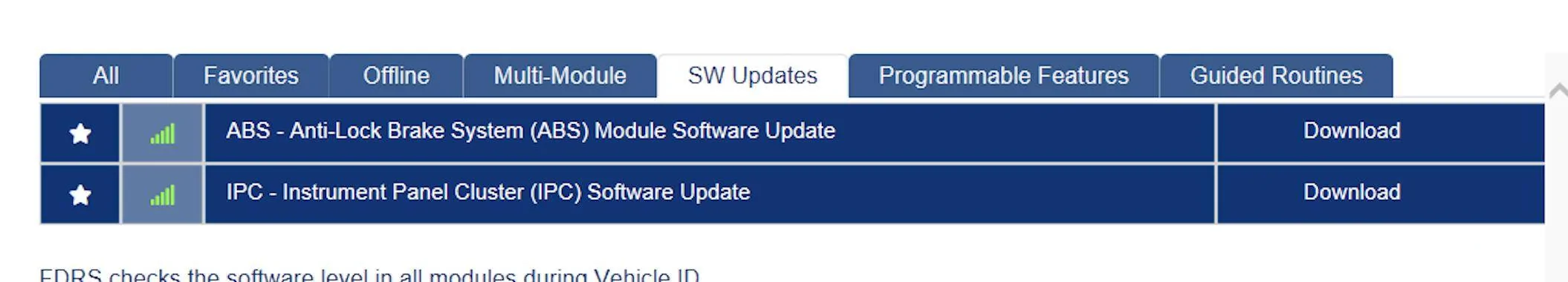

I uninstalled both FJDS and FDRS, and both times chose to delete all of the associated data (clearing all data). Reinstalled the latest versions of both. Now I only see the ABS and IPC updates. Both of the APIM lines are gone. Might try again tomorrow to do the actual updates.
Do you need FJDS? I only installed FDRS (though my license is now expired). It’s interesting that the IPC update doesn’t show up for me.
Most say no, that FJDS is just for older Fords, but I read somewhere that FDRS needs some parts of FJDS and that you have to install it with FDRS (could be wrong of course).
Most of the updates worked fine on my car without FJDS, but I couldn't get the door control modules to update. Next time I have a problem like that, I'll install FJDS and see if it makes a difference.
