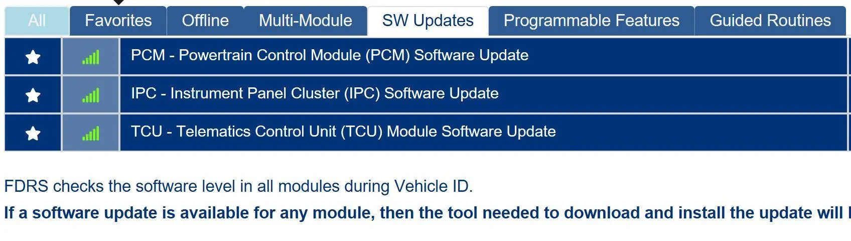

So with help from @benk016 I figured out the difference is the calibration on the ABS. It updated to LK9C-14C602-ME. Current version is LK9C-14K602-KE. The problem is Ford doesn't have those calibration files available for download for some reason on their binaries website. I can download the software but not the calibration. The software did not change in this update just the calibration. note that calibration is different than as built it is part of the firmware/software package on the module.
If I could get that -KE file I could just use FORScan or UCDS to flash the module back. I just wish Ford would release the proper update or let me revert with FDRS...

Is anyone running FDRS 30.5.3? Can't see any way to clear DTCs. Some of the modules cleared their DTCs when they were updated.
Wonder if I need to downgrade FDRS to get back this functionality.
Yes. Theres a bug that when you hit 'view all CMDTCs' it doesn't work from the initial network test page. Hit "self test" in the main menu then hit "view all CMDTCs" from there. Then it will load them and you can hit "clear and retest".

Thanks, that cleared all the DTCs except GWM.
For GWM: U2404 Ethernet Failure with IPMA
The GWM Update is still there, although I've run it already.
If that code won't go away that's a problem. It means the IPMA probably won't update OTA.
