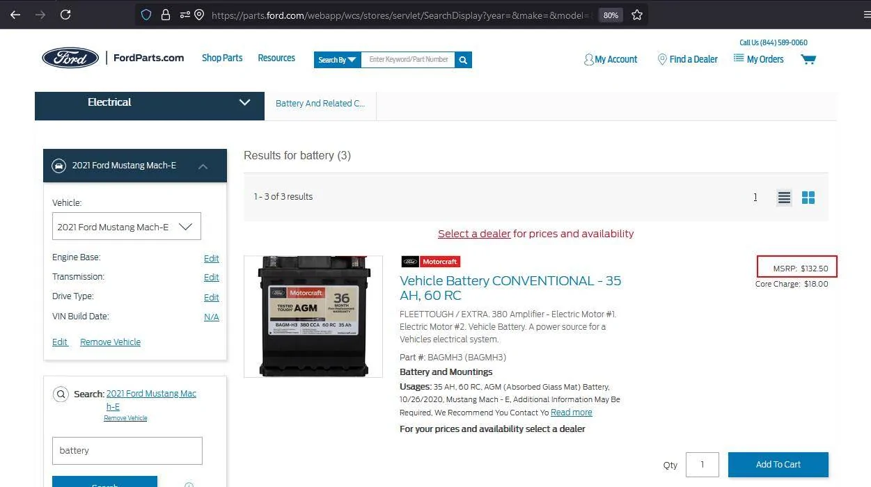

Price at Ziegler Ford (Chicago) is supposedly the same as the Ford parts website price:
Ford Mustang Mach-E 12 VOLTS BATTERY DIED WITHOUT WARNING!! MME_Battery_Ford_Parts
The price from my dealer here in Athens, AL is $145.75
Rock Auto has it for $105.79 +core. With shipping it's another $15, so we end up at roughly $139.
I'm sure there are variations.
