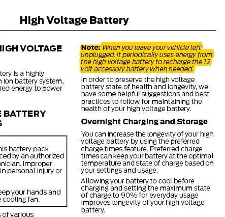

Your info from Ford also doesn't seem to match with what is stated in the owner's manual.
The question is under what conditions or states (all states) that manual clip is true. Agree the email from Ford kind of states differences under different states. It may not be happening when they state When the plug-in charging is completed the modules should go to sleep/rest and the 12v battery will no longer be maintained/charged. . I am willing to give it another shot give me my MME back. Does it do it at -19F is also a question? Welcome to the Smithers Winter Test Center. Hope they did not bring theirs into a cozy warm garage every night when they were testing. Guess I can just unplug the thing or does it go into a sleep/rest again (Jamie's says yes) email does not touch that? But.
Ford Mustang Mach-E 12V battery usage (volts) for various functions & situations in Mach-E Captur
The email says (while Jamie got 15V at a 12V accessories plug?) it is not charging the 12V in KOEO. Therefore it is kind of like your old ICE one click accessories you have windows, radio, wipers all off the 12V. Start appears to be the way to sit and wait so you are not running off the 12V? Guess if you leave someone in the vehicle you can give them the accessory's without a key/start.
