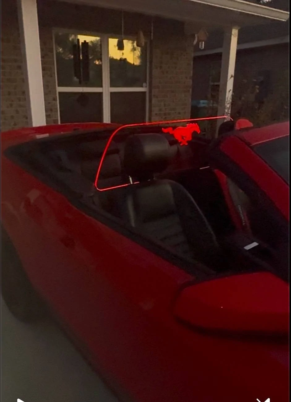

My wife flinches when I check 9 volt batteries that way. But it is a quick and accurate method.
It’s unreal how much that little 9 V battery can power it keeps this windshield on the Mustang powered up for 15 hours. But I switched it off when not in use so that thing will last forever cause I only turn it on at night and I don’t drive much at night.
Ford Mustang Mach-E 12 VOLTS BATTERY DIED WITHOUT WARNING!! IMG_9839
