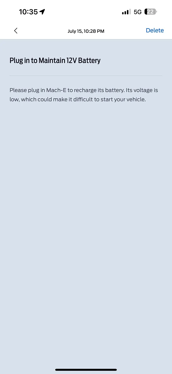

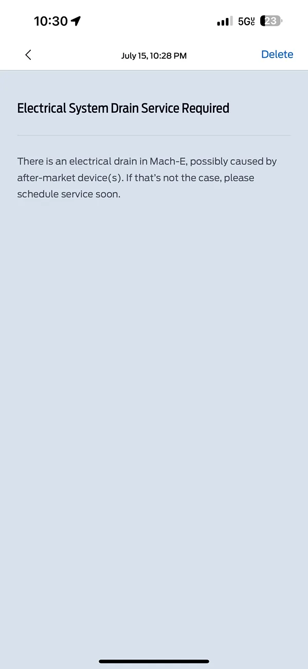

I haven’t driven my car much in 2 days and had received 5 OtAs. And just 15 min ago got two notifications from fordpass.
What do I do? Should I plug it in? Or start the car and have it on for a while or what?
Ford Mustang Mach-E 12V Battery Charging Facts IMG_5733
Ford Mustang Mach-E 12V Battery Charging Facts IMG_5732
11,351
24,978
What % is the high voltage at when you got that message?
I would turn it on for 30 minutes and read this: https://www.macheforum.com/site/thr...-system-drain-service-required-message.36140/
