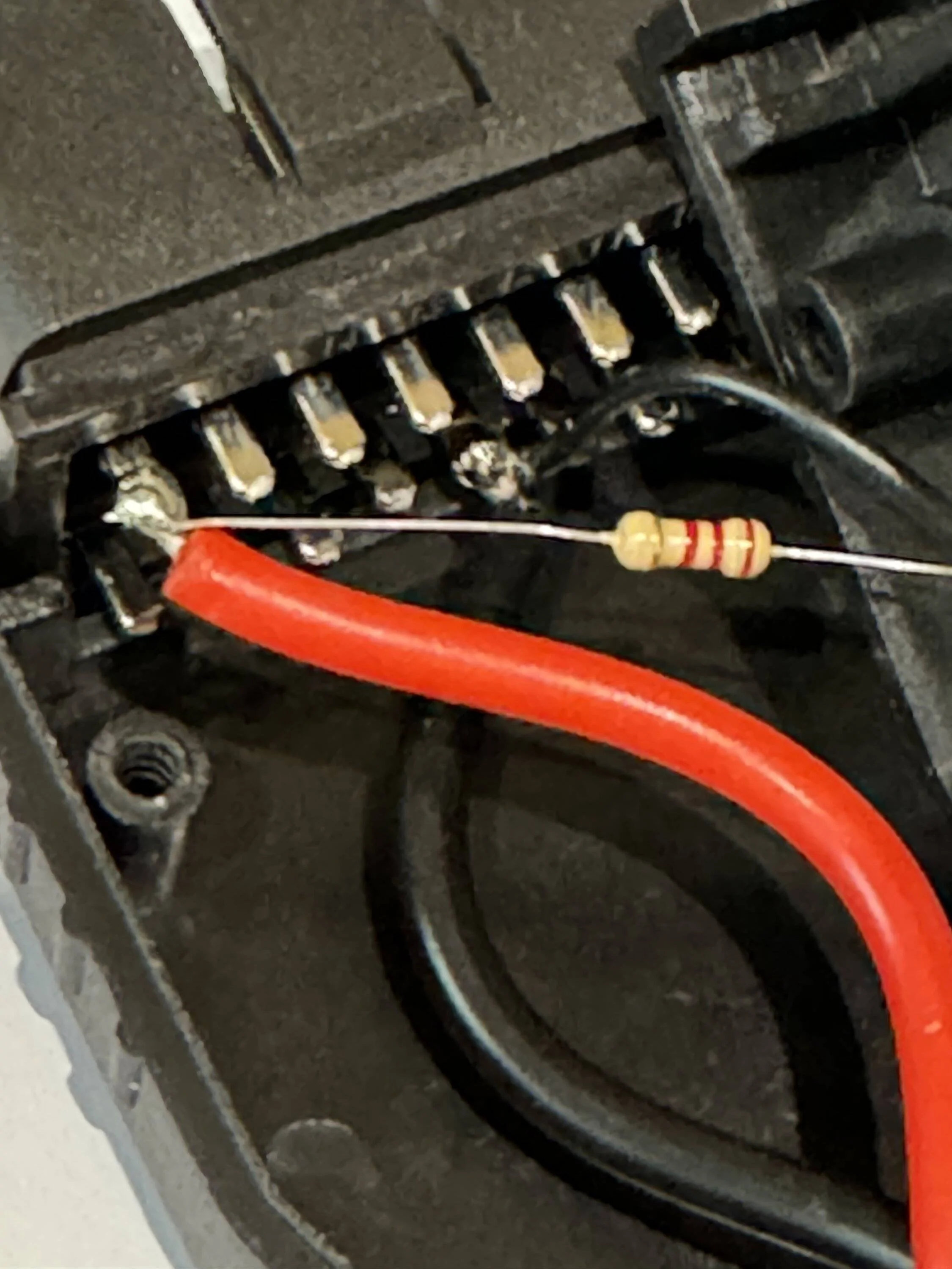

Here’s the OBDII wiring (+) PIN 16, (-) Ground PIN 4. (resistor is to small LED)
Does not charge LBV but seems to deplete it smart charger connected on ?️ mode 0.8A.

At this point I recommend you disconnect everything, put it in the trash, and pray you didn’t damage your car. Do not use a battery saver device with alligator clips! If the positive clip touches any metal you short out the OBD port.

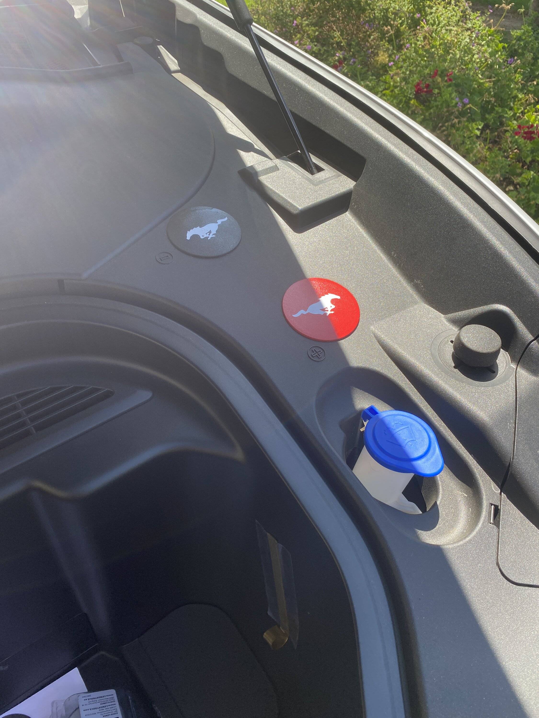

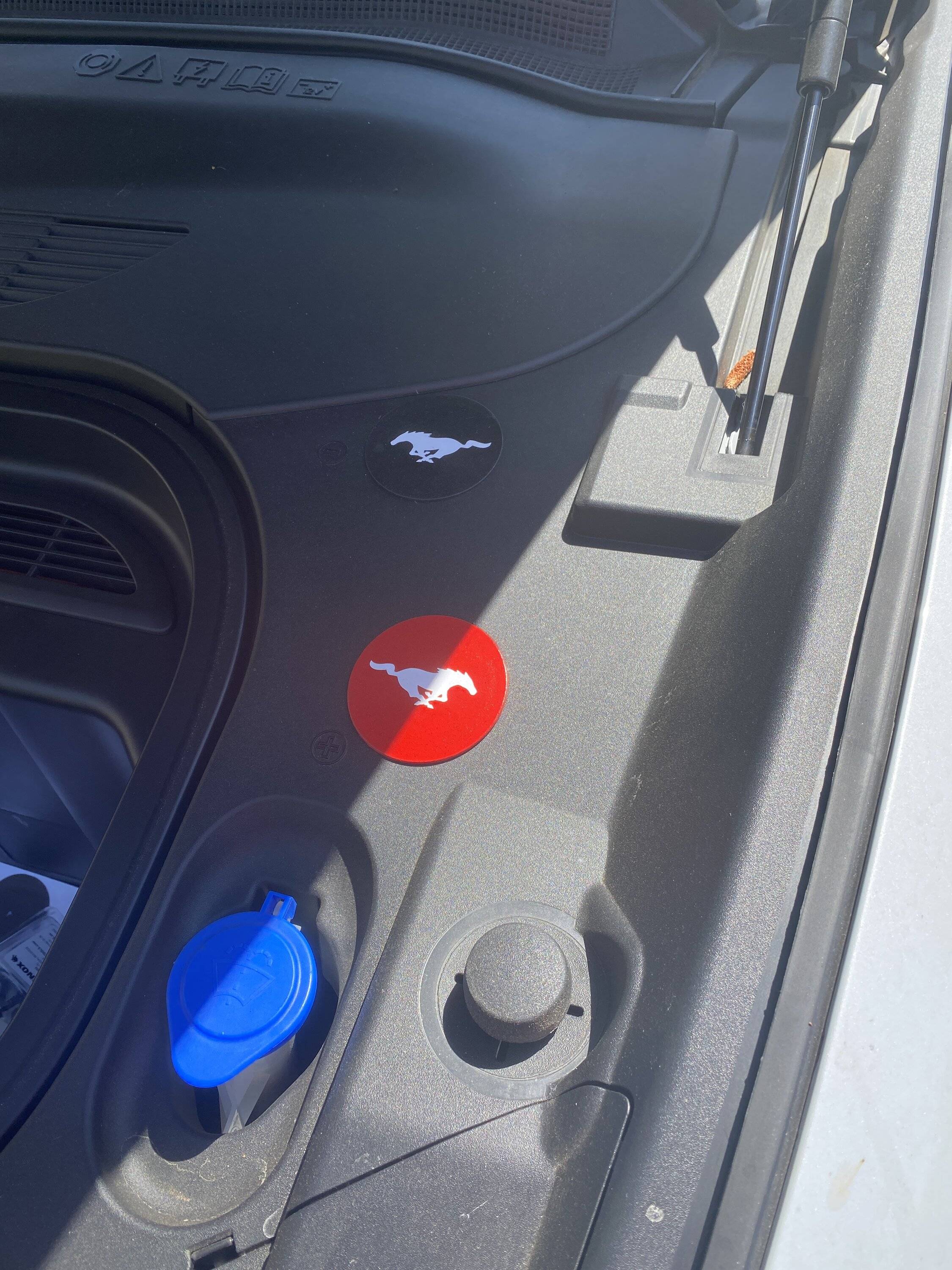

This is what my panel looks like when I cut the holes above the neg and pos charging posts.
