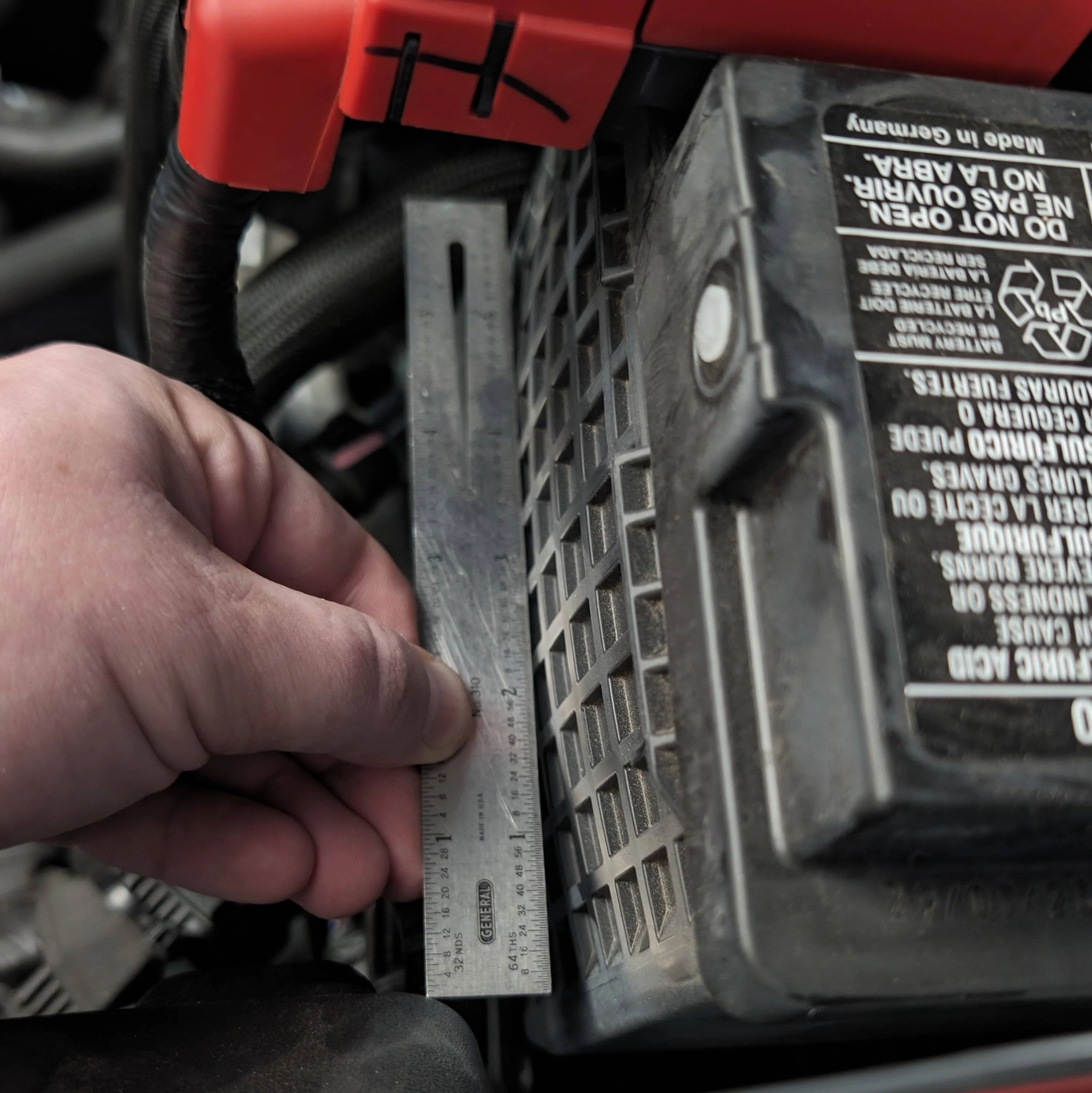

Quiescent avg current: 77ma.
So the battery was at 88% last night and it was 76% first thing this morning. I highly doubt the car used 4.2A last night. 77ma*12hours = 0.924 amps. That's no where near 12% of the 35Ah AGM battery.
This pic shows the bulge on the battery. Note how both ends of the ruler are not flush with the battery, only the middle is flush. I'm starting to wonder if the battery has a problem.
My battery is only about 12 months old (car made in Feb 2023), so it should not be near the end of it's life. It did spend a good chunk of that time here in Phoenix. On previous cars, I never had a 12v flooded batter last more than 18-24 months. From what I've read AGM batteries are better at heat tolerance that flooded.
Yes you should get that replaced. Drain is also too high and should be investigated. Swelling is indicative of overcharging or a frozen battery. Make sure you’re not trying to recondition the battery with a charger or resetting the BMS more than once.

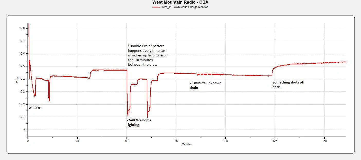

I can appreciate the struggle here. I can tell you from my tests it's abnormal for the car to keep waking up. When you shut down the car, something stays awake for two hours afterwards, but after that everything should shut down indefinitely and you should see less than 60 mA draw. When BLE connects for PAAK you'll see a couple extra mA of draw, not a big deal. But if you get too close with a PAAK or fob the car will wake up and go through the pattern of decreasing amp draw you saw, which repeats a second time after 10 minutes on my car. Here is a recording of voltage after shutting of my car, with a welcome lighting event. Again it takes 120 minutes to fully shutdown modules:
Ford Mustang Mach-E 12V Battery FAQ Mach-E Drain
Please disable welcome lighting if you haven't already. I've identified that as a drain problem on some vehicles.
Connected vehicle pings will only wake the car up one time, back to normal after 10 minutes. There should not be any occurring unless you've just sent a command or initiated a refresh.
This could also be software related on your vehicle. What updates does your car have available? I recommend you get 6.1, 6.2, 6.3, and 6.8 updates installed if you don't already. Basically this TSB: https://www.macheforum.com/site/thr...-defaults-to-normal-mode-while-driving.33163/
