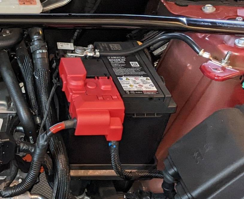

Where is the 12V battery?
The 12V battery is located under the hood on the left side of the vehicle (underneath the covers). Look for the embossed ⊕ and ⊖ symbols on the plastic covers, the jump start points are directly underneath these. The center and left side plastic covers must be removed for access (there are multiple clips holding them down, pull up firmly near each clip until you get them all).

Connect the charger to the jump start points under the hood, left side. See photo. You’ll need to remove the frunk covers first, see the battery location FAQ. IMPORTANT: DO NOT CONNECT THE BATTERY CHARGER TO THE NEGATIVE BATTERY TERMINAL. You must use a body ground, such as the negative jump post on the left side strut tower. See below FAQ for more information on why this is critical.
FYI the emergency leads in the front bumper are not connected to the 12V battery, thus you cannot charge the battery with them. They are for opening the frunk only.
Is there a wrong way to connect the battery charger?
YES! YOU MUST USE A BODY GROUND! DO NOT CONNECT ANYTHING TO THE NEGATIVE BATTERY TERMINAL! A body ground is anywhere on the body besides the negative battery terminal. You can use the negative jump post on the strut tower. Why is this critical? If you connect a charger or power supply to the negative battery terminal, you will bypass the battery current sensor, and the BMS will think the battery is discharging (SoC % will go down) instead of charging since the current is flowing through the sensor in the wrong direction. The BMS thinks the battery is going dead (even though it’s charging) and will activate load shed modes by shutting down modules and features, causing extremely odd vehicle behavior. You will think your car is possessed.
I cannot stress how important it is to connect the charger to body ground properly because it will wreak havoc with the vehicle’s systems if you do it wrong.

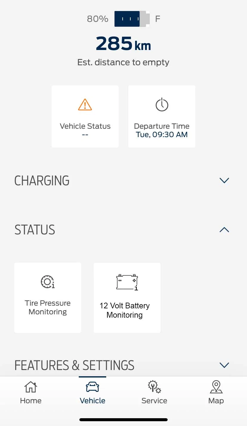

If you get warnings in FordPass about your 12V battery, the vehicle frequently enters deep-sleep mode in FordPass, you have a lot of difficulty getting OTAs to install, or notice other odd symptoms, it is possible the 12V battery is going bad. Have the battery tested with a digital battery analyzer by your dealer or other professional and replace as necessary. Also consider reconditioning the 12V battery per my topic to restore some lost capacity.

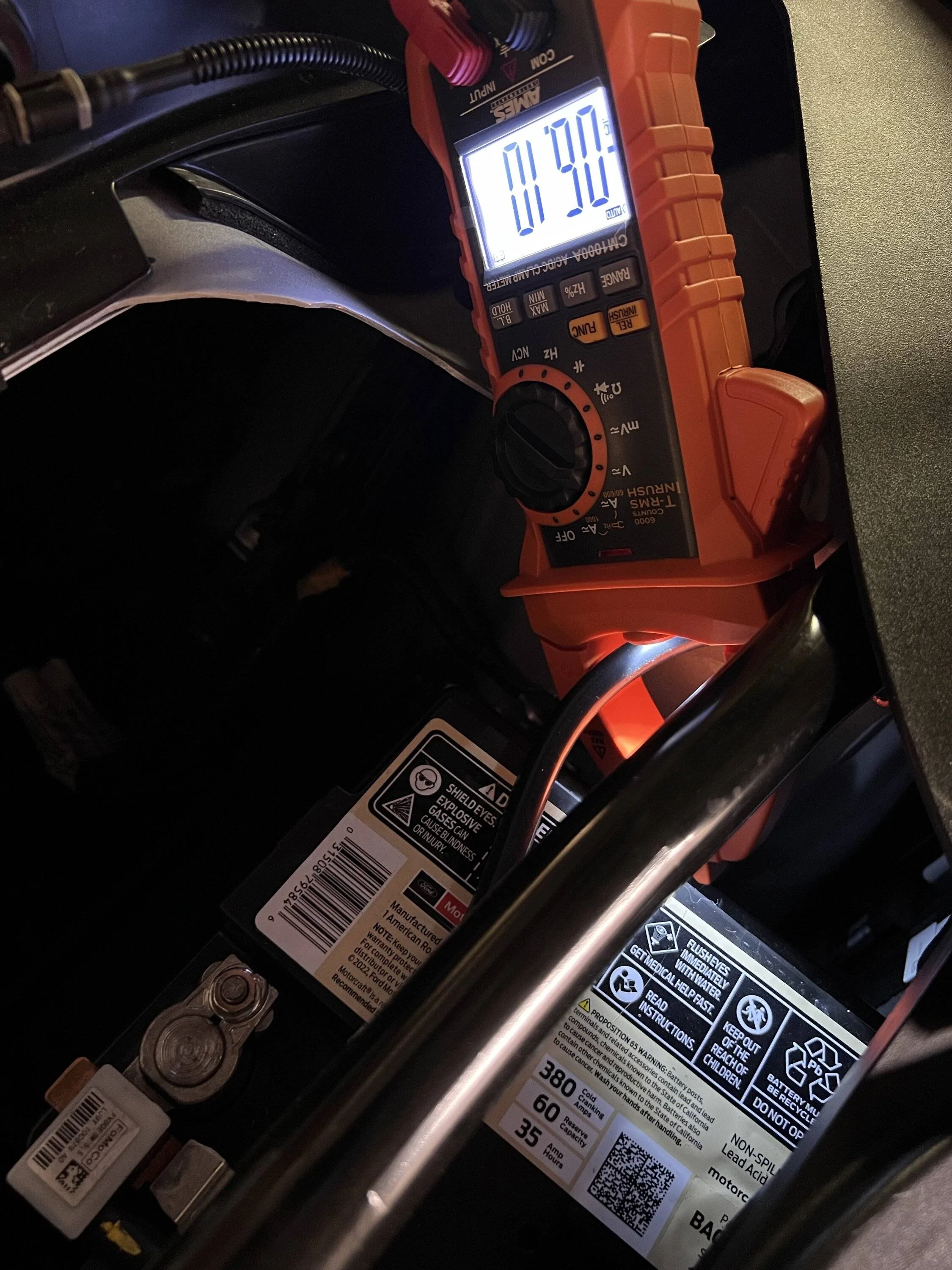

How much is the 12V battery drained each time the MME wakes up?
I went to the bottom of this because I suspected that repeated wake-ups events might be the reason why my Mach-e is destroying a 12V battery in just 6 months. The bottom line is that that indeed appears to be the main problem. I measured the true 12V battery current using a professional amp meter.

How was the 12V battery drain measured?
To avoid 'Heisenberg issues' I measured the actual current contactless using a DC clamp multimeter at the negative 12V battery lead. It is easy to do. I verified that the current matched the data from an OBDII dongle running CarScanner (the MME measures current at the positive lead). Here is the meter reading 6.1 amp while FordPass is connected using bluetooth but the car is still locked.
In addition to things going back to sleep slowly, 132 watts is quite a lot of power for something that shouldn't be doing anything mechanical. I suspect a lot of the modules that power up are carryovers from internal combustion vehicles. They probably use very old semiconductor processes and lack low power modes since a few watts here and there don't really matter on a traditional car with a much larger battery.
When does the car wake up?, and what does it do?
The MME wakes up when the keypad is touched, the lock button is pushed on the key fob or when it connects via bluetooth using PAAK. Rather than going to sleep quickly, the insomniac car stays awake for much longer than expected after that. I measure that it drains about 11 Amps (132 Watt) for 3 minutes and after that ~3 Amps (36 Watt) for another 15 minutes. No lights are on during that time. Then it finally goes back to sleep.
This means that each wake-up event uses ~1.25 Ah, or about 3.5% of the available energy in the 35Ah 12V battery. If the car starts out at a healthy 85% State-of-Charge and it is woken up 10 times without starting it, the battery would have drained down to 50%. AGM batteries should not be drained much lower.
Things are much worse with PAAK!
After wake-up and the initial 3-minutes of 11Amps heavy drain, I measure that the MME continuously drains ~6 Amps for as long as the phone is connected to the car via BlueTooth with the FordPass app. I left it on for 45 minutes but it did not go to sleep until I switched off the Bluetooth on my phone.
Why is this a problem?
The unnecessary drain adds significant wear to the tiny 12V battery. It will need to recharge each time, reducing range. I am on my 3rd battery already. The MME will automatically recharge the 12V battery whenever its SoC gets too low (probably 50%), so this will unlikely brick the car immediately. A weak battery, however, prevents OTA updates and results in nebulous warning messages.
When is it a problem?
The car wakes up each time the phone with PAAK gets within 30 feet. Since my garage is attached to the house, it is not unlikely that it wakes up many times when I wander through the house, take out trash or otherwise get anywhere within 30-40 feet. If I leave my phone at my desk, it is not unlikely that it will continuously connect to the car as that is ~30 feet from the car.
The regular key fob does not have this problem because that does not wake up the car until a button is pushed. PAAK - on the other hand - secretly wakes up the entire car without user action.
What would help?
Obviously, not using PAAK, or parking the car farther away to avoid accidentally waking up the MME. It appears that PAAK is poorly implemented. At the very least Ford could update the software to make the car go to sleep much quicker. There truly is no reason to keep the car awake for 15 minutes after each event. 2 minutes would more than be enough. And there is no reason to drain this much energy while being awake while locked. Note that the car also stays awake for 15 minutes each time after the car is locked.
I am still chasing a root cause of 12V battery drain. Just now it drained from 92% TO 72% overnight. That is a 20% drop: 84Wh lost from a small 35Ah battery. To be sure, I had unplugged my dashcam, though that does not seem to make any difference as the USB outlets are unpowered when the vehicle is off. On another occasion I measured 10% drop in 2.5 hours. That works out to a load of ~20watt (1.7A) continuous, in the ballpark of what I measured with the clamp multimeter at the battery terminal. This car has insomnia....
The constant discharging and recharge sneakily wears out the 12V battery. I get no messages about battery drain, so the car thinks this draw is from its normal operation. It is just that the 12V battery will die after 6-12 months. This is my 3rd one.
Plugging in the car only helps a little. It charges the 12V battery only while the main battery is charging. So after HVB charge is completed the 12V battery still discharges while plugged in.
Measured at the battery terminal, the drain goes up and down, so this does seem to be a software issue. The problem appears to be less when I switch off Bluetooth on my phone to silence PAAK. The car parked in the garage triggers some wake up events, but disabling PAAK does not fully avoid the problem. I wonder what else could cause this. Any ideas?
