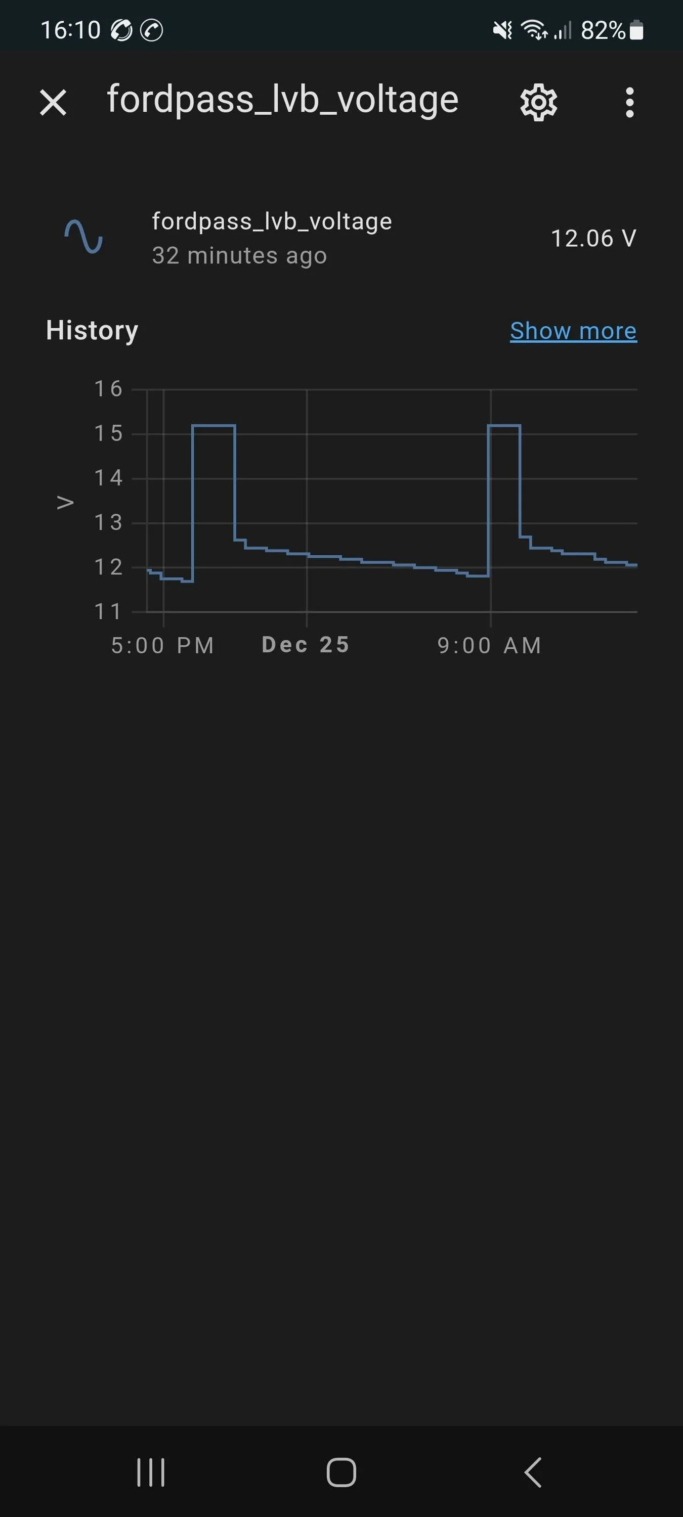

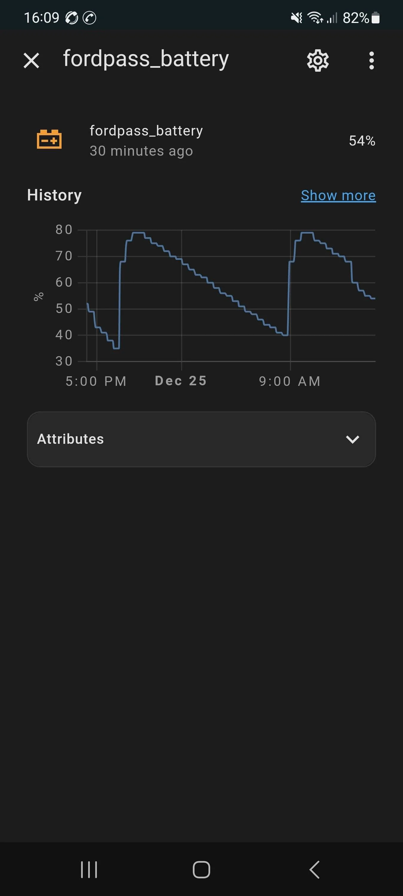

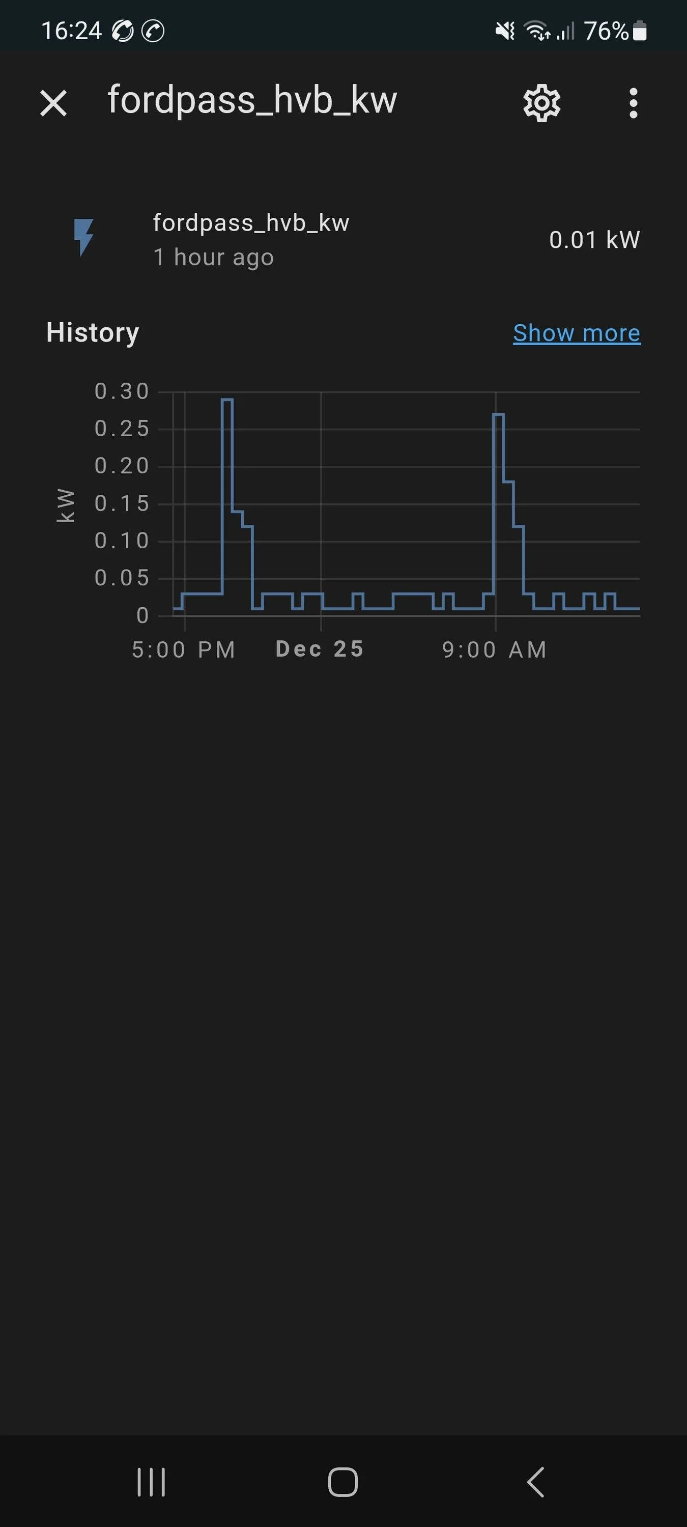

My car is not idling at all.. I have 24/7 dashcam with no shut off. I think the camera draws about .5A at all times. I am also polling data using fordpass 24/7 with 10 minutes interval.. but still I have not had any issues with 12V battery, now more than two years. I did drain it completely down to 8V because of a mistake during software updating (manually), but that has been the only time ever it got drained and it was my fault.
For me it seems strange if batteries are being consumed and destroyed, as it seems to be doing fine at charging it in the background when necessary.
I am attaching graphs from data pulled with fordpass api (home assistant) showing about a day of parked car with PAAK and camera running all time, not connected to charger. (Last one is power drawn from HVB as reported by fordpass, since it is point in time snapshot when data is sent to fordpass it is possible it shows more awake time than reality since it might be sleeping with 0 watts between the data points)
After watching it for a few days it seems to start load shedding and stops sending data to fordpass if it for some reason goes below 30%, but still will wakes up if a command is sent, so not deep sleep.

Two drain/discharge cycles a day, that battery isn’t going to last more than a year or two. Constant API polling + dashcam.

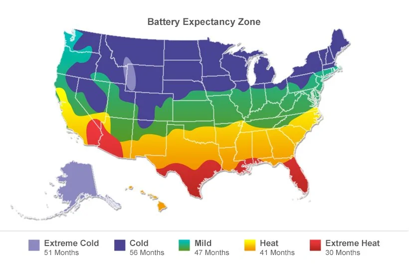

You said that heat has a negative impact on 12v battery life. I live in a hot part of Socal where summertime temps routinely reach over 100 degrees. And my MME is parked outside 24/7. Also, this is mainly my wife's car and she can sometimes go several days without driving the MME.
I am thinking of proactively replacing the 12v battery every 2 years. It seems like a relatively small expense for peace of mind.
Do you think replacing the 12v battery every two years makes sense or is it overkill and an unnecessary expense?

Yes, you’re in the every 2.5 years zone.

Every 2-6 years depending on your climate and usage level. Heat kills batteries, so the hotter the climate, the shorter it will last. If you live in the southern US, 2-4 years is typical. If you live in the northern US or Canada, 4-6 years is typical. It also depends on usage. FYI if you have a dashcam that drains the 12V battery, your battery will wear out approximately 2x faster than normal (it might only last a year or two with a dashcam).
