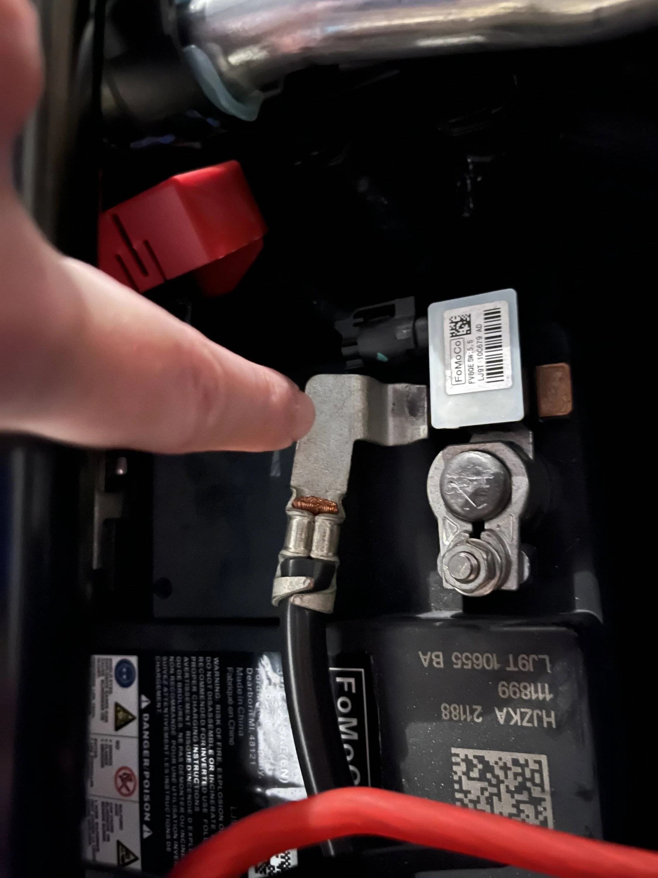

When you say "body ground" does that mean I can connect the negative to ANY metallic object on the body? Can I connect the NEG to, say, the metal body of a wiper blade or something similar?
I ask because I am one of those who drilled holes and put on removeable covers over the POS/NEG terminals (many posts on this) so I don't have to remove any of the frunk panels to get to them.
Yes, you can connect to any suitable metal object on the body/frame/chassis. You'll get a better connection if you use something that is bare metal and not painted. I would pick a bolt instead of a wiper arm. If you drilled holes in the cover, the negative jump post on the strut tower is fine (upper right corner of the picture). The one to avoid is on the battery itself.

Where do I connect a 12V battery charger?
Connect the charger to the jump start points under the hood, left side. See photo. You’ll need to remove the frunk covers first, see the battery location FAQ. IMPORTANT: DO NOT CONNECT THE BATTERY CHARGER TO THE NEGATIVE BATTERY TERMINAL. You must use a body ground, such as the negative jump post on the left side strut tower. See below FAQ for more information on why this is critical.
FYI the emergency leads in the front bumper are not connected to the 12V battery, thus you cannot charge the battery with them. They are for opening the frunk only.
Is there a wrong way to connect the battery charger?
YES! YOU MUST USE A BODY GROUND! DO NOT CONNECT ANYTHING TO THE NEGATIVE BATTERY TERMINAL! A body ground is anywhere on the body besides the negative battery terminal. You can use the negative jump post on the strut tower. Why is this critical? If you connect a charger or power supply to the negative battery terminal, you will bypass the battery current sensor, and the BMS will think the battery is discharging (SoC % will go down) instead of charging since the current is flowing through the sensor in the wrong direction. The BMS thinks the battery is going dead (even though it’s charging) and will activate load shed modes by shutting down modules and features, causing extremely odd vehicle behavior. You will think your car is possessed.
I cannot stress how important it is to connect the charger to body ground properly because it will wreak havoc with the vehicle’s systems if you do it wrong.

This part with the “don’t charge the battery by connecting to the battery,” is just weird.
Is this buried somewhere in a service manual? Did this come from trial an error? Or is this just poor design?
Before reading this of course I have charged a few times connecting to the battery (the flat posts on the wires leading to battery) and it seemed to charge fine, but won’t do that anymore.
Pretty much everything about the 12v in this car seems poorly designed. Which sucks because the car relies on it so much.
I just looked again and I connected the negative where I’m pointing in this picture. This wire runs directly to the strut tower. So would this be ok?

My negative battery connection definitely looks different than your picture. Could be the angle. But either way seems like connecting on one end of the cable vs the other shouldn’t matter.
