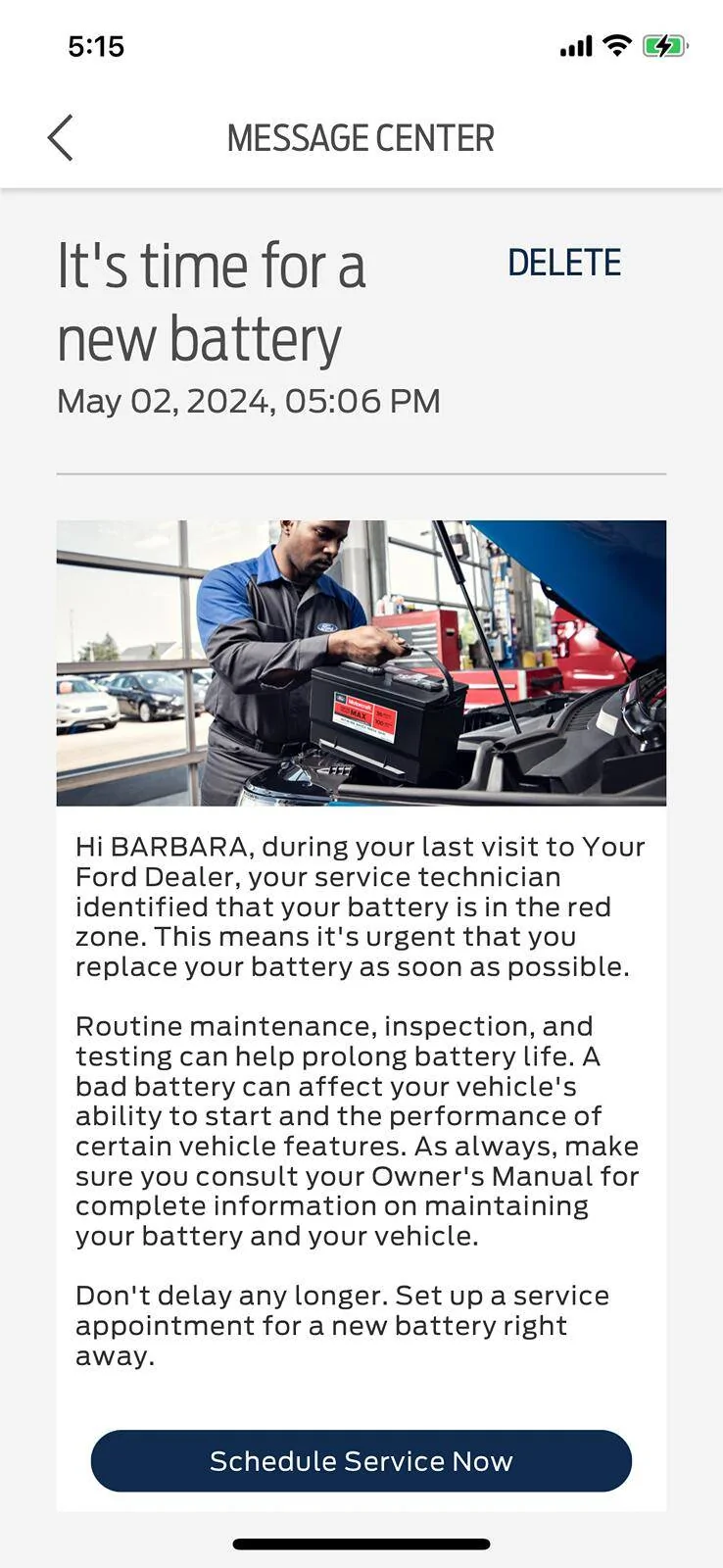

Got this message in my FordPass today. Car was at dealer 3 months ago. So why do I get this now?? Car is 2 years old. Have I been in red for 3 months??
You better rush right out and take care of this. It is an emergency. ?
It is strange your dealer didn't say something if they determined your battery was going bad. Did you call them to ask about it?
Just saw it on ford pass going on a short trip up coast to cape Kennedy Sunday. I was hoping a fluke. I saw somewhere to charge HVB slow Should I plug in my L1 charger or use L2 up to 100%. Hotel has a bunch of l2 so will be charging every night. I don’t think critical. Have time to use L1 if it’s better for the 12v.
And no didn’t call dealer as they are closed now.
Your 12V battery was fine a month ago during the last OTA. I don't see a reason to replace it yet.
