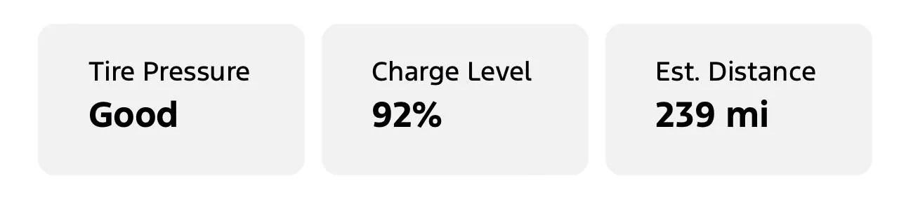

The many times I’ve logged into my Ford account on the website not the FordPass, I thought that battery percentage was for the low level battery 12 V. But now when I look at FordPass and I look at the webpage, it’s the same level as the high voltage battery with the same estimated miles.
Nope, still reading 12V SoC for me. Probably just a coincidence they’re the same. Drive the car and check it again.
Every few months somebody posts that they think Ford changed it, but so far everyone has been wrong and weren’t understanding or testing it thoroughly. Please don’t post just because you see the percentages match one time. Only post after you’ve seen a consistent pattern over many days and drives. There is a decent statical chance the battery SoCs can actually match especially in the 80-90% region where they spend most of their time.

Like Lee was saying it just might be a coincidence but no I have seen the LVB at 98 on mine. I’ve seen it down as low as 78 sat at the dealer one time so I’ll drive it next time and see what the two percentages are two different website and FordPass app .

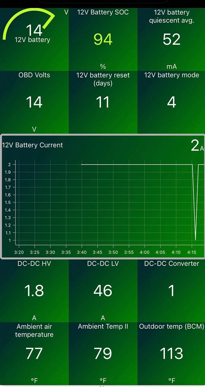

I usually use a OBDII scanner to keep tabs on mine. I don’t know how often the ford.com website updates its data (or how often the car calls home to report the stat.)
I was in the car earlier. Here’s a shot of my Car Scanner.

You were right it must’ve been a coincidence, today It shows 81% on the HVB and on the ford.com webpage it shows 89 for the 12 V.

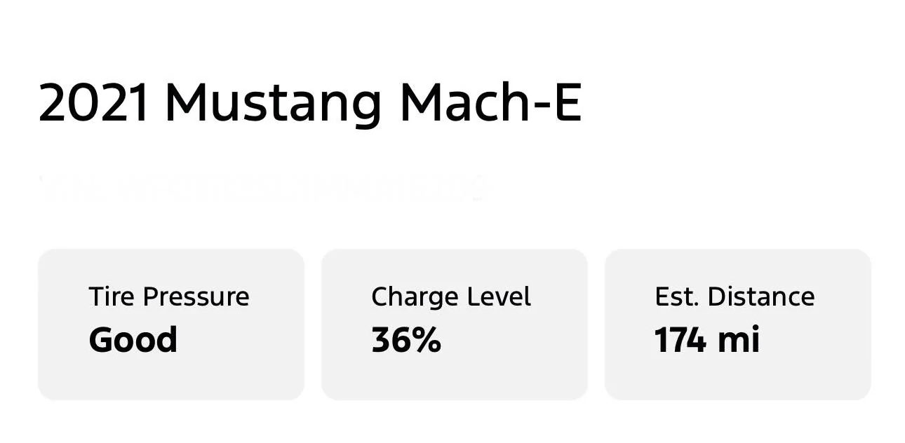

Hello LVB Pros,
i’ve been having some problems with my LBV and not being able to reach 100% an AGM
external charger only 98-99%. Because of that, it wouldn’t ever switch to maintenance mode, instead it would just switch off. Same with using the NoCo charger. after turning green light, It’d be 89%-92%. All times dropping quickly after disconnecting.
I recently had some door module replaced and My camera system module and front camera under warranty. When new door module was being programmed by FDRS another door module blew and had to be replaced. I had the battery checked at the same time and it was good. (pic) But shortly after I got it back, I started noticing big drops from the Ford dashboard reading going from 85% down to 55% the next day, sometimes after two days into deep sleep mode 36% (pic) less than 24hrs. I have the charging holes in the front panels, so when home II hooked up an AGM charger to bring it up to hundred percent. Behold, the same depleting continues.
I brought it into another dealer last week for my one year convenience check (renews Ford Assit) and my first MOT. I asked tech to check the battery which they said they had run it on up to 3 hour evaluation..
My 12v battery. was replaced. now it seems the new battery is doing the same thing. They’ve had it in the shop a week now because the drop continues. last night I saw it on 87% this morning it was 55%.
There’s no dash cam or anything hooked up to it. . The HVB kicks in to bring it up to 87% at some point.
Any thoughts what could be causing that battery drain when car is just sitting?
Please see this topic for ideas on what causes 12V drains: Thread 'Troubleshooting "Electrical System Drain Service Required" Message' Complete the checklist.
A 10% drain in the 2 hours after ignition off is normal. <4% per day drain after that if the car isn't disturbed. Note: waking the car up to check 12V status takes 2% each time.
Recommend you update the PCM and BCM software which should increase the 12V recharge threshold from 35% to 45%.
FYI NOCO chargers suffer from early charge termination, I do not recommend them. If you want to reach 100% SoC you will need a 13.6V power supply that outputs constant voltage.
