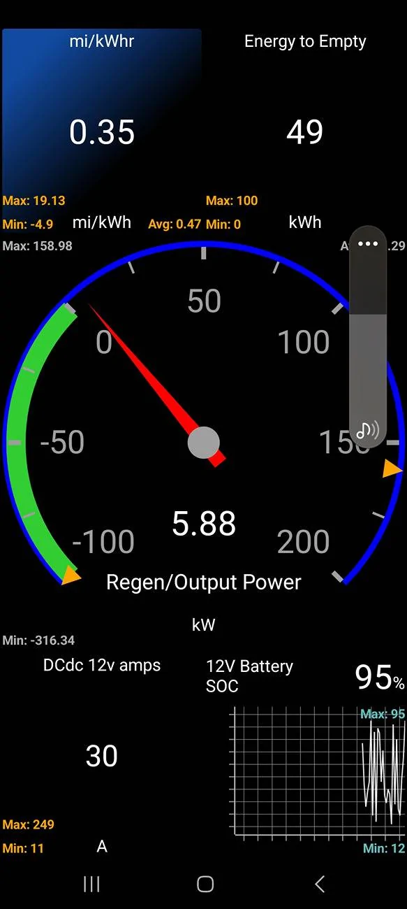

you can check LV%, and LOTS of other stuff if you get a $30 ODB2 reader and free CarScanner app
Ive considered that before, maybe I’ll go ahead and do that, thanks.

@Mach-Lee thank you for this most excellent write-up. I cannot believe I am only seeing it now, but I appreciate the time and effort you took to put write down all of this information. If I may pick everyone's collective brain... is there any issue leaving the OBDII reader plugged in or should I remove it? Second, using a Carista OBDII and a Car Scanner app, my SOC for the LVB is 71% when I turned it on today and the wifey had not driven it since Sunday or Monday. I bought the MME in July of 2021 and it has about 22k miles on it. It has been garage-kept for all of its life although it had been in the sun periodically whether at work or driving around. When do I know it is time to change the battery? A most recent update did not complete although I don't know the reason. With my other vehicles, it wasn't as big a deal if the battery were to fail because it was easy enough to open the doors and hood to jump the battery. Lastly, when is the best time to check the battery's state of health? I also have a little voltmeter in the cigarette lighter power outlet in the armrest and it shuts off automatically, but it has been reading between 12 - 14 every time I check. TIA.
